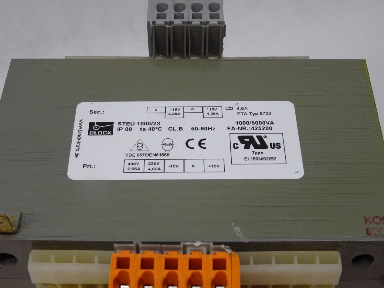

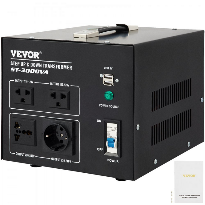

a pity about auto transformers, because there are plenty of them for sale, and they're high-powered.
I'll turn to this:
is it insulated?
moreover, i found in my garage two insulated 400/240 - 110V transformers with a power of 1000VA with two 110V 2x4.26A outputs and can up to 5000VA for short time
so I'll go with
transformer 1000 VA : - motor 0.57 kw 1.6A 143V
- motor 0.57 KW 1.6A 143V
transformer 1000 VA: -motor 0.57 KW 1.6A 143V
-motor 1.5 KW 3.7A 146V
transformer 3000 VA :- motor 2.5KW 5.4A 185V
-motor 2.5KW 5.4A 185V
does this sound right or is the 3KVA transformer too small?
I'll turn to this:
is it insulated?
so I'll go with

Vevor no, but maybe, usually not isolated.
The 1000VA looks good, has outputs that can be paralleled giving 8.7A and can handle quite some beating, so get 1 of those, it will be more than enough for testing and running individual motors. After you do that, you can try using 2 or more motors with it and see how it behaves, you might just get away with 2 or 3 of those if no fast acceleration is needed.

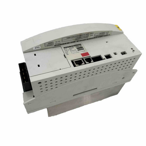

Kuka does not makes drives, Siemens does/did, although that looks like something Beckhoff would make, so try finding more info on them. Also notice Kuka used fieldbus and profibus for comms...
