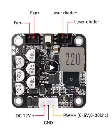

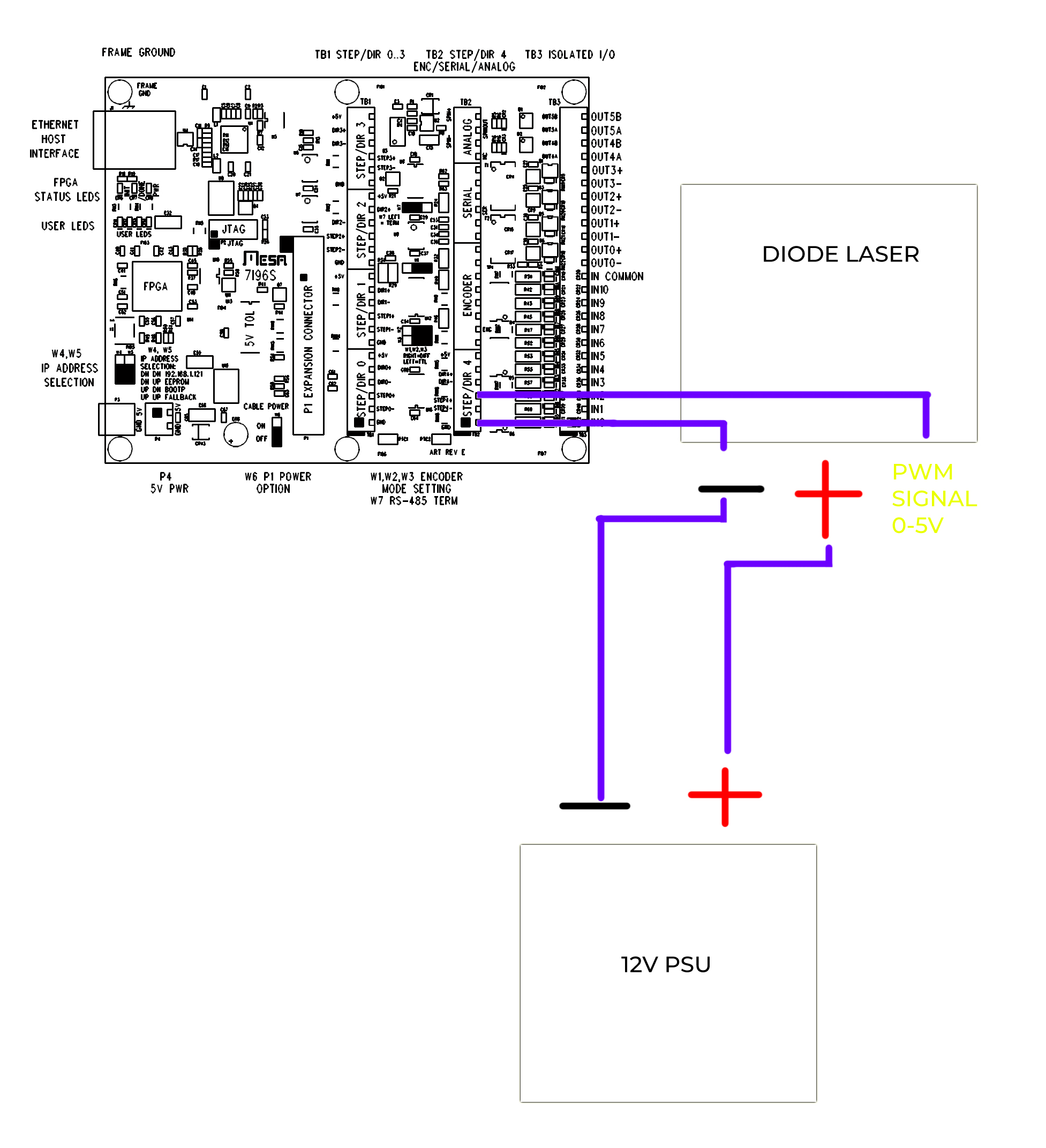

So finally on my holiday break and looking to try and connect my 40w Diode laser to my machine
want to get some guidance before i flash my 7i96s and cause my whole CNC to stop working.
would like to be able to use the spindle control, whether that is scalled or as a percentage to adjust the 0-5v for the intensity of the laser
so i understand that i have to flash the board with 7i96s_2pwmd.zip, which will add PWMGen 1 to STEP4+/STEP4-
Is how i have the diagram, would this be the correct way i need to wire to the board?
also is this the correct coding i need to add into my hal/ini file?

That looks close if the laser driver uses PWM and not 0 to 5V analog
Notes:
The STEP+ pin will start up in the high state so for safety you should use the STEP- pin
and invert the PWM output in the hal file. I would change the hal setup to:
# invert pwm output
setp hm2_7i96s.0.pwmgen.01.out0.invert_output true
# Set the PWM frequency (adjust based on laser specs)
setp hm2_7i96s.0.pwmgen.01.scale 5000 # Example: Scale to 5000 RPM for 0-5V lasers
# Link PWM output to motion spindle speed command
net laser-power motion.spindle-speed-out => hm2_7i96s.0.pwmgen.01.value
# Link PWM enable to motion spindle enable
net laser-enable motion.spindle-on => hm2_7i96s.0.pwmgen.01.enable
# Link motion spindle-on signal to a 7I96S SSR output pin
net laser-enable hm2_7i96s.0.ssr.00.out-00
(PWM channel 0 is for the analog spindle out on TB2 pins 22..24)

1 year 10 months ago #317248
Replied by PCW on topic 7i96s Flash for additional PWM and Wiring for laser
I would not permanently enable the pwmgen with setp but rather enable it by
connecting it to spindle-on as shown.
Inverting the PWM output and using the STEP- pin is needed because it guarantees that the
PWM pin is low before LinuxCNC is running, during power up, and after a fault (watchdog bite)
