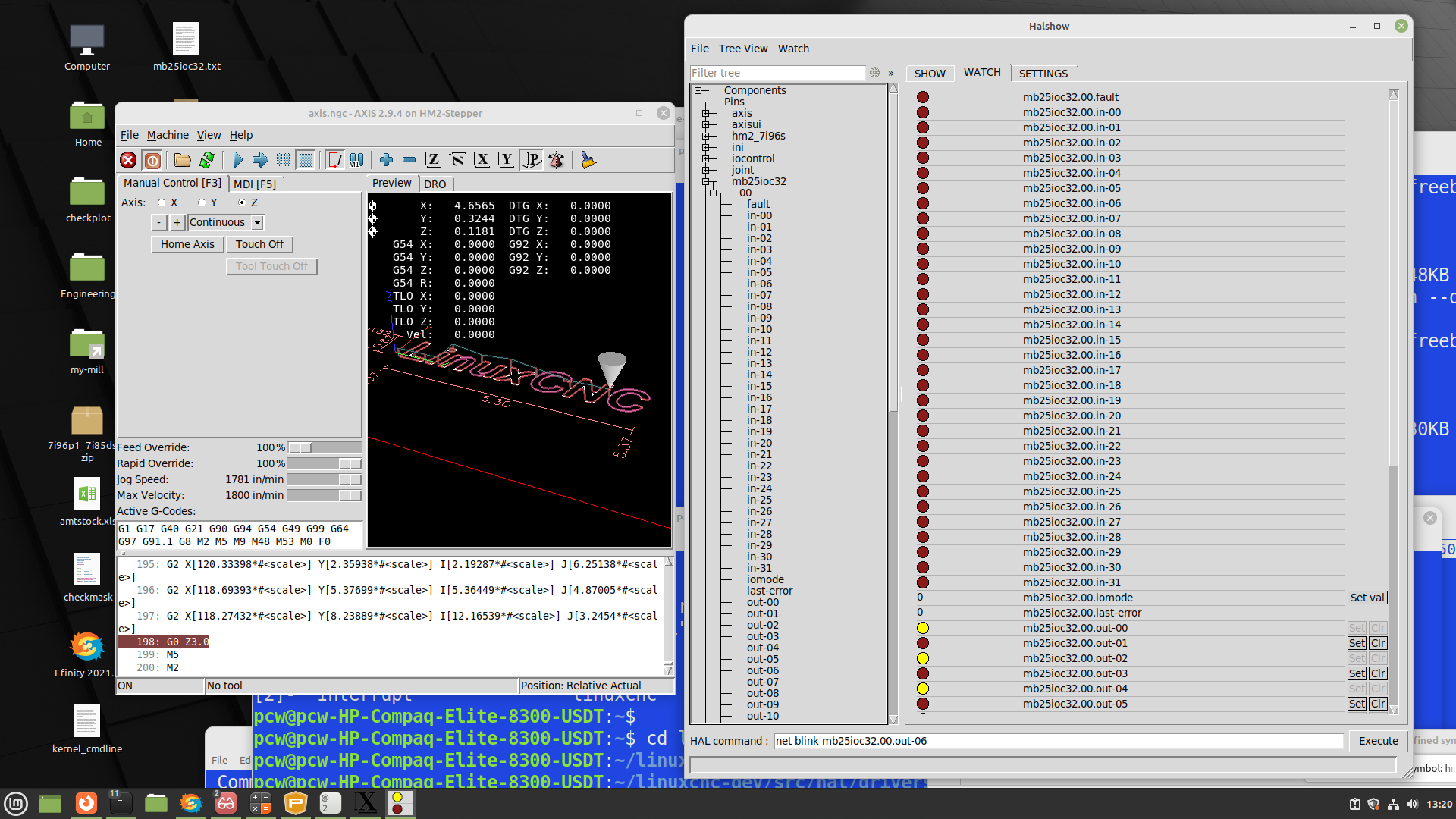

- Corne
- Posts: 17
15 Feb 2025 07:04 #321617
by Corne
Replied by Corne on topic Error: undefined symbol: hm2_pktuart_setup_rx - while lading custom modbus.so
Copied the mb25ioc32.so to the modules directory > same result as mentioned in my initial post.
A search to *pktuart* doesn't give any hit. So I don't know where to place these.
A compile of mb25ioc32.so delivers a mesa_modbus.o (and .c) in a tmp directory. I can find the source of this file at /usr/share/linuxcnc/ as mesa_modbus.o.tmpl.
