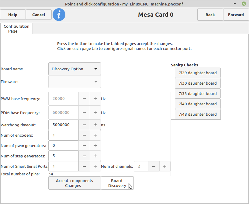

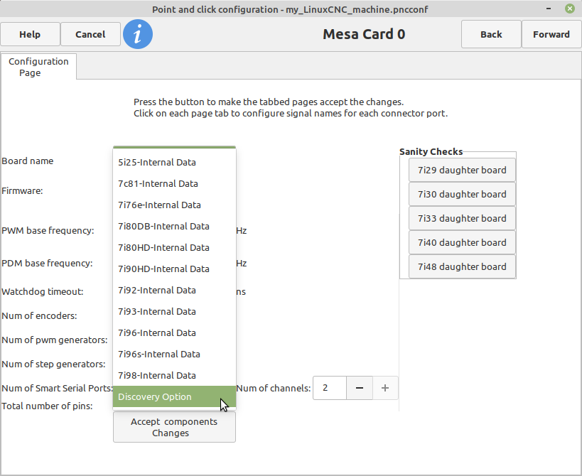

Thanks for the reply PCW. I was going through pncconfs and I couldn't find anything like discovery(Im new to LinuxCNC). While going through pncconfs I was a little confused because I flashed the 7i96s_5abobd.bin file but I couldn't find this as an option in pncconf as you can see in the image below. Anyways, I tried all three of the options that were there and none of them gave me the option of adding the BoB. Thank you for your help

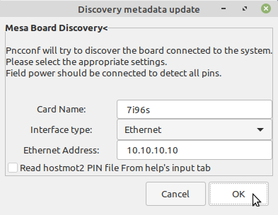

What version of LinuxCNC do you have?
I was testing with the current release (2.9.4)
I also noticed that you need to check the "Show Advanced Option Pages"
checkbox on the pncconf start page

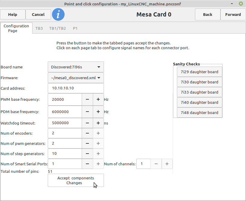

It worked. You were correct, I had to select the "Show Advanced Option Pages" for the discovery option to come up, and now I have all the steppers working. Thank you so much. I feel both relieved and a massive sense of achievement. Thanks for all the help and spoon-feeding me on how to do this.
