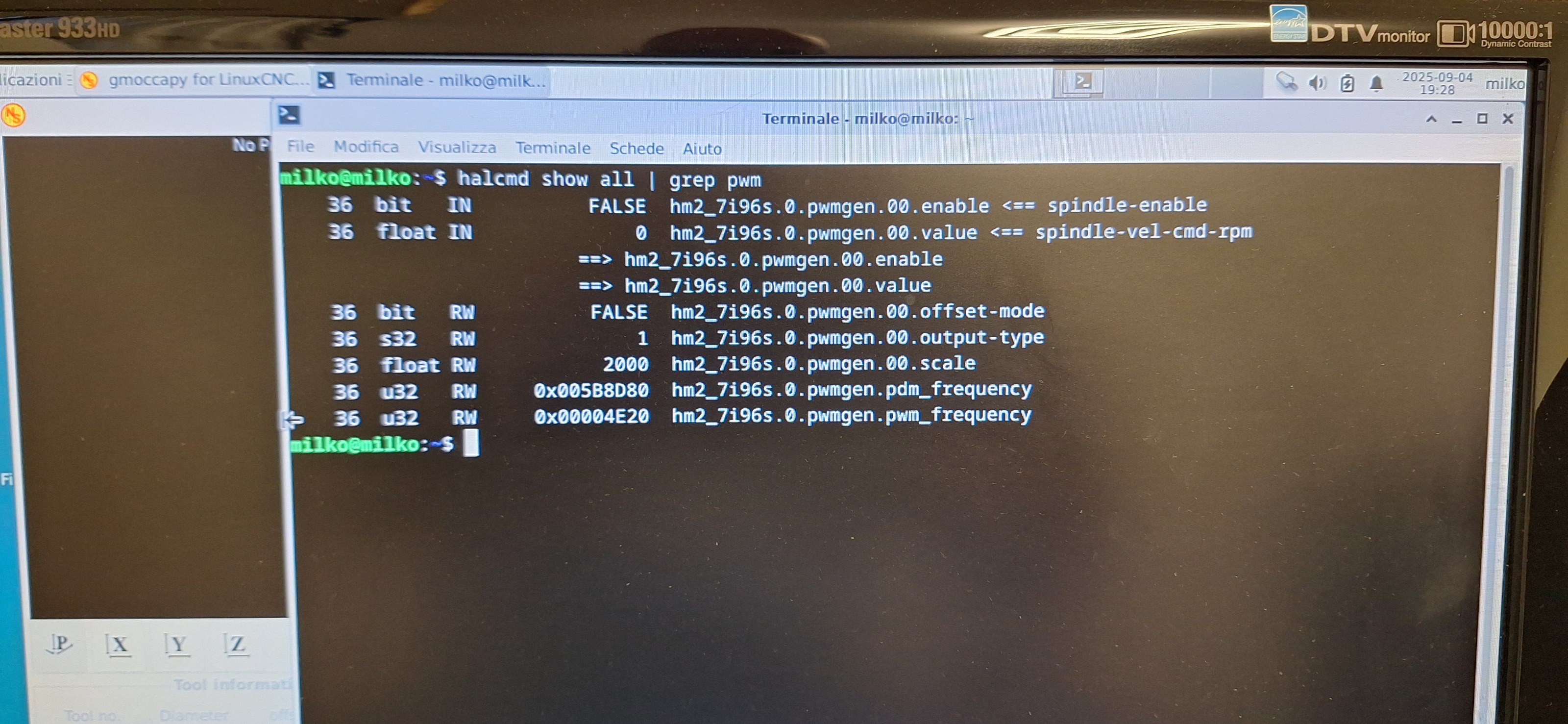

Replied by PCW on topic Connecting my 7i96s to the VFD
With Linuxcnc running and a S1000M3 MDI command executed,
what does:
halcmd show all | grep pwm
report?
(halcmd typed in a terminal window)
what does:
report?

Thats with the spindle off

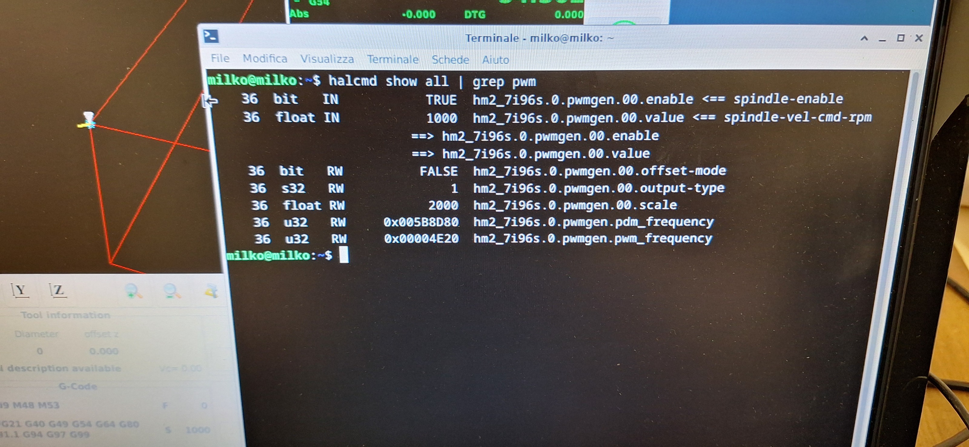

What I wanted wanted spindle on at 1/2 speed:
s1000m3
and then the voltage measured
s1000m3

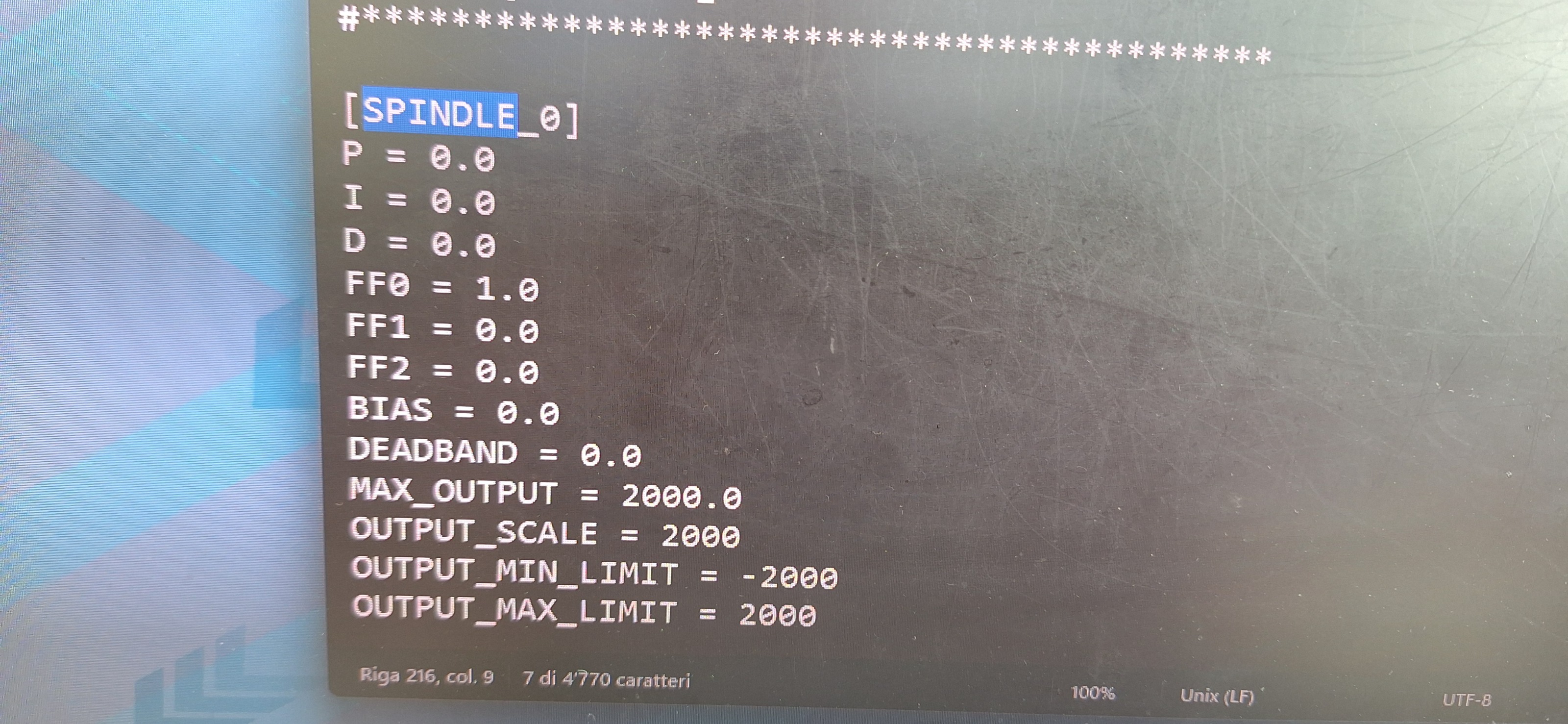

If 24000 RPM is the maximum spindle RPM at 10V, then in the .ini file:
[SPINDLE_0]
P = 0.0
I = 0.0
D = 0.0
FF0 = 1.0
FF1 = 0.0
FF2 = 0.0
BIAS = 0.0
DEADBAND = 0.0
MAX_OUTPUT = 24000.0
OUTPUT_SCALE = 24000
OUTPUT_MIN_LIMIT = -24000
OUTPUT_MAX_LIMIT = 24000
Do you have a link to the VFD manual?

I looked for a way to reset the VFD at the link below, but I couldn't find it. Thank you so much for your help.

I would look carefully at page 20 especially the settings for P07.08

I set the parameter to 3.
I'm starting to suspect that if I set values above S2000, the VFD was running at maximum.
Tomorrow I'll make the corrections to the INI file and try.
Thanks and have a good evening.
Milko

Yes if the PWM scale is set for 2000, any PWM value greater than or equal to
2000 would result in a 10V output
