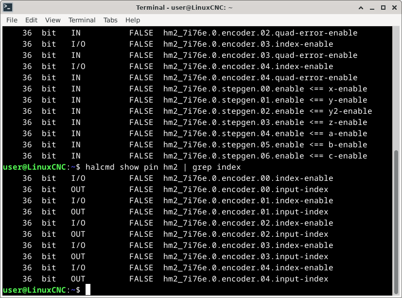

25 Aug 2025 02:49 #333878
by jschulze
Replied by jschulze on topic Looking for Stepgen Index Homing Firmware for Mesa 7i76eu & 7i85S
Loaded up the firmware, but I'm not seeing the stepgen index-enable pins. I looked in hal configuration and halcmd show pin in the terminal but I couldn't find them. Would it make it easier if I picked up another 7i85S so I could have an encoder for each stepgen? Thanks again for your help.

25 Aug 2025 03:21 - 25 Aug 2025 03:34 #333881
Replied by PCW on topic Looking for Stepgen Index Homing Firmware for Mesa 7i76eu & 7i85S
Sorry, I got the stepgen version wrong, will retry.
Try this:
Try this:
Last edit: 25 Aug 2025 03:34 by PCW.

25 Aug 2025 03:56 #333882
by jschulze
It worked! I don't have much time right now to play with it, but I was able to manually turn on the stepgen index-enable and it turned off and zeroed the stepgen count with the index signal. Thanks so much for your help with this, it's very much appreciated.
