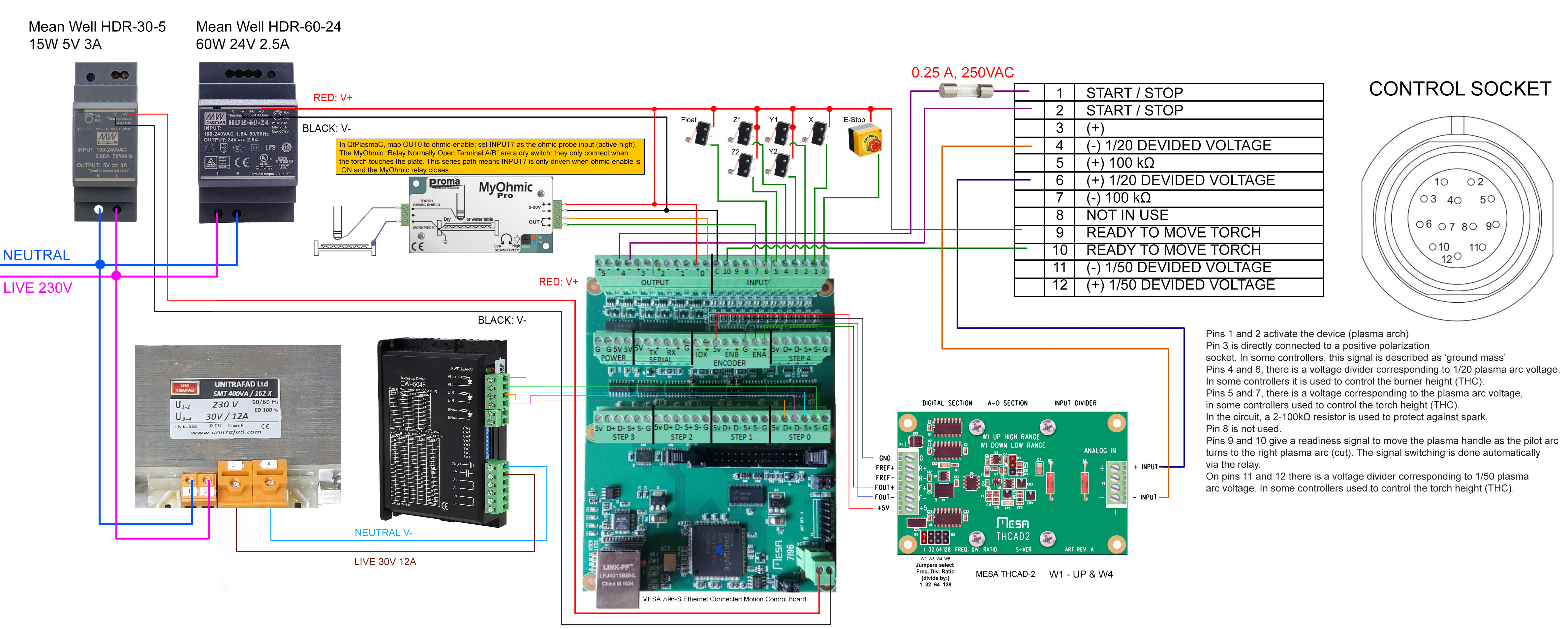

Hi all and thank you for checking this topic!
Little intro to my project and why I cam here.
I'm here asking for help with upgrading my table. I've bought a CNC plasma cutting table with the hope of starting my own thing and because it looked like a lot of fun. Couple of months down the road it turned out that the table is more on the hobbyist side than I would like. So I decided to start upgrading it in order to have higher quality cuts that I can be proud of.
My current setup.
PLASMA SOURCE
CONTROL
CONTROL AND SOFTWARE
My plan.
The diagram.
I've reused a diagram from the forum (I believe that it's LOWRIDER3) which turns out to be immense help, I'm not sure I would be able to come up with anything useful if it wasn't for it!
I'm adding the diagram itself so that you good folks can make comments, recommendations, critiques. Thank you all in advance!

My plan.
- Move to LinuxCNC with QtPlasmaC.
- Move to Mesa 7i96S: Ethernet motion interface
- Move to Mesa THCAD-2: for 1:20 arc-voltage THC input
- Move to MyOhmic PRO
- Install limit switches
- Use 18 AWG (0.75mm2) shielded cables for the up to 24V connections
- Use 16 AWG (1.5mm2) shielded cables for the connections that are more than 24v
The diagram.

It looks like you have most of it sorted out, but feel free to ask any questions if you get stuck.
Depending on what the mystery control board is, it might be compatible with Remora firmware.

I thought the THCAD can do the job of the Promo Ohmic sensing system?
Or perhaps one need an additional THCAD arc-voltage reader.
Plasma-guys, you know this.

Looks great. I will be interested in how you go with the My Ohmic Pro. I was sent an evaluation one and its beautifully engineered. I just had nothing to try it out on. The THCAD for Ohmic struggles on Water tables so hopefully it proves a more robust solution. Lukaz at Proma said he was very proud of the water handling of the My Ohmic Pro
Be sure to add an EMI filter on your mains input to avoid electrical noise. You can get them built into an IEC connector. even with a power switch and fuse built in.

If using a THCAD for ohmic sensing has issues with water. the most likely issue
is that the sense resistor is too high a value.

I agree and I am pretty sure i mentioned somewhere a long time ago that a lower value resistor should be used for sensing. Something that will result in 20-50mA current should do just fine, maybe more as the water used will get lower resistance the more cuts are done and as it evaporates.If using a THCAD for ohmic sensing has issues with water. the most likely issue
