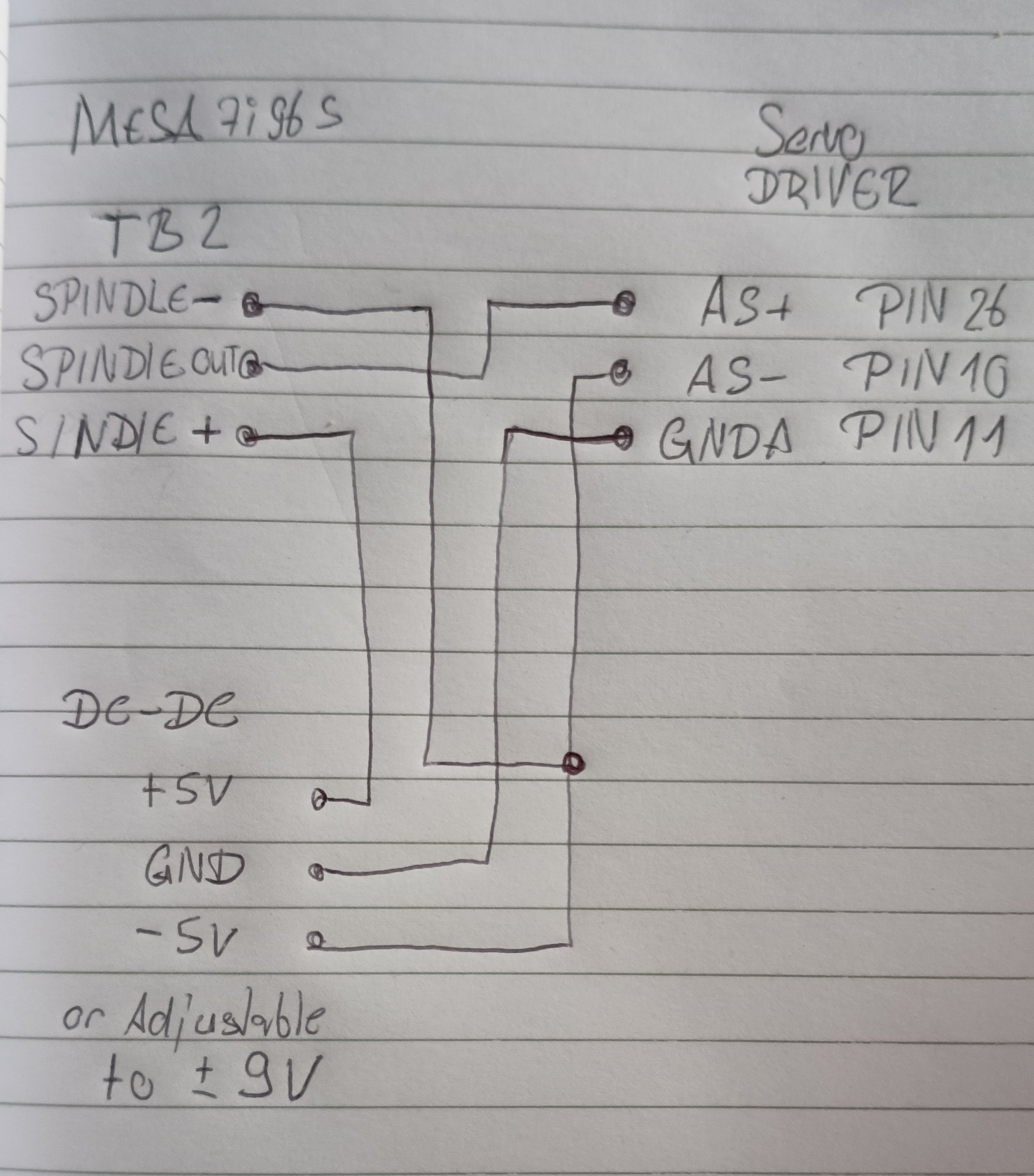

How can I connect an analog servo controller to the Mesa 7i96s?
DA+ to TB2-24
DA- to TB2-22
GA GND to TB2-23
I want to control the direction of rotation via + and -. Therefore, I only need S (spindle) ON connected to, for example, TB3-16.
The Mesa only outputs 5V, so do I need to adjust the parameters in the servo controller?One more question about the 7i73 board. How do I activate Mode 3 for the analog inputs for potentiometers?
DA+ to TB2-24
DA- to TB2-22
GA GND to TB2-23

11 months 2 weeks ago #338465
Replied by PCW on topic 7i96 with analog Spindle Servo
The 7I96S analog output is designed for unipolar use and will not work
wired directly to the drives analog inputs. It's possible to do this but requires
external +- power supplies.
Since the drive has step/dir inputs, I would use those instead

Does this diagram apply to a bipolar connection?
www.aliexpress.com/p/tesla-landing/index...aXGaNZQaAvhREALw_wcB

11 months 2 weeks ago #338513
I think that should work with a couple conditions:
1. You must have a digital spindle enable signal because the spindle output will default to -5V
when LinuxCNC is not running or after a watchdog fault
2. You need to set the PWMgens offset mode "true" so that a 0 PWM value results in
a 50% duty cycle and therefore a 0V output

11 months 2 weeks ago #338528
by gravedigger
Replied by gravedigger on topic 7i96 with analog Spindle Servo
Thanks.
The circuit diagram is OK?
I'm using Output 5 for Spindle ON and a contactor with the emergency stop button circuit.
