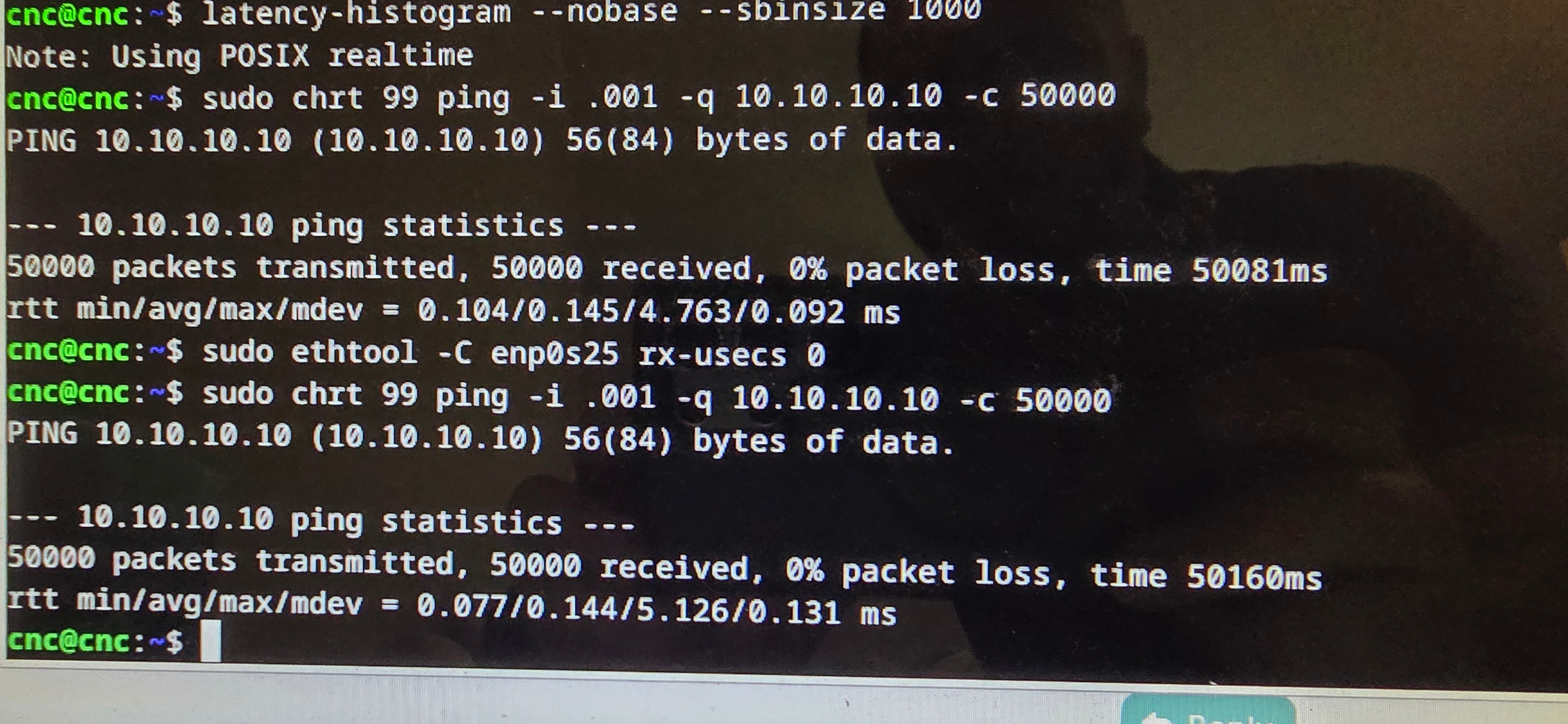

23 Nov 2025 13:18 #339050
by Sekai
Replied by Sekai on topic Chinese Mesa 7I92 from aliexpress NEW
you mean :
sudo ethtool -C enp0s25 rx-usecs 0
I did that, it does not change anything.

23 Nov 2025 15:45 #339056
Replied by PCW on topic Chinese Mesa 7I92 from aliexpress NEW
Changing the IRQ coalesce settings does improve the ping times noticeably on Intel hardware,
but your 4-5 ms peak ping time indicates other issues, likely related to power management.
My system with Intel MAC and default IRQ coalesce settings:
PING 10.10.10.10 (10.10.10.10) 56(84) bytes of data.
64 bytes from 10.10.10.10: icmp_seq=1 ttl=64 time=0.316 ms
64 bytes from 10.10.10.10: icmp_seq=2 ttl=64 time=0.250 ms
64 bytes from 10.10.10.10: icmp_seq=3 ttl=64 time=0.251 ms
64 bytes from 10.10.10.10: icmp_seq=4 ttl=64 time=0.250 ms
Same system with IRQ coalecing off:
64 bytes from 10.10.10.10: icmp_seq=1 ttl=64 time=0.116 ms
64 bytes from 10.10.10.10: icmp_seq=2 ttl=64 time=0.106 ms
64 bytes from 10.10.10.10: icmp_seq=3 ttl=64 time=0.107 ms
64 bytes from 10.10.10.10: icmp_seq=4 ttl=64 time=0.106 ms
Have you disabled all power management in the system BIOS and grub?
Have you set isolcpus to the last CPU in the grub file?
Do you have idle=poll in the grub file as well?
(These are basic latency reducing steps for any LinuxCNC host)
linuxcnc.org/docs/html/install/latency-test.html

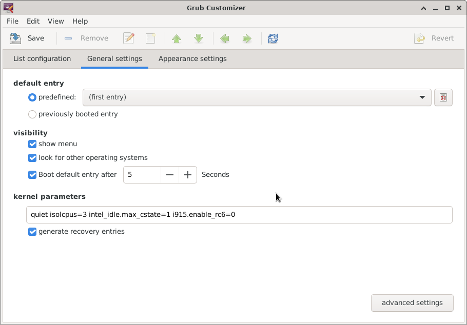

- Sekai
- Posts: 34
24 Nov 2025 05:44 - 24 Nov 2025 18:14 #339117
by Sekai
This is mini pc fujistu Q920
i disable about everything in the bios.
Still nothing
This is my current boot parameters with grub.Edit: I put linuxcnc on miniatx motherboard with intel i5 4460 and realtek RTL8168 ethernet.
Still nothing
sudo chrt 99 ping -i .001 -q 10.10.10.10 -c 60000
--- 10.10.10.10 ping statistics ---
60000 packets transmitted, 60000 received, 0% packet loss, time 60239ms
rtt min/avg/max/mdev = 0.101/0.251/5.325/0.141 ms

- Posts: 18105
- Thank you received: 5328
24 Nov 2025 22:23 #339174
On the Fujitsu also make sure that if it has the AMT feature
(common in corporate desktops), that it is disabled.
Also disable EEE and any PCIE power saving in grub.

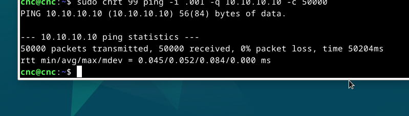

- Sekai
- Posts: 34
25 Nov 2025 15:20 - 25 Nov 2025 15:21 #339211
by Sekai
Last edit: 25 Nov 2025 15:21 by Sekai.
