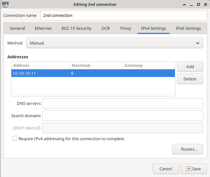

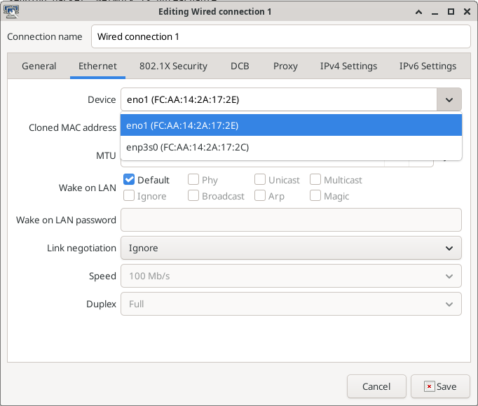

Going by your most recent answer I interpret the above:
It appears to me you have two network configurations "Web" and "Mesa 7i76e" In both configurations you appear to have the first network port selected. This means, when you click on the "Mesa 7i76e" network, the pc tries to connect to the Mesa card via the network port that is connected to your LAN.
To fix, right-click on the network icon, click "edit connections", click on "Mesa 7i76e", click on the little gear at bottom "edit the selected connection", click on the "Device" dropdown, and select the correct device, click on "IPv4 Settings" tab, make sure the "Gateway" field is empty. click "Save", close the network edit window, and try reconnecting to both networks. On my system, I have both networks connected at the same time.
