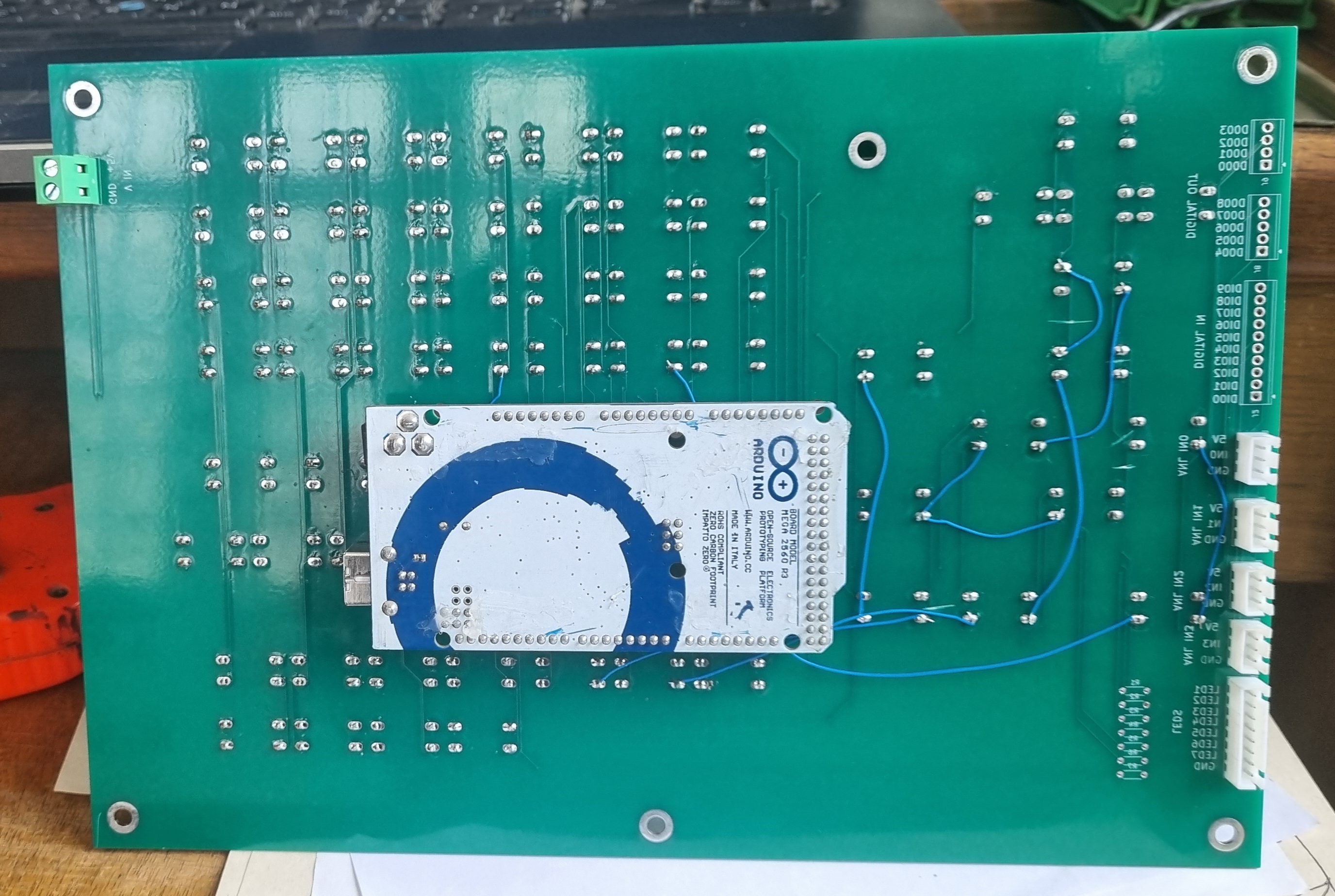

28 Jan 2026 16:59 #342086 by COFHAL
I try this bot with the command ls -l /dev/io_decoder show this error
ls: cannot access '/dev/io_decoder': No such file or directory
28 Jan 2026 20:03 #342095 by bobwolf
Go to the "Create a udev Rule" section described in bobwolfrst.github.io/io_decoder-linuxCNC/demo_mode.en
or insert the following in the line that calls the component in the .hal file describing your machine: loadrt io_decoder firmware=255 usb_port_name="[the port address obtained with lsusb]"

29 Jan 2026 00:32 #342112 by COFHAL
Thanks, I had an error in the rules file, that's why that error appeared.

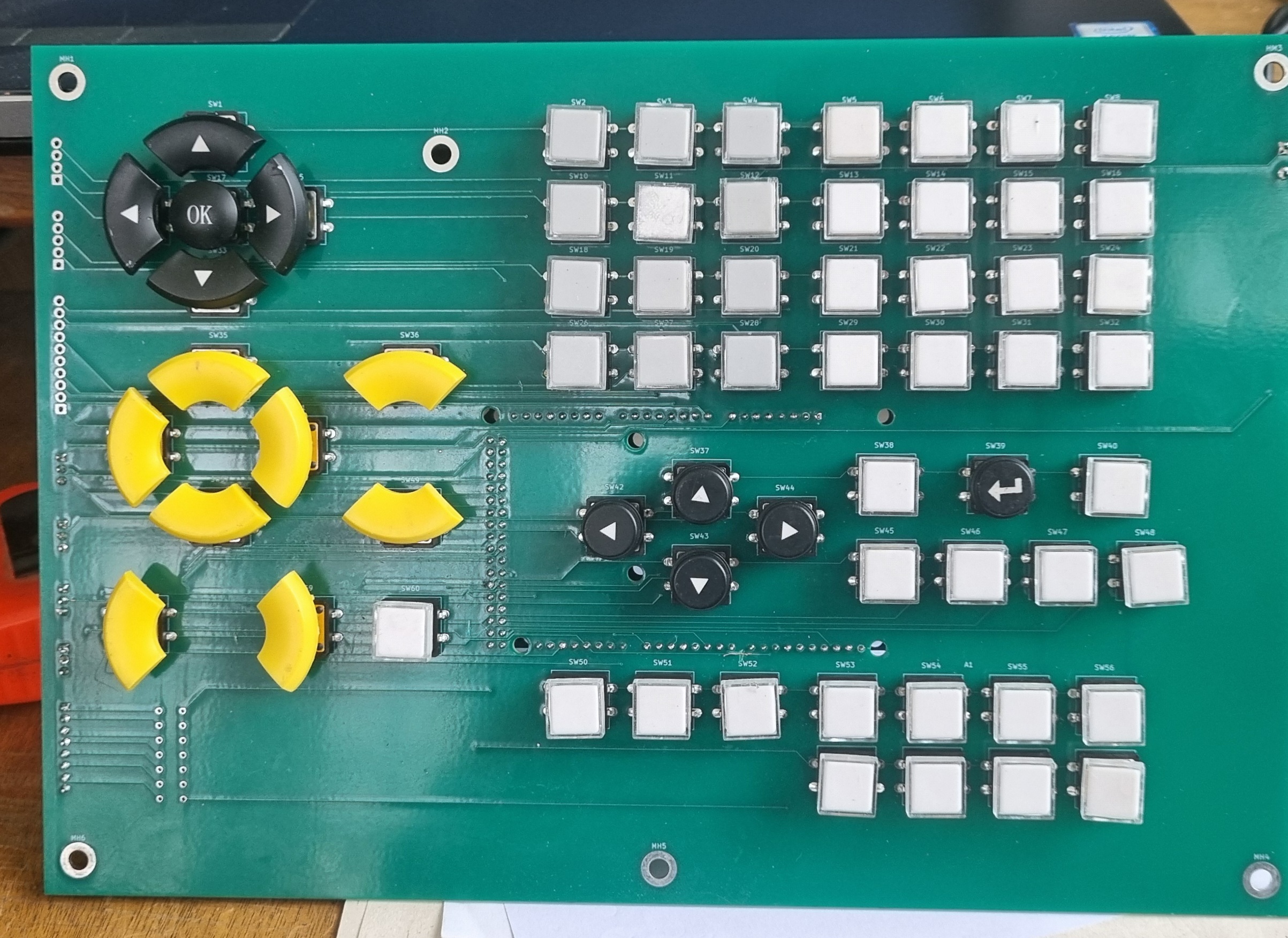

29 Jan 2026 00:38 - 29 Jan 2026 00:40 #342113 by COFHAL
I use Arduino Connector, I really like your project, it's very professional. I don't know if you plan to create matrix-type keyboards to simulate keys or to be used as HAL pins like in Arduino Connector, which gives great flexibility.
