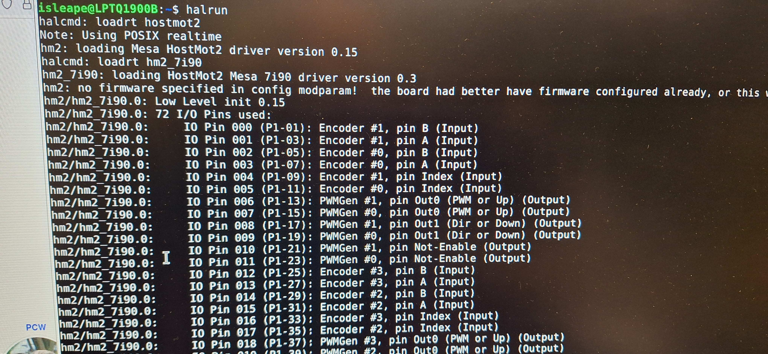

Hi, I loaded Halrun, followed by loadrt hostmod2 and hm2_7i90.
I got the following response on the foto. However im not sure if this is realy comming from my mesa card or not due to the warning and still no mesaflash responses what so ever....
I started the i790hd from Secondary eeprom that i think ...never touched. I also resoldered the cable etc. Can you tell me what im seeing? I will try to see if the inputs work in the hal monitor...
Thanks for any insight...

Hi, I loaded Halrun, followed by loadrt hostmod2 and hm2_7i90.I got the following response on the foto. However im not sure if this is realy comming from my mesa card or not due to the warning and still no mesaflash responses what so ever....I started the i790hd from Secondary eeprom that i think ...never touched. I also resoldered the cable etc. Can you tell me what im seeing? I will try to see if the inputs work in the hal monitor...Thanks for any insight...

05 Feb 2026 15:39 #342518
Replied by PCW on topic Mesa 7i90HD no comunication/ update erprobte on 2nd mesa
No picture was included
Did you have SPI working before you changed the firmware?

05 Feb 2026 16:57 #342519
Replied by tommylight on topic Mesa 7i90HD no comunication/ update erprobte on 2nd mesa
He added the picture above, seems all is good as it lists PWM and encoder pins.
Yes, that appears to be a working EPP configuration
What exact mesaflash command did you use?
