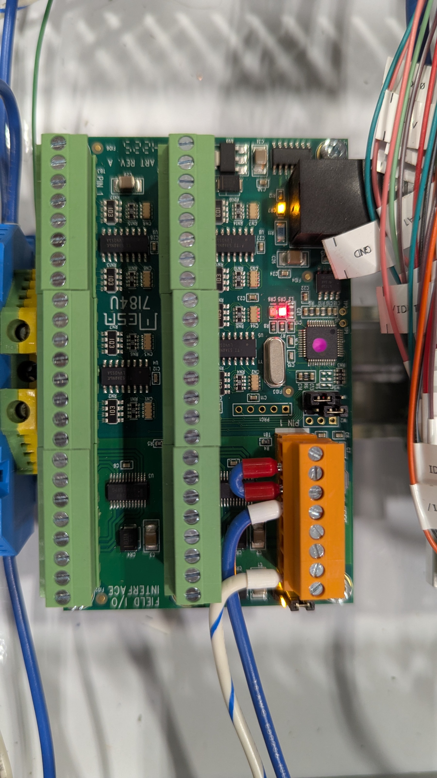

First time using a Mesa Ethernet board and I'm trying to set up a new install.  I think I've flashed the right firmware to the 7i76eu.  But I can't seem to see the 7i84u card that I have plugged into the first serial connector on the 7i85.  The encoders seem to be working on the 7i85, but I can't seem to make the 7i84u work.  On the 7i85u CR2 and CR7 are on yellow and CR5 is on red.  Not sure what I'm doing/have done wrong.
Here's the output of mesaflash --device 7i76eu  --addr 10.10.10.10  --readhmid

24 Feb 2026 16:09 #343407 by tommylight
Replied by tommylight on topic 7i76EU+7i85+7i84U
7i84 requires having field power on both section for all IO to show up, not sure about the 7i84U.
Is the field power applied to the 7i84U?
24 Feb 2026 16:11 - 24 Feb 2026 16:17 #343409 by PCW
Replied by PCW on topic 7i76EU+7i85+7i84U
Is sserial channel 2 enabled in the hal file?
(something like : "sserial_port_0=000xxxxx" in the driver command line)
Also
mesaflash --device 7i76eu  --addr 10.10.10.10  --dbname2  7i85 --readhmid
would list the 7I85 pins, not DB25 pins

24 Feb 2026 16:26 #343412 by Todd Zuercher
Replied by Todd Zuercher on topic 7i76EU+7i85+7i84U
Yes, the field power is connected.
I have this for the config line in hal
loadrt hm2_eth board_ip="10.10.10.10" config="num_encoders=5 num_pwmgens=0 num_stepgens=5 sserial_port_0=0000000x"

24 Feb 2026 17:38 #343419 by Todd Zuercher
Here's the power connector
24 Feb 2026 18:37 #343420 by PCW
I'll test this setup later today.

24 Feb 2026 22:40 #343436 by rodw
Replied by rodw on topic 7i76EU+7i85+7i84U
Take care here, Network cabling comes in two different flavours T568B and T568A. Google for the difference
In my case, Mesa's serial port manual describes one of these standards but in my country the normal standard was the other!
I drew up my own pin out diagram converting the wire colours to be correct and my 7i73 woke up!
