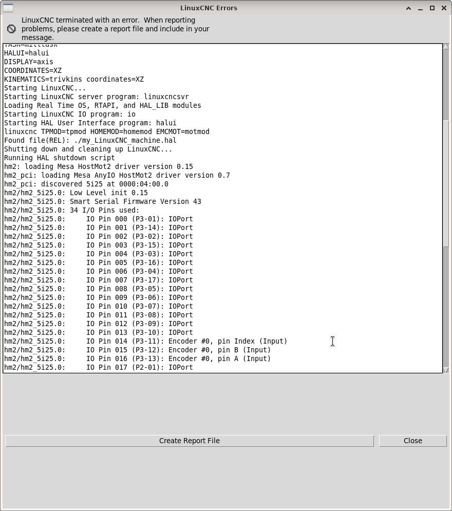

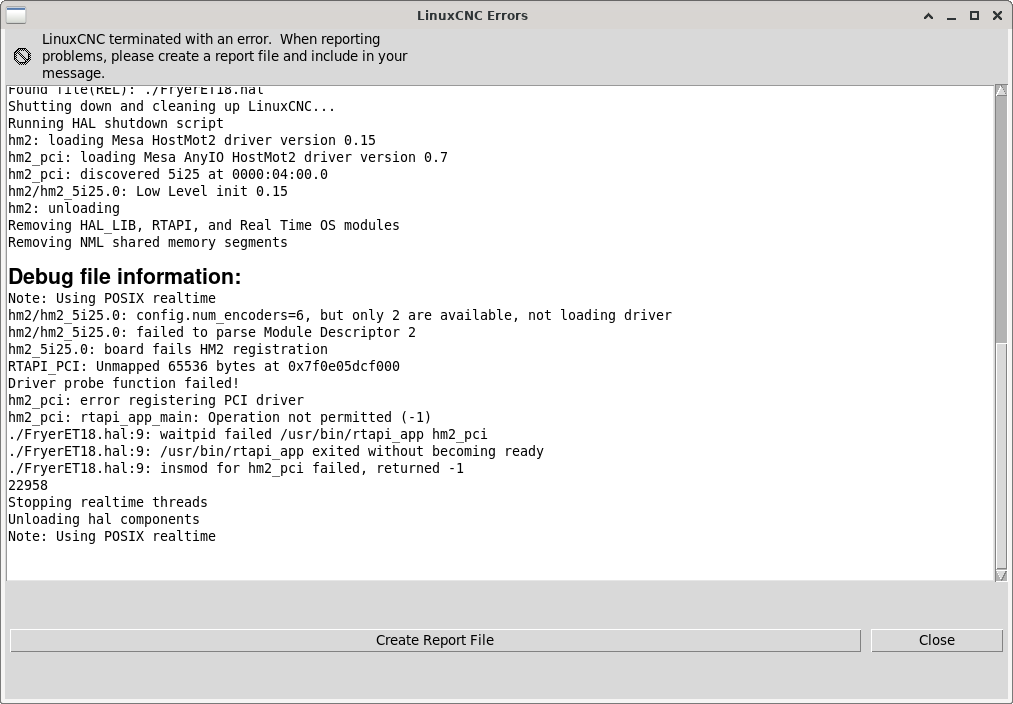

27 Mar 2026 14:59 - 27 Mar 2026 15:05 #344829
by grossm5000
Replied by grossm5000 on topic Differential encoder hard crashes the PC MESA7i77
HEY! I am so dumb I didn't see your reply till just now. I actually bought another 6i25 convinced I had an issue with the card.
ANYWAY...I don't get any errors when I launch LinuxCNC, just a hard, full computer shutdown if the 7i77 is connected to the 6i25. If the 6i25 is NOT connected to the 7i77, I just get the Linuxcnc error i posted earlier.
So...I put in the NEW 6i25 just now, hooked up the 7i77 and launched Linuxcnc...and it DIDNT CRASH this time! Exciting. Now i just get a new Linuxcnc error:
Looks like the firmware wants an update? Do I do this with mesaflash?
Last edit: 27 Mar 2026 15:05 by grossm5000. Reason: added more information after trying new 6i25 card

27 Mar 2026 17:13 #344835
Replied by PCW on topic Differential encoder hard crashes the PC MESA7i77
Yes, you need to install firmware that matches the 7I77
You first need to download the 5i25.zip from
www.mesanet.com/software/parallel/5i25.zip
unzip and then change to the configs/hostmot2 directory and then
sudo mesaflash --device 5i25 --write 5i25_7i77x2.bit --reload

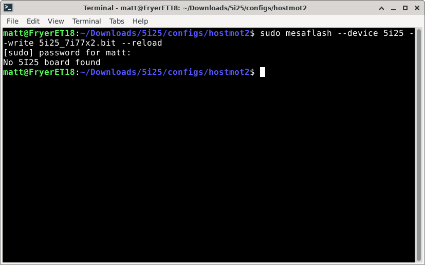

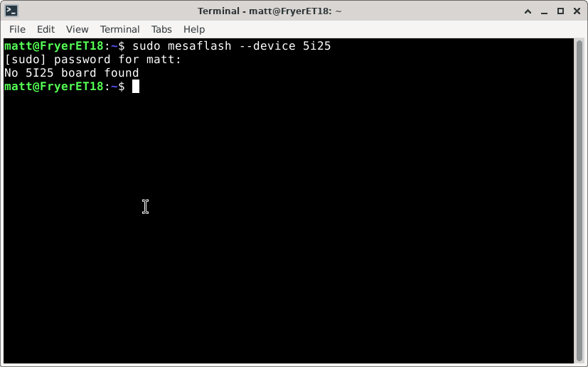

Did you try running mesaflash after running LinuxCNC?
- grossm5000
- Posts: 38
27 Mar 2026 20:07 #344845
by grossm5000

- Posts: 18109
- Thank you received: 5329
28 Mar 2026 00:49 #344857
The problem is this:
Region 0: Memory at fce00000 (32-bit, non-prefetchable) [disabled] [size=64K]
Which is likely something the BIOS did so may be fixable if you have access to BIOS PCI settings
I will take a look into what is needed to get mesaflash to re-enable the memory region (lLinuxCNC does this)
