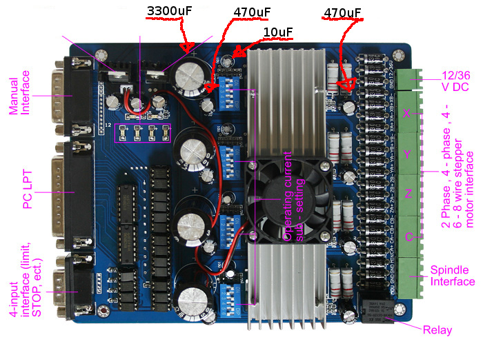

hallo!
does anyone know the right steplen, stepspace, dirsetup, dirhold of the cheap TB6560AHQ drive that can be found on the bay?
tried again to read and read again the pdf of the specification, but couldn't understand the right timings to setup emc.
right now i played a lot with this driver, but still don't know if i set it up correctly!
anyone know how to know the correct timings?
thanks, dab.

In the 6560AHQ data sheet I found only two important timings:
max clock frequency = 15 kHz
min clock puls width = 30 usec
But there is also a dependency from the internal chip clock and its corresponding capacitor, which is not precisely discovered.
From this values you should be on the safe side in any case with steplen = 30000.
From my own experiences a 6560AHQ in my own board (no opto) works reliable also with 20 usec and even less, but it does definitely not work with 5 usec, which is the default for stepconf. This is what you have to change in stepconf.
If you edit hal directly: remove the reset function of the puls pins and limit the stepping frequ to 15 kHz, then it should work.
All other settings I took from stepconf defaults, and I have not found any issue up to now.

i'have read about the capacitor, but i'm not able to recognize which one is on the drive. (the normal or miniaturized?)

if anyone can tell, these are my capacitors (those repeated per channel)
then, on the chip specs i've found this:
Capacitor / Oscillating Frequency / Minimum Clock Pulse Width tW(CLK) (Note 1)
1000 pF 44 kHz 90 μs (Note 2)
330 pF 130 kHz 30 μs
100 pF 400 kHz 10 μs (Note 2)
so it's probably the 470 capacitor on the driver the one we are talking of.
so i can suppose a minimum clock pulse of around 40μs...
can it be right?

"Reset" lets you send 1 step per base thread rather than one step per 2 base threads.
If the base thread execution time is too short, and the driver needs a very long pulse, then this might need to be disabled. However, doing so will halve your maximum step rate.
It is often worth experimenting with inverting the step signals, this exchanges long off-time and short on-time for long on-time and short-off time, and some drives work a lot better that way.
