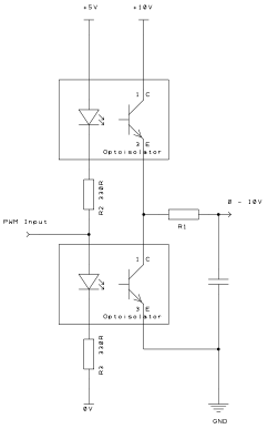

29 Jul 2011 10:23 #11983 by andypugh
elvistaylor wrote:
I need that like 0-10V + direction signal controller to control my edm machine..
That's relatively easy. Depending on how good you are at electronics, you can either build your own PWM to voltage conversion circuit, or buy a commercial interface card.
This card will do what you want: homanndesigns.com/store/index.php?main_p...ath=1&products_id=38
If the drive can be configured to work with 0-5V then the minimal solution is just a capacitor between 0V and input on the drive, and a resistor from the PWM output pin to the drive input. That is probably a bit _too_ minimal really, though.
This circuit might work, but I have never actually tried it.
