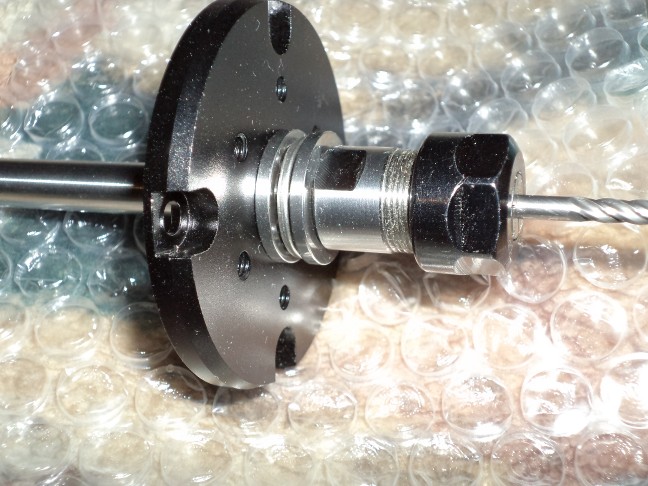

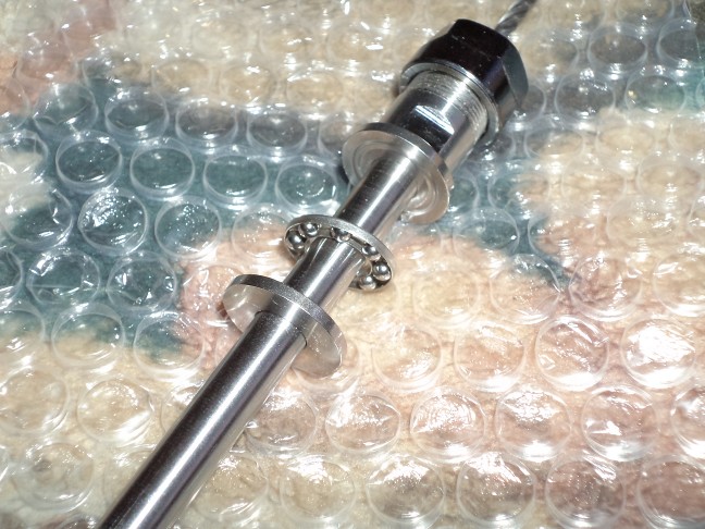

Hi!
I'm currently try to build DIY brush-less spindle motor, because i can't find such items in shops. I collect some stuff which was never designed to work together, but i'm really want to finish this project
The stuff includes precision 8 mm shaft with collet, RC car motor, and axial bearing, along with other magic parts. There is no cavity (enclosure) for place the axial bearing, so it is currently outside the motor (please see photos). But if i lubricate it with grease and turn motor on, the grease will immediately dispence on my room and on me myself. Bearing not have cover(s) like traditional radial bearings. So the question is, how to lubricate these bearings? How the big guys do it? And can it ever run without enclosure?
Thanks!

The big guys never put thrust bearings outside to collect chips. You might fit a cover over it...

You can get sealed double angular contact bearings, which have about the same axial rating as your current bearing, and a lot more radial load rating.
If the shaft is 8mm as you say it is a little more difficult, as the smallest bore is 10mm in sealed angular contacts. You would need a collar to make up the difference.
simplybearings.co.uk/shop/p500256/42002R...mm/product_info.html
Unless you are in the UK that would be a daft place to buy from, but bearing numbers are international.
You might want to consider using a different type of bearing.The stuff includes precision 8 mm shaft with collet, RC car motor, and axial bearing,
