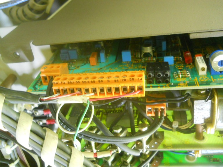

Hi all,
I have a Bridgeport with a 810 M Siemens controller and I would like to do an EMC retrofit. I would like to keep as much of the existing control as possible although I don't know if what I have is compatible. This is all new ground to me so if anyone can get me pointed the right way I would appreciate it.
The servo amps/drivers are:
6RB2 000-ONE00
6RB2 025-OFA01
I searched and haven't found any other info on them.
Servo:
176 V
2000 rpm
4.4 amps
.7 hp
Brushed
Encoder:
ROD 320.005
Imp. 2000 /U
www.encoder.com/literature/datasheet-dr735.pdf
The servo drivers have two wires powering the servo, three wires to the servo tachometer, and 3 wires from the controller itself. The encoders go directly to the controller.
The controller also connects to two relays for spindle forward and reverse, eight limit switches, jog handwheel, and emergency stop.
Possible? Or scrap the electronics and turn it into a manual machine?
Benjamin

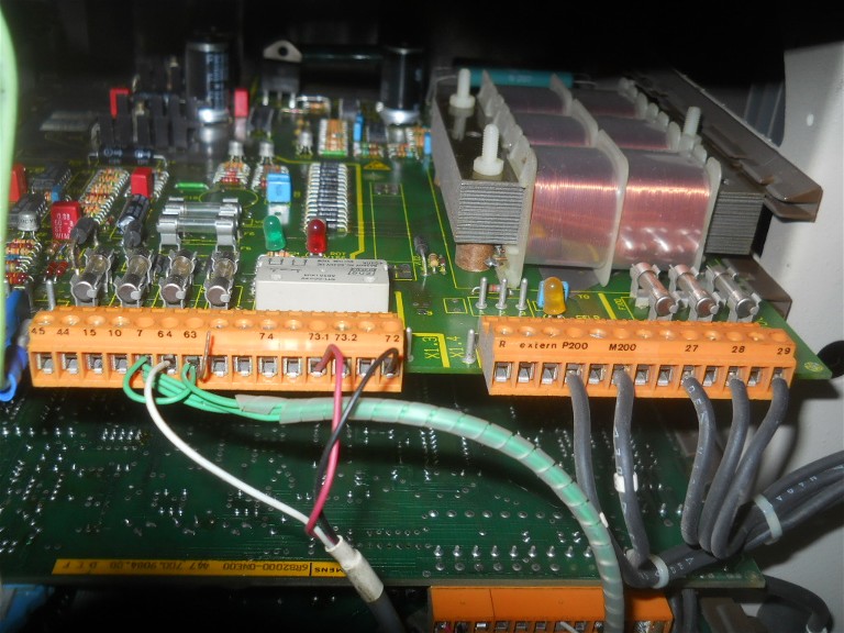

- cncbasher
- Posts: 1744
- Thank you received: 288
16 Dec 2011 11:14 #15728
by cncbasher
Replied by cncbasher on topic Re:Bridgeport with Siemens amps and servos
yes it will be 0 - 10v analog signal input . ( going by memory so i may be wrong it's pin 9 with pin 7 being the inverse input ( no used ) and pin 8 being analog ground )
theirs also an enable relay ( pins 1 & 3 ) i believe
at least gives you an idea of the direction to go , but check your boards it may variy slightly
if you can post a picture of the board , i should be able to confirm the pins and connections

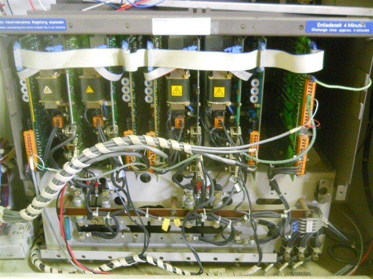

- BRoth
- Posts: 18
16 Dec 2011 19:30 #15746
by BRoth
Replied by BRoth on topic Re:Bridgeport with Siemens amps and servos
- BRoth
- Posts: 18
16 Dec 2011 19:31 #15747
by BRoth
- BRoth
- Posts: 18
16 Dec 2011 19:32 #15748
by BRoth
- robh
- Posts: 162
- Thank you received: 24
20 Dec 2011 22:28 #15910
by robh
Replied by robh on topic Re:Bridgeport with Siemens amps and servos
thoes are the same drives as mine and Johns CHNC
so check our johns info thread on his chnc info should be in there. if not let me know i have it some where marked down.
but mine no longer them nice shiny new AC servos now.. was upgraded version gen 1 that i have in the old hardinge superslants...
nice easy to set and tune them drives and get going..
what spindle drive do you have?
rob
rob
- BigJohnT
- Posts: 7000
- Thank you received: 1176
20 Dec 2011 22:53 #15912
by BigJohnT
Replied by BigJohnT on topic Re:Bridgeport with Siemens amps and servos
On my axis drives 14 - 56 are the +-10v velocity inputs to the drives. I forget exactly how I had to enable them atm.
John
