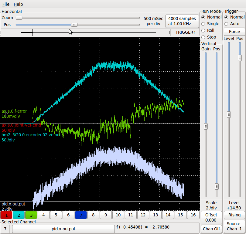

- jd896
- Posts: 79
06 Jun 2012 13:57 - 06 Jun 2012 13:59 #20679
by jd896
Replied by jd896 on topic Re:esab ultrarex retro fit plasma / flame cutter
Last edit: 06 Jun 2012 13:59 by jd896.
- Posts: 18111
- Thank you received: 5330
06 Jun 2012 18:28 #20685
Replied by PCW on topic Re:esab ultrarex retro fit plasma / flame cutter
a little tweak of FF1 to center the ferror
during cruise is probably in order
(average looks about 1/4 of a division low during cruise)
After that, looks like some 'I' would pull in the slow ramps
of ferror during accel and deccel
(and get rid of the static ferror at the beginning)
- jd896
- Posts: 79
07 Jun 2012 07:56 #20699
by jd896
Thanks pcw if found after some reading and testing that my drives don't respond around 0.15 etherside of zero would you think the inverse deadband comp should work?
- jd896
- Posts: 79
11 Jun 2012 22:37 #20825
by jd896
i have tryed some i and every time i try usless im not trying small enough numbers it throws the whole ferror off constant and all so what would help i read in another post about ff3 maybe ill post another chart tommorrow when i get chance to get back of the machine the ferror is closer now tho
- jd896
