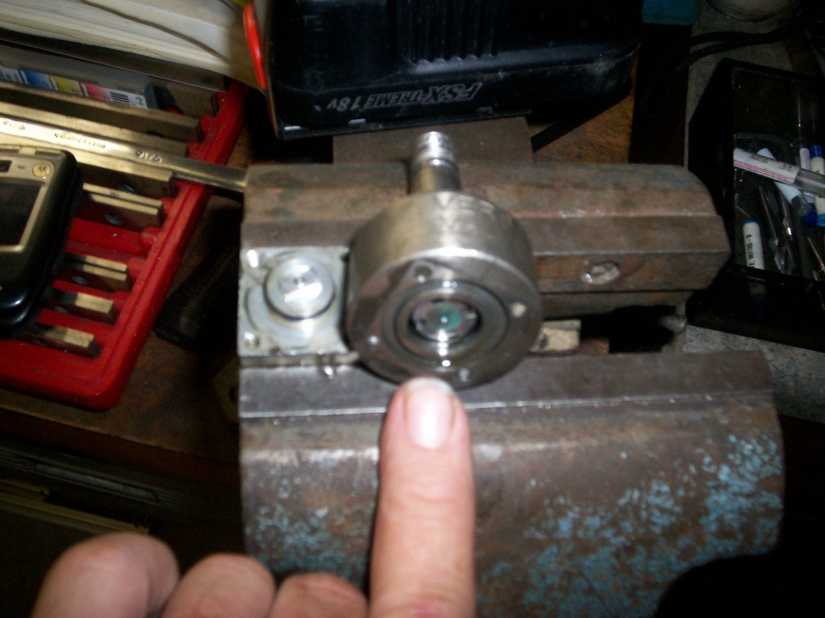

20 Jul 2012 03:19 - 20 Jul 2012 03:20 #22232 by bobinater
Replied by bobinater on topic Re:Hardinge HNC retrofit and where to start
hey big john
I got the collet closer unstuck, some yahoo tightened the thing so tight that the
air cylinder would not even move. I disconnected the air lines from the tail end of the closer and loosened the four 1/4-20 bolts, used a little pb blaster on the spindle end and low and behold the collet came right out none the worse for wear, the collet closer does not seem to be leaking but the air solenoid that controls it have attached a pic in this post, is there supposed to be an o-ring in the groove that I am pointing at?
or will this solenoid leak w-o power applied?
thanks
Bob
Last edit: 20 Jul 2012 03:20 by bobinater.
20 Jul 2012 10:52 #22237 by BigJohnT
Replied by BigJohnT on topic Re:Hardinge HNC retrofit and where to start
That's different from mine, but I would assume an o-ring would go in the groove.

20 Jul 2012 12:14 #22239 by andypugh
Replied by andypugh on topic Re:Hardinge HNC retrofit and where to start
it looks like an O-ring groove, but I think I see an O-ring on the mating part that makes it redundant.
20 Jul 2012 13:15 #22241 by bobinater
I saw that too Andy but the mating part is a plunger and it moves up and down to direct airflow to either side of the collet closer, Maybe i will disassemble the valve for the parts catcher and see if it has an O-Ring. that one is not leaking. Just in case where is a good place to buy new valves?

20 Jul 2012 15:27 #22242 by andypugh
It sounds to me like you need an O-ring, not a valve.
