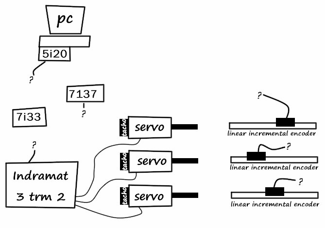

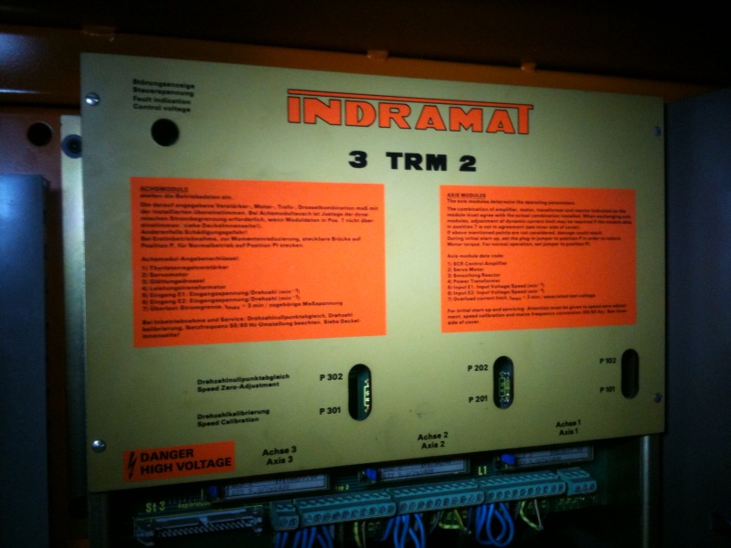

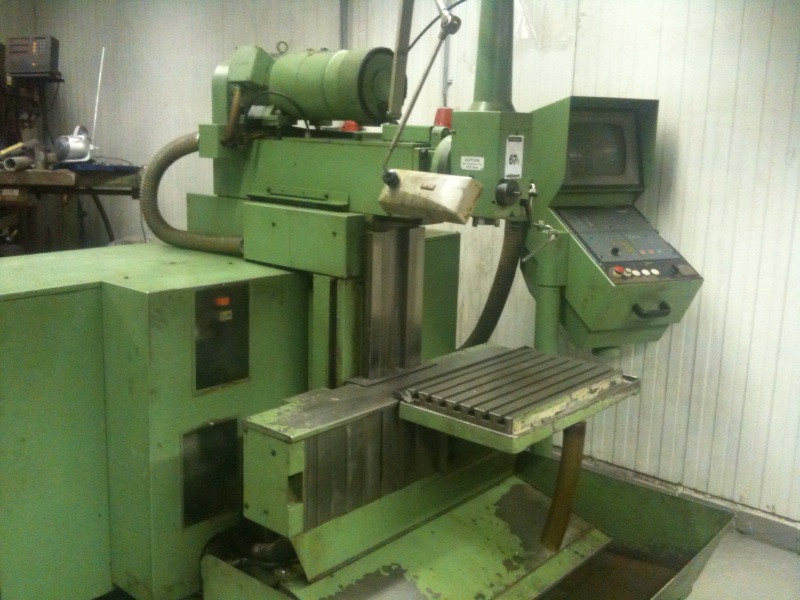

Hello everybody,
I've registered for this forum because of a project i'm starting.
I would like to retrofit my Maho mh400c with emc2.
This is because the old philips 432 control is broken and it's getting harder and harder to find the right parts for it.
I would like to use the original indramat 3trm2 servo drive and the linear encoders.
I found the following thing: <click>
It takes the step/dir signal and makes it into an +10v/-10v signal.
Perhaps its usefull?
Any info that can be usefull for my build would be highly appreciated.
Something like this?--->

- BigJohnT
- Posts: 6999
- Thank you received: 1176
05 Mar 2010 13:06 #2196
by BigJohnT
Replied by BigJohnT on topic Re:Retrofitting my maho mh400c
Your tacho does not go back to the servo drives?
I'm doing a Hardinge lathe atm and used a Mesa 5i20 with 2 7i37's for I/O and a 7i33 to run the drives. The 7i33 takes the encoder feedback and sends out the +-10v to the velocity input of my drive.
John
John

- robh
- Posts: 163
- Thank you received: 24
05 Mar 2010 19:46 #2201
by robh
Replied by robh on topic Re:Retrofitting my maho mh400c
Hi
ill reply here also
keep the info in 1 place, this should be a fairly easy setup todo.
the linear encoders might make things fun to tune for the motors in the PID depends where these are mounted etc but it shouldt be a mission imposible.
i would pick up a mesa 5i20 (or other sutable card) and use the 7I33 for analog out (io cards as john said)
if you have the manuals for the machine your life will be very easy
emc will have no problem running your machine
im sure maybe selling some of the control boards when done from the machien will fund the upgrade no problem
rob

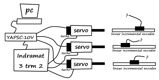

- pirke
- Posts: 16
08 Mar 2010 18:36 #2240
by pirke
Replied by pirke on topic Re:Retrofitting my maho mh400c
i think i found the perfect solution!
click here
click here

- Posts: 19097
- Thank you received: 5271
11 Mar 2010 16:56 #2278
Replied by PCW on topic Re:Retrofitting my maho mh400c
for 3 analog servos +spindle, a 5I20 +a 7I33(TA) + a 7I37(TA) will do as long as the 4 servo interfaces
provided by the 7I33 (4 +-10V analog outputs + 4 quadrature counter inputs)
and the 8 1A DC outputs and 16 isolated inputs provided by the 7I37 are sufficient for your I/O needs
you can add one more 7I37 for isolated I/O if needed
In addition, 2 or 3 AIO 50 pin cables would be required

Then there's anothor problem, my linear scales dont put out a quadrature wave.
apparently they give a sine wave.
I've been told this could easily be fixed witch a custom circuit using a comparator, but i'm no electrical engineer...
I've found somebody who can build this for me but i wonder if there is a existing solutions for this.
so basically my shopping list is the following:
A computer (of course)
A 5i20 card
A 7i33 card
A 7i37 card
Maybe another 7i37 card?
Some AIO 50 pin cables
Something to fix the sine wave to quadrature
What did i forget?
