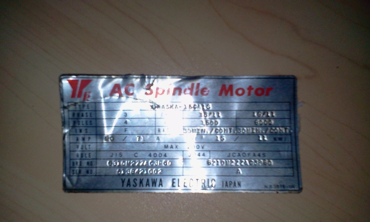

The spindle motor on this machine is a Yasakawa 20HP 230V Unit with what I assume is a Yasakawa drive. One of the things I was considering was to change out the drive since the drive seems to be 480V while the rest of the machine is 230V. Since I currently don't have a 480V drop in my shop, I was thinking I would just use a 230V VFD to drive the spindle motor and send the encoder feedback back to linuxcnc. After reading this thread I think I may have been wrong (?). The other option may be to find a 20HP 230V (3PH) spindle drive on ebay, but I am unsure if the spindle drive needs to match the motor. I'm just not too crazy about going through the expense of running 480v into the shop for one component of a single machine.

14 Aug 2012 20:47 #23210 by andypugh
Replied by andypugh on topic Re:New Build - Tree VMC 1000
dangercraft wrote:
[quotethe drive seems to be 480V while the rest of the machine is 230V. Since I currently don't have a 480V drop in my shop, I was thinking I would just use a 230V VFD to drive the spindle motor and send the encoder feedback back to linuxcnc.[/quote]
The first thing I would try would be to see if the existing VFD will play on 230V. You will lose some power, but 20hp is a lot of spindle.
There is a good chance that the spindle motor will run well (if slightly more slowly) on 230V. It might also be possible to re-wire it for 230. (though if it is a 2 speed motor which I vaguely recall, then this may be complicated)
230V in / 480V out VFDs exist, but will be expensive at 20hp.
14 Aug 2012 23:23 - 14 Aug 2012 23:27 #23214 by dangercraft
Replied by dangercraft on topic Re:New Build - Tree VMC 1000
Andy,
I just checked and the plate on the motor says max voltage: 200v so I am guessing the input on the spindle drive is 480v and the output is 200v. I take it running a VFD instead of the spindle drive is a no go then huh? :laugh: I'm not sure if its a 2 speed motor, but it does have a 2 speed gearbox (belt drive) on the spindle and the spindle speeds are supposed to be infinitely variable. I'll try and get a picture of the plate on the motor to post up.

14 Aug 2012 23:36 #23215 by dangercraft
This is the plate from the spindle motor.
14 Aug 2012 23:41 #23216 by dangercraft
The plate on the spindle motor has the following information on it:
Type: UAASKA-15CA1S
Phase: 3
Poles: 4
INS: F
KW: 15/11 RPM:1500 RATING: 30 Min. Cont.
KW: 15/11 RPM:6000 RATING: 30 Min. Cont.
AMP: 80/71A (at 15/11 KW)
VOLT: MAX 200V
RULE: JIS C 4004
JP44: JCAOF4S
Brg. No.: 6310M2ZZAC3P60 6210M2ZZAC3P60
SER.: S138421002
