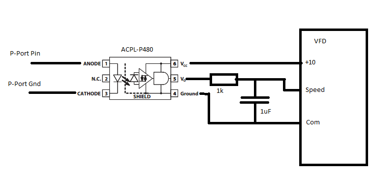

23 Oct 2012 13:14 - 23 Oct 2012 13:16 #25670 by andypugh
BruceLayne wrote:
There is probably some simple and cheap hardware that will allow LinuxCNC to generate that analog control voltage
Indeed there is. You need a capacitor and a resistor. The first picture here
www.linuxcnc.org/index.php/english/compo...id=27&id=24915#24915
You then set up a PWM module in HAL to output a PWM on a parallel port pin, then filter that to a DC voltage.
This might not be the ideal answer, as the voltage is sourced from the parallel port, not the VFD +10V (or whatever).
To emulate a potentiometer a slightly more complex solution is required.
You need an opto-isolator with a totem-pole output. This is important as you need a push/pull output to discharge the capacitor at logic-false and charge it at logic-true.
I used: uk.rs-online.com/web/p/products/734-4962/

23 Oct 2012 13:36 - 23 Oct 2012 13:39 #25673 by BruceLayne
Replied by BruceLayne on topic Re:Grizzly G1006 Milling Machine CNC Conversion
I was hoping that LinuxCNC supports a simple frequency to voltage converter. This is exacly what I was hoping to see. Thanks Andy. At the very least, you definitely saved me some googling when I got around to the VFD implementation. I'm trying to take this a step at a time, and I'm still at the stage where I'm making motor mounts. I hope to have simple XYZ motion in an evening. I'm trying to get this CNC conversion done as quickly and as easily as possible. I have many other not so easy CNC projects underway and I'm trying to get this machine to CNC productivity with the minimal distraction to the other competing projects.
I'm an EE, so the circuit is actually less valuable to me than the confirmation of the PWM signal generation in LinuxCNC. I may make am op amp circuit that can generate +/- 10VDC or 0 to 10 VDC and publish it for others to use.

23 Oct 2012 13:53 #25674 by andypugh
www.linuxcnc.org/docs/html/hal/rtcomps.h...en_a_id_sec_pwmgen_a
The circuit probably wants to emulate a Potentiometer, as that is what most drives expect. It is worth bearing in mind that some drives (the KBIC controllers for example) float the pot at mains voltage.
My first attempt at a controller for a KBIC used a DC-DC converter to create a floating reference voltage and a precision current source. On reflection that simple circuit above would have worked better and more cheaply.
