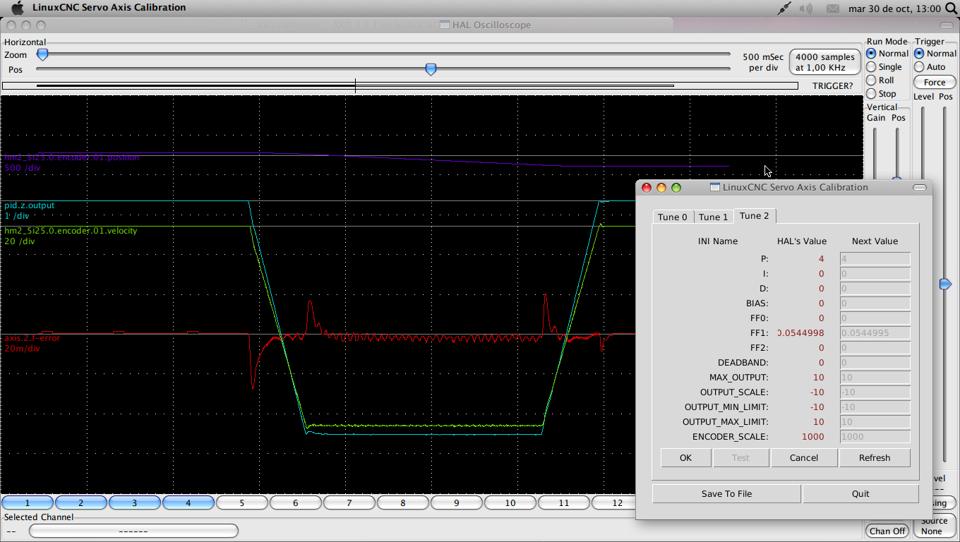

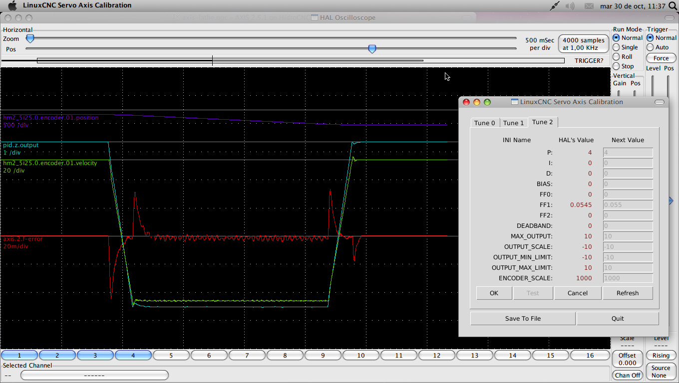

Now I have movement in both axes,
Today cautiously move my X axis achieved by removing the brake slowly and taking a piece of wood down.
but I worry that the variable:
MAX_ACCELERATION: 300,
I'm not sure that value. and not really not getting to an exact value.
In my case my Z axis moving 5000mm/min
0mm to 150mm away, when it reaches 150mm feels "blow" when it reaches the required position.
feels the blow in both directions, but more when going from 0 to 150mm
when going from 150-0 does feel little.
lubricate well, no obstruction, the shaft can move it by hand,
I think that may be the acceleration, or it may be that I have not reached the correct PID?
the blow is when the motor stops. not express it in English, sorry
Thanks for all your time, and your help

04 Nov 2012 04:05 #26244 by andypugh
Replied by andypugh on topic Cincinnati Millacron X axis slide
300mm/s^2 doesn't seem like a very high acceleration. But you can try reducing the number to see if it makes things smoother.
Maybe the problem is the brake applying when it probably shouldn't?

05 Nov 2012 21:00 #26277 by jlviloria
Replied by jlviloria on topic Cincinnati Millacron X axis slide
Andy, thanks for your response.
The problem I have now is that if you gain more acceleration, the movement does me good. no longer strikes,
but tried to set the PID of the servomotors. If I increase the acceleration of error peaks increase in the acceleration and deceleration.
not if it is another problem but I can not increase my P to more than 5 because it begins to oscillate. Peter told me that a low P is for adjustment.
Try D, but has been in vain. right now, I'm trying to I.
But the truth I'm lost.

05 Nov 2012 21:21 - 05 Nov 2012 21:22 #26278 by andypugh
Which "error"
Discussion in another thread has us wondering if tuning PID on pid.M.error rather than axis.N.f-error might be better.
The way that f-error is calculated means that it will always have a higher value at higher speeds.
Igain is used to get the last bit of steady-state error out. It won't make the machine any faster.
if a Pgain of 5 is as high as you can go, perhaps that is the right value? How does the machine move with a Pgain of 5?
The actual value of Pgain depends on a number of factors. If the PID input and feedback are mm and the PID output scales directly to volts then 5 does seem very low
(10V output with 2mm position error).
However, if PID command and feedback are encoder counts and PID output scales so that 1 = full power then 5 seems rather high.
What units are your PID input in, and what units are the PID output in?
Most importantly of all, does the machine move right? How does it compare to similar machines on Youtube?
Last edit: 05 Nov 2012 21:22 by andypugh.
05 Nov 2012 21:47 - 05 Nov 2012 21:49 #26279 by jlviloria
Andy.
the machine moves well, although I have not managed to move 10000mm/min. I've only come to 7000mm/min. when 7000mm/min move faster than I get a warning in the "servodrivers".
The truth does not quite understand the translation.
the problem is that obviously when minus the max_acceleration the movement acceleration and deceleration slows. increase when moving fast acceleration in the acceleration deceleration but f-error causes very high peak in the acceleration and deceleration.
I do not understand that the input and output units of the PID?
work in programming of CNC machines, and moves well when I apply more acceleration. but the problem of peak-error f are what make me doubtful if I go on track
in the image pidnew-h acceleration 600
in the image pidnew-f acceleration 800
Last edit: 05 Nov 2012 21:49 by jlviloria.
