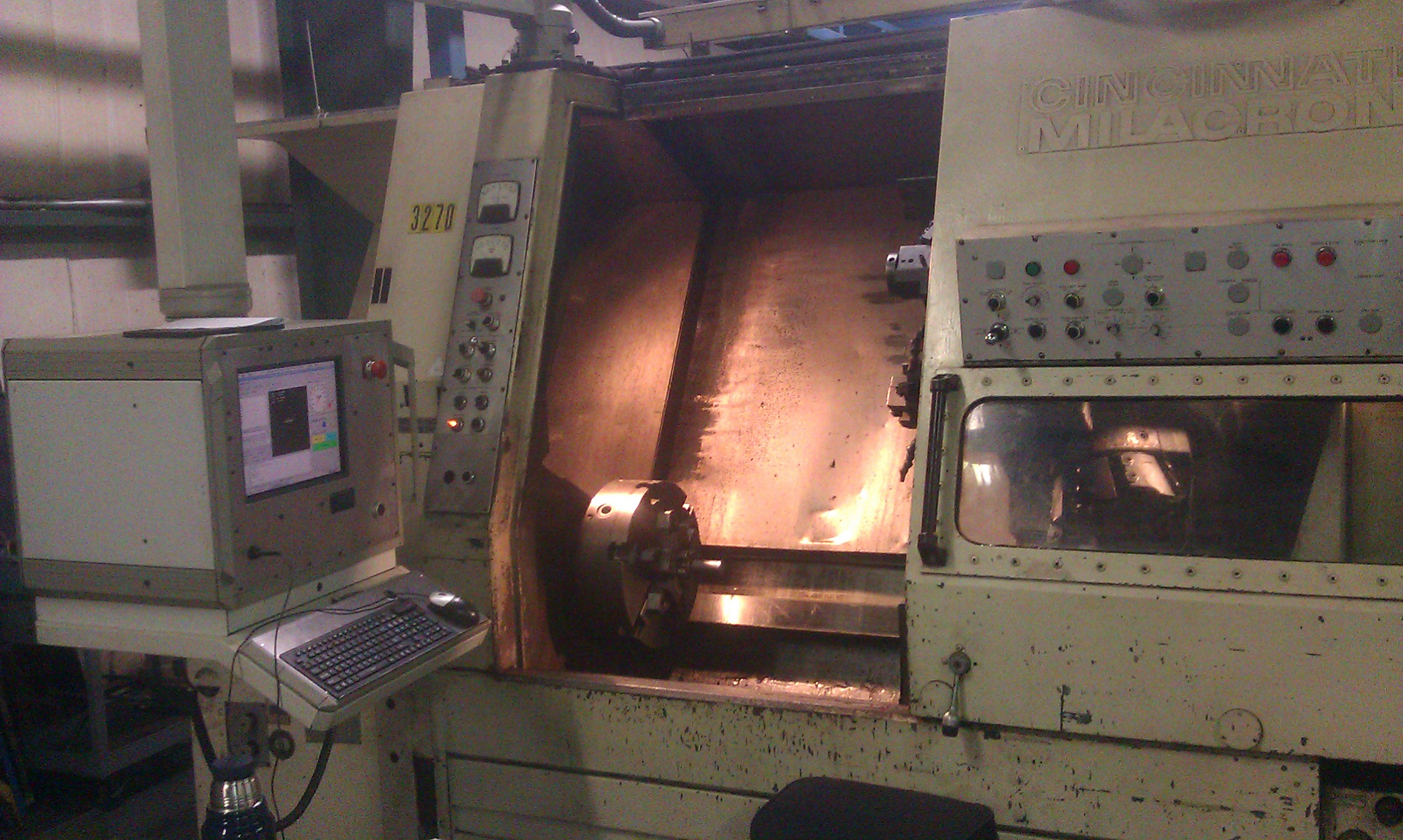

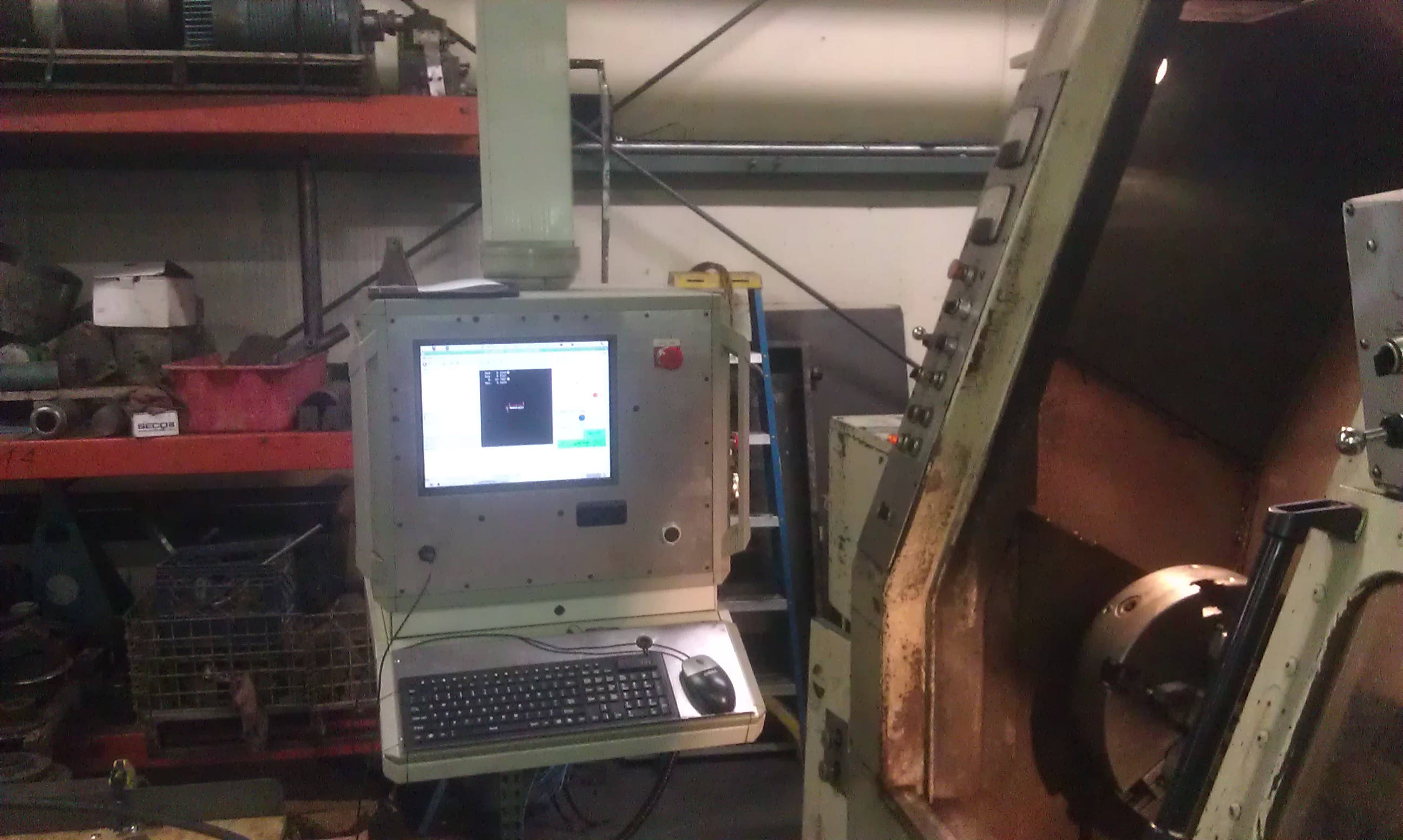

Looks like the LinuxCNC/Mesa conversion saves a lot of space.

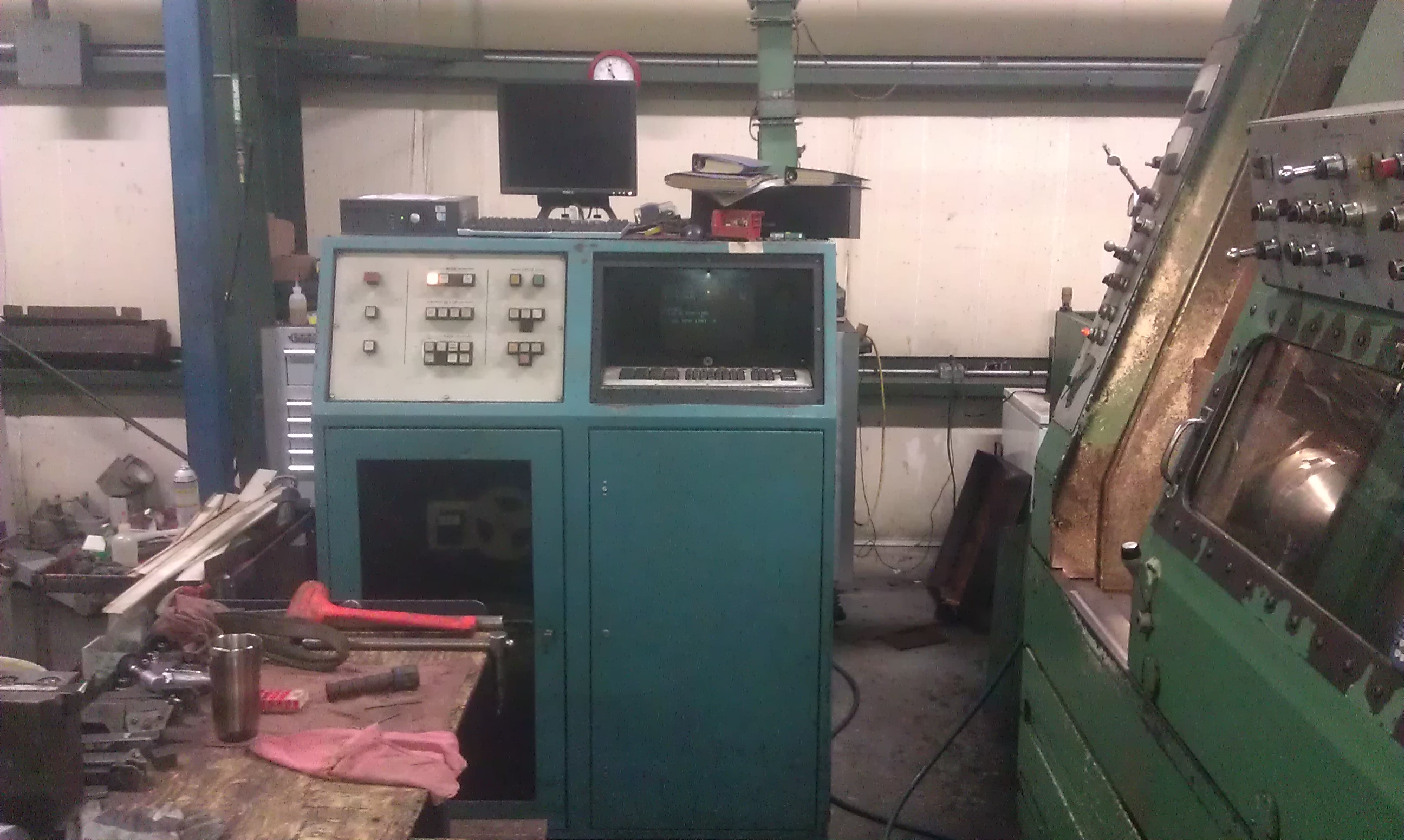

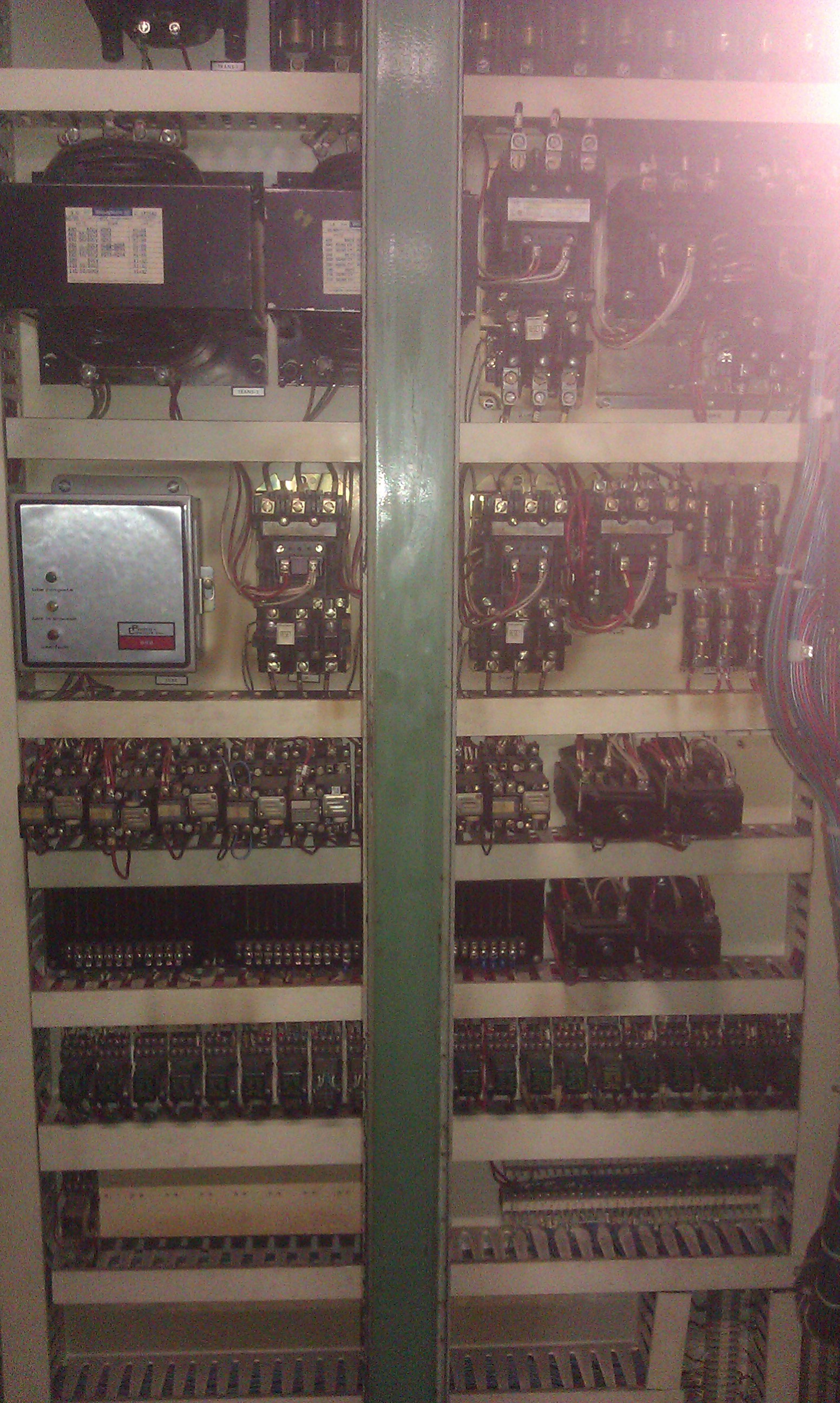

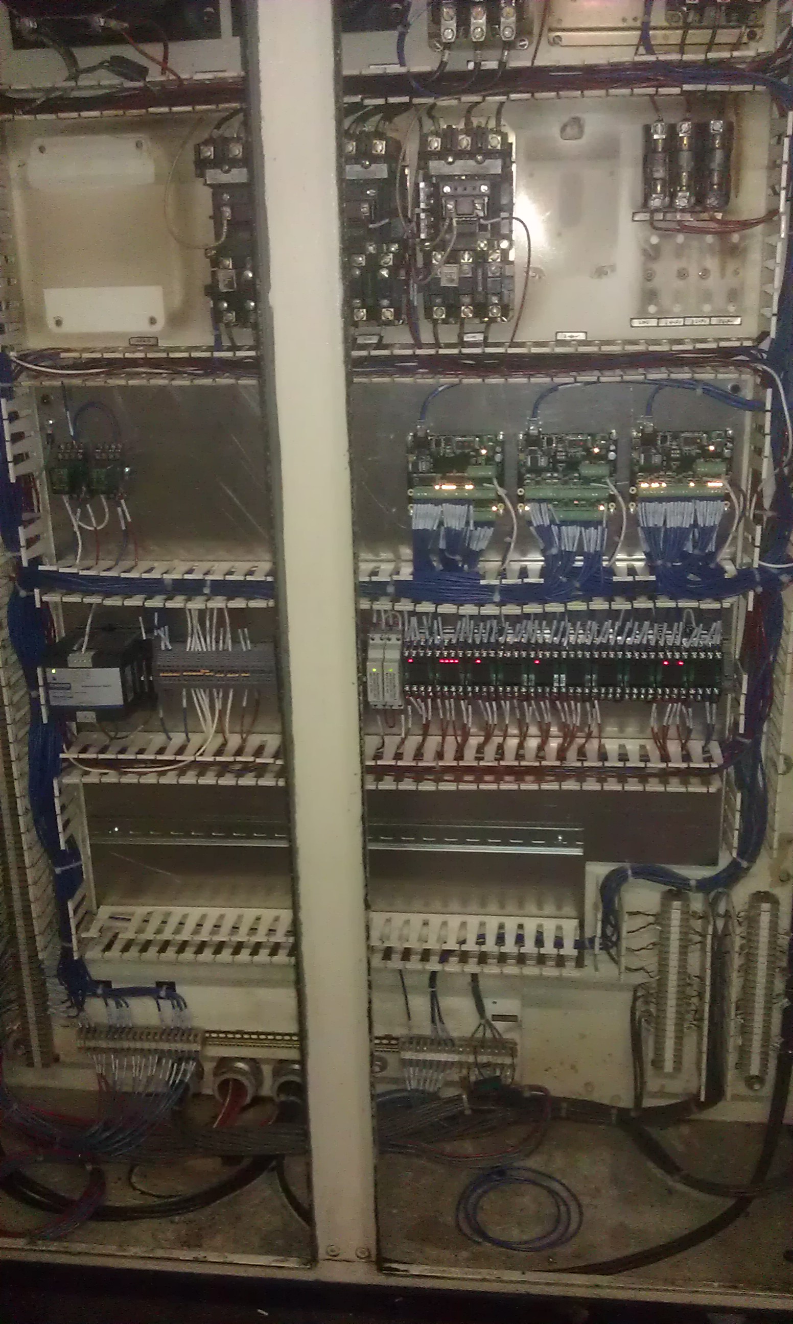

Hello Andy,
It saves an enormous amount of space, the big blue controller in the one picture with the screen and film roll on the lower left is completly replaced as well as 20 something ice cube relays and about 10 old allen bradley counters by the 5I23/7I44/7I49/7I70/7I71/7I73 combo we are using. About 6 weeks of making back planes and wiring and then another 2-3 weeks of programming/troubleshooting to get to the point where that machine is.
Rick
Rick
