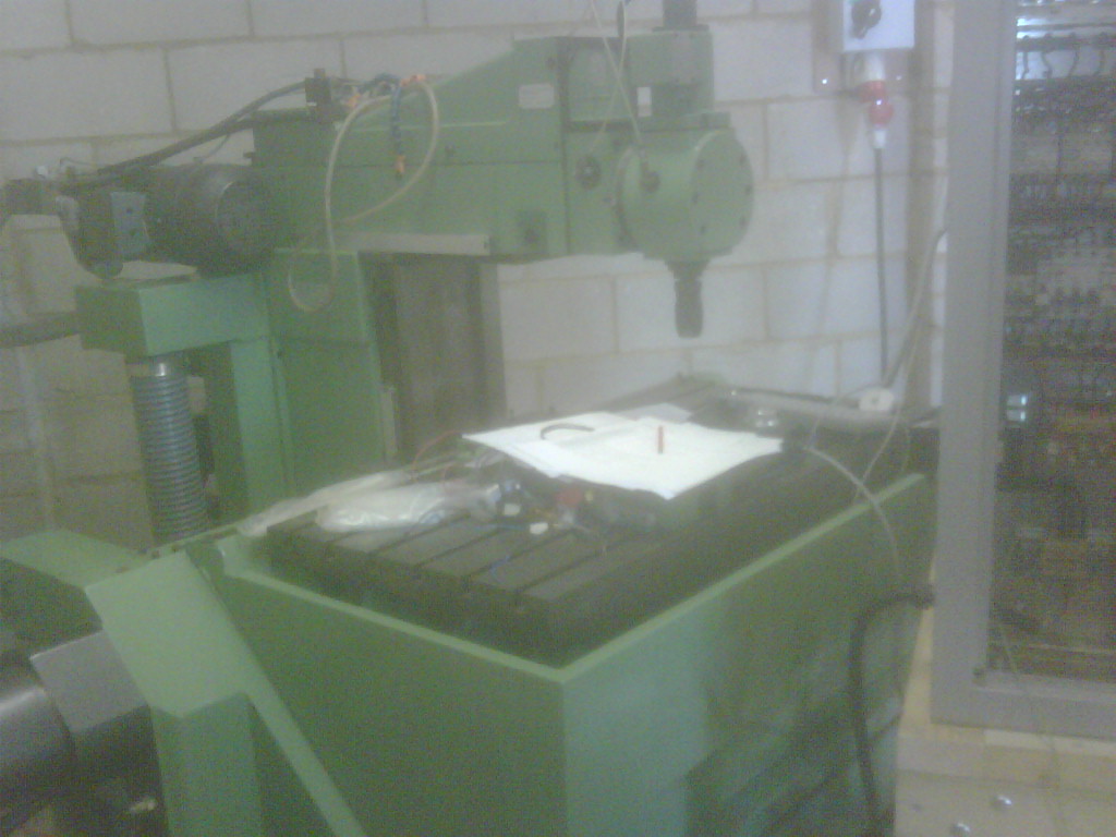

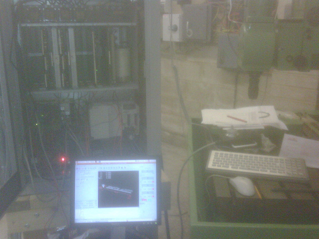

Hi all
I am in the process of building / trying to set up a new control system for my deckel fp41 nc mill, which i obtained in a electrically non working state as a project to use with emc.
The hardware setup is a mesa 5i20 / 7i37 i/o and the 7i33 for the + / - 0 - 10v drive signals, from which I made a test rig with some small motors to test and learn from and make all the i / o functions handwheel, feed override hal etc work initially working on the m5i20 driver then to the new hm2 driver from which i now have most bits working from.
This is all now in the mills cabinet along with original Bocsh 20 amp velocity mode dc servo drives which are connected to the mills gettys servo motor / tachs and working on their 0 - 10v inputs and braking resistor / estop loop circuit and machines hard limit switches.
The mill has heidenhain linear scales which are decoded from their sinewave signals with heidenhain EXE 612 modules to give standard encoder
outputs that emc is reading / displaying ok, 1. the scales have reference marks at the travel ends for index homing only with no home switch which I am not yet sure how to set up in the hal file for this?.
2. I need some help / advise with the hm2 servo loop setting for the ini file settings to get the machine initially moving so it can be tuned , I am getting the joint following error come up upon enabling the drives most times I have tried some larger valves for the min_ferror / ferror, some tiny moves are made resulting in a joint following error upon jogging when the the drive enables dont error upon powering up ?.
