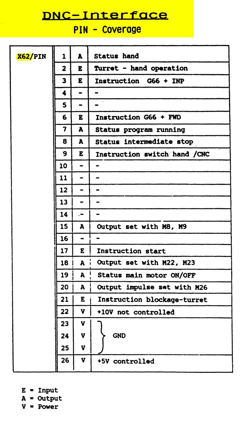

- mlw19mlw91
- Posts: 23
16 Nov 2021 00:03 #226610
by mlw19mlw91
Replied by mlw19mlw91 on topic Emco Compact 5 interface with linuxcnc (painless)
I can confirm that it does not work with my generation of EMCO compact 5. I've attached a pin out from my machine here:
The older machines seem to be different. I was able to activate some relevant options from the pinout sheet. I could get the tool changer to rotate, and I could switch it from CNC to hand operation. Could not do much else. The config file from earlier in this thread made the machine go haywire.
Not sure I can do anything at all with this generation of machine and the pin out information. There doesn't seem to be any info on how I would control this machine.
