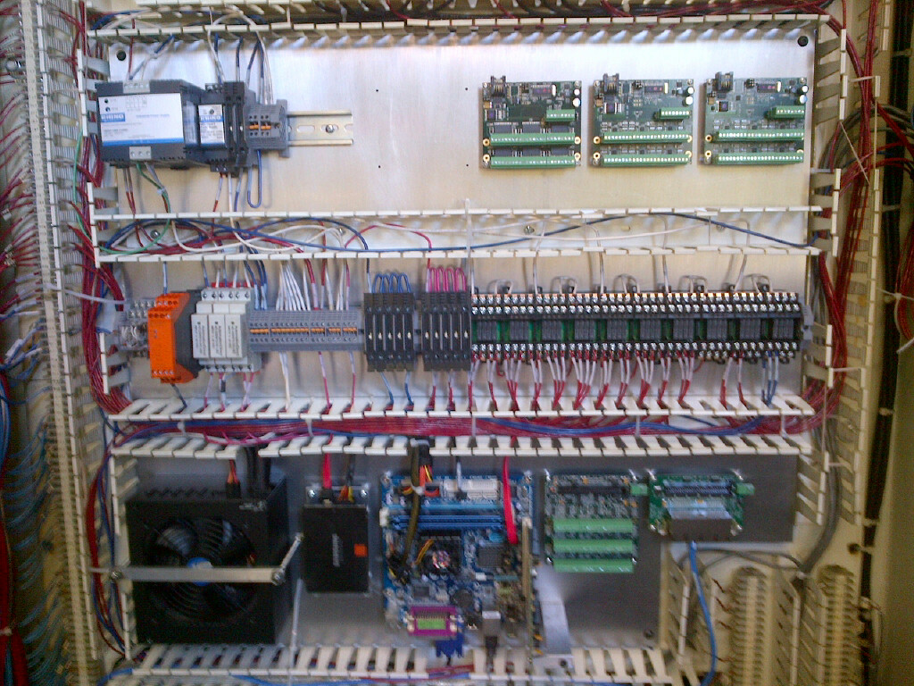

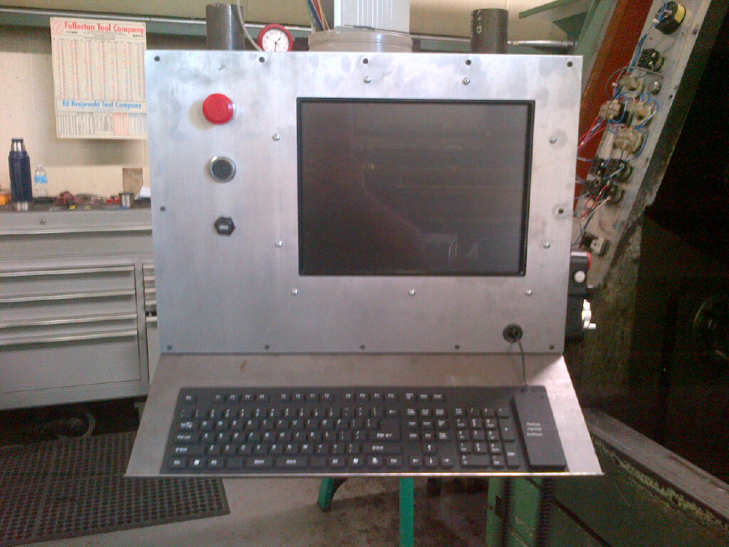

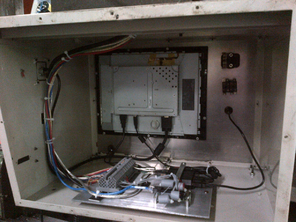

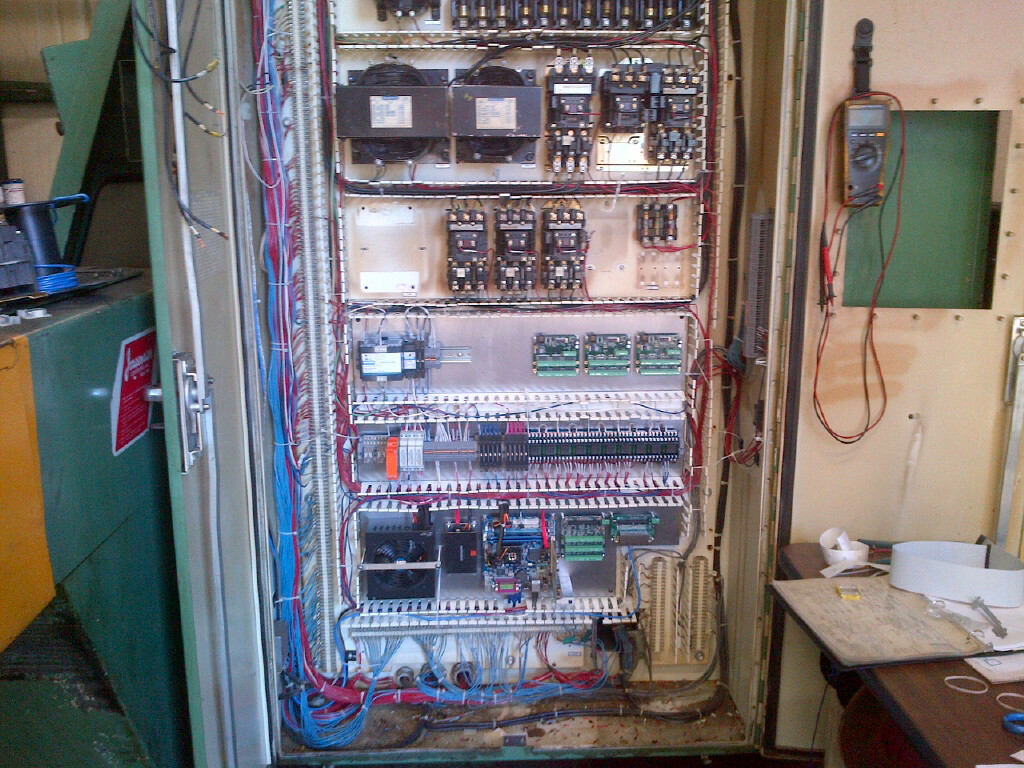

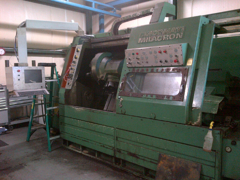

Here is a preview to our 3rd Linuxcnc retrofit, it is a 1980 12" x 60" Cincinnati Milacron with,
7 OD tools
7 ID tools
Programmable tailstock
Power chuck
30 HP spindle
Optional steadyrest
Machine weight: 30,800 lbs
Hopefully only 2-3 more weeks before putting it under power and start tuning.
Rick
7 OD tools
7 ID tools
Power chuck
30 HP spindle
Optional steadyrest
Rick

Replied by andypugh on topic Cincinnati Milacron 12"x60" Retrofit
That's a bit of a beast!
