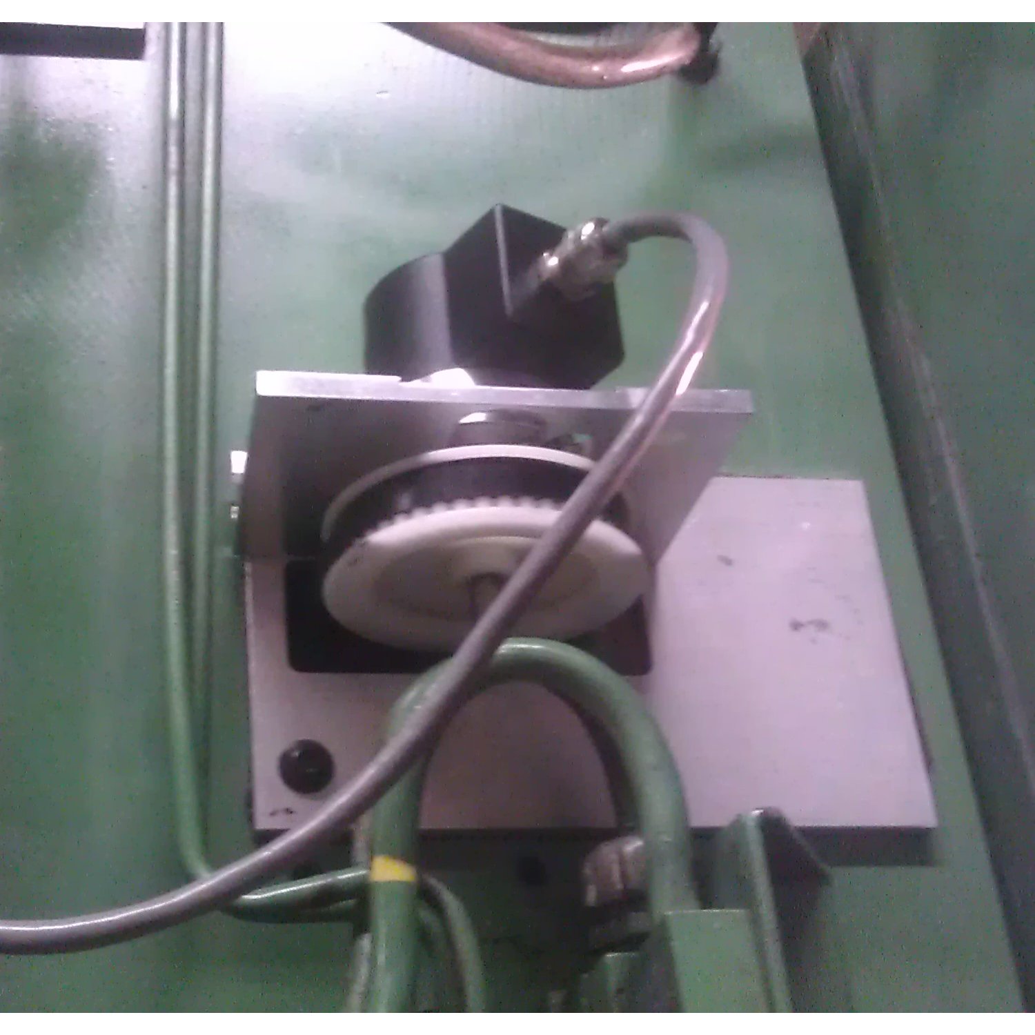

An alternative is to use a pneumatic cylinder with a relieving regulator. That gives a constant (and adjustable) force, and minimal extra inertia.
- JR1050
- Posts: 450
- Thank you received: 33
14 Jan 2014 12:37 #42746
by JR1050
Replied by JR1050 on topic Brown & Sharpe beast retrofit
I have some pictures, I need an sd card reader,as they pics are on my phone and I think the usb port is damaged. Ill try for tomorrow. The head really cant be counterweighted with a weight and sporockets like a Fadal, The colunm is a welded box and the top of it is not hollow, no place for the weight... pneumatic, gas charged or even a hydraulic cylinder have been used a counter balances. Right now Ill leave it as is, its been this way for 30 years!!

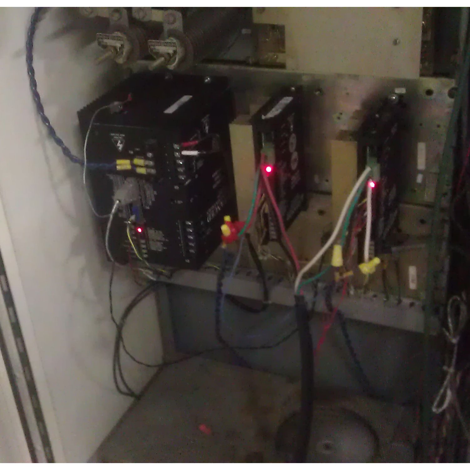

Ill look seriously at figuring out how to apply bias in the servo tuning. I still think the current loop needs tuning as the motor is noisy and spongy, in current mode(presently in velocity mode using the original tachs), its quiet, but seriously lacks power and is super sloppy. I talked with tech support at AMCI and they pretty much said the same thing. Im not exactly looking forward to the loop tuning, but I would like to know how, as Ive noticed the heavier the load a motor has to move, the spongy-er it becomes.

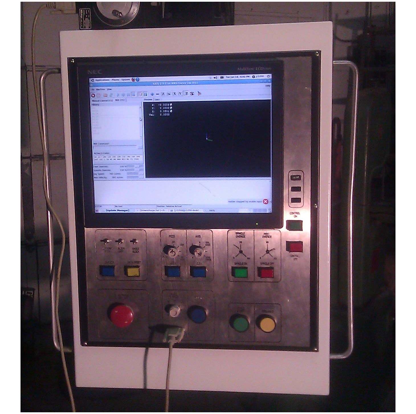

Super shakey video, sorry for the bad lighting....
- Posts: 23377
- Thank you received: 4966
15 Jan 2014 21:11 #42819
Replied by andypugh on topic Brown & Sharpe beast retrofit
Is that a touchscreen? If it is then I would suggest not using Axis, which is pretty fiddly with a touchscreen.
I am getting on pretty well with "Touchy" on my mill. I like the way that it tends to require an actual physical button press before doing most of the dangerous stuff.

Not a touchscreen, NEC 1560, plain old 15" flat screen. Durable, cheap and the right size!!! I agree with having the ability to interact with the machine with knobs,buttons ect wether they be real on on a touch screen. For running a very small machine, like a sherline, a mouse is ok, you cant do much damage and there is little risk of persersonal injury. On anything else, the mouse has gotta go. Id like to see a gui with tabs that can be switched with a real knob for modes and doesnt require a mouse. Its a matter of perspective I guess...

Hi, What are the other boards and modules on your panel please? Thanks
- JR1050
- Posts: 450
16 Jan 2014 07:38 #42854
by JR1050
The only board in the panel.is a mesa 7i84 serial i/ o board. The rest of it is just buttons, bcd encoders, connections to halui and a program to run it all.
