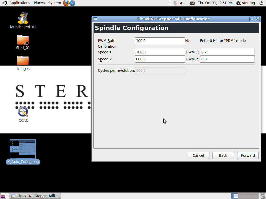

I built my CNC machine from a printed booklet a friend borrowed me.
The router I've attached is the Bosch PR10E "Colt" Palm router. It's a 1HP motor, with a fixed spindle that turns at 35,000 RPM.
Is there a calculator /reference sheet handy to determine what the feed rate I ought to be using based on the type of wood/router bit?
I had thought it would be a simple reference chart, but nay. However, after multiple searches, I did find something that made sense to me =
An excerpt from THIS page is below =
Calculate the test FEED by:
multiplying the diameter of the bit (D) by 0.02 to determine the CHIP LOAD (2% chip load)
multiply the CHIP LOAD by the number of flutes (F) on the cutter you are testing to determine the TOTAL CHIP LOAD
multiply the TOTAL CHIP LOAD by the SPEED (RPM) to calculate the FEED
in other words, FEED = D X 0.02 X F X SPEED
For example, a good test FEED for a 1/4" dia. 2-flute cutter with a SPEED of 12,500 RPM would be:
0.250 in. X 0.02 X 2 (flutes) X 12,500 RPM = 125 Inches Per Minute (IPM)
If the above is correct; then using my router at 35,000 RPM, the feed rate I'd be putting down in my preamble would be F350.
Is that so?
My stepper motors are three Xylotex 8s-3 units. I've pasted a screen shot of my Spindle Config screen =
So, based on this, will they go that fast? Is that what the 800 is for? Max speed? (Note; someone else set up the config, not me!)
01 Nov 2013 04:30 - 01 Nov 2013 17:36 #40469 by BigJohnT
Replied by BigJohnT on topic Feed speed clarification please...
If you have a fixed speed spindle all you can do is turn it on and off so PWM does not apply. Do you turn on your spindle with a switch or with M3?
There are two main things to consider when milling, SFM (Surface Feet per Minute) which is how fast the outer surface of the cutter or material in the case of a lathe is moving and chip load which is how much of a bite each toot takes for each cut. You don't say how many teeth your cutter has but less teeth means a slower feed rate.
For example from my feed speed spreadsheet
Tool Dia  0.25
Tooths  2
FPT  0.005
RPM  35000
IPM  350
SFM  2291

01 Nov 2013 05:00 #40471 by Sterling
Replied by Sterling on topic Feed speed clarification please...
I use the switch on the router itself to turn it on.
I'm using a 'double flute' bit (so that's "two teeth", right?)
01 Nov 2013 17:32 #40480 by BigJohnT
Yep, you have two teeth for your calculations.
If you use the switch on the router then no spindle related stuff is used by LinuxCNC.
