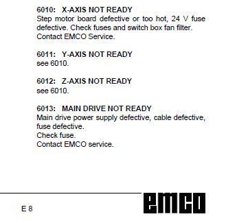

How about a step by step how you did it? Not everyone wants to retrofit a cnc machine just for fun. It is looking like my machine isn't going to make a proper thread as is.

Axis not ready is not an error message. Its all in the emco docs. You have to home the axes before you can do anything. This is a learning lathe sysrtem as supplied by emco. It emulates fanuc g-code as far as I remember. You should have an input device or you can home the axes via the dos prompt. If you dont have all the docs and read them it will be hard to learn to use the system as supplied. You need to decide what you want to do. Convert to linuxcnc or not....
This is not a trivial undertaking. Expect to take some time to read and learn. Help yourself then others will help you.
If you dont want to do that or enjoy doing that just buy a working machine...
Good luck and get started!
James

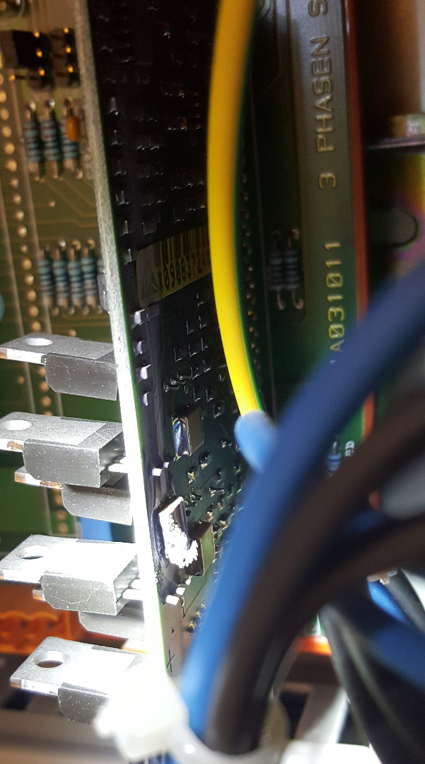

I'm still undecided, (I mean I don't want to gut the machine unless I need to) but I'm trying to figure out if this would work as a drop in replacement for the Emco Driver board. I would assume it's compatible with LinuxCNC.
www.leadshine.com/UploadFile/Down/3DM683m.pdf
These are like 60$ new.
