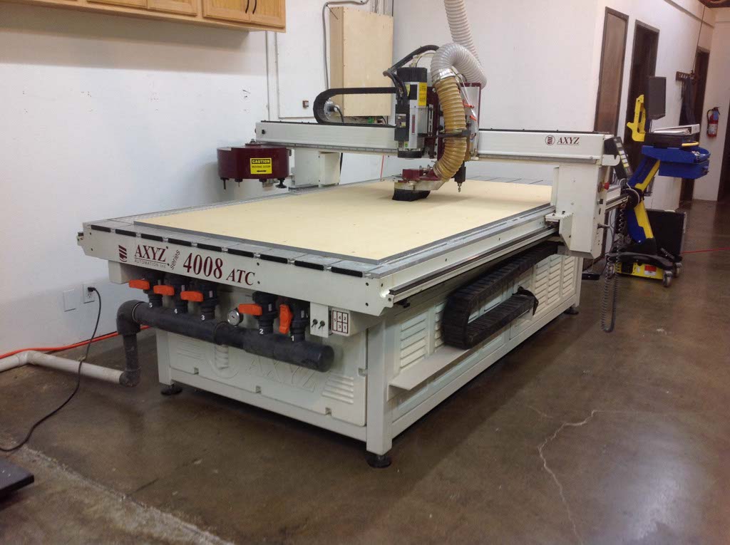

AXYZ 4008 ATC CNC router control retrofit
28 Mar 2014 04:14 #45327 by tsmutz5
Hello everyone.

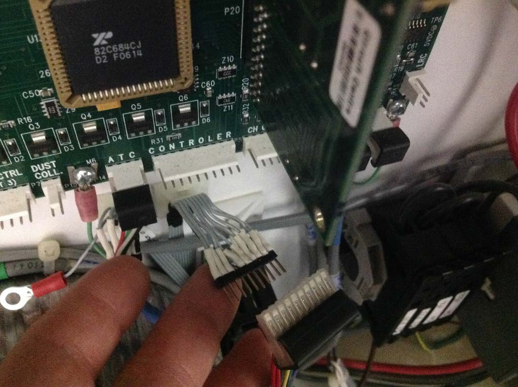

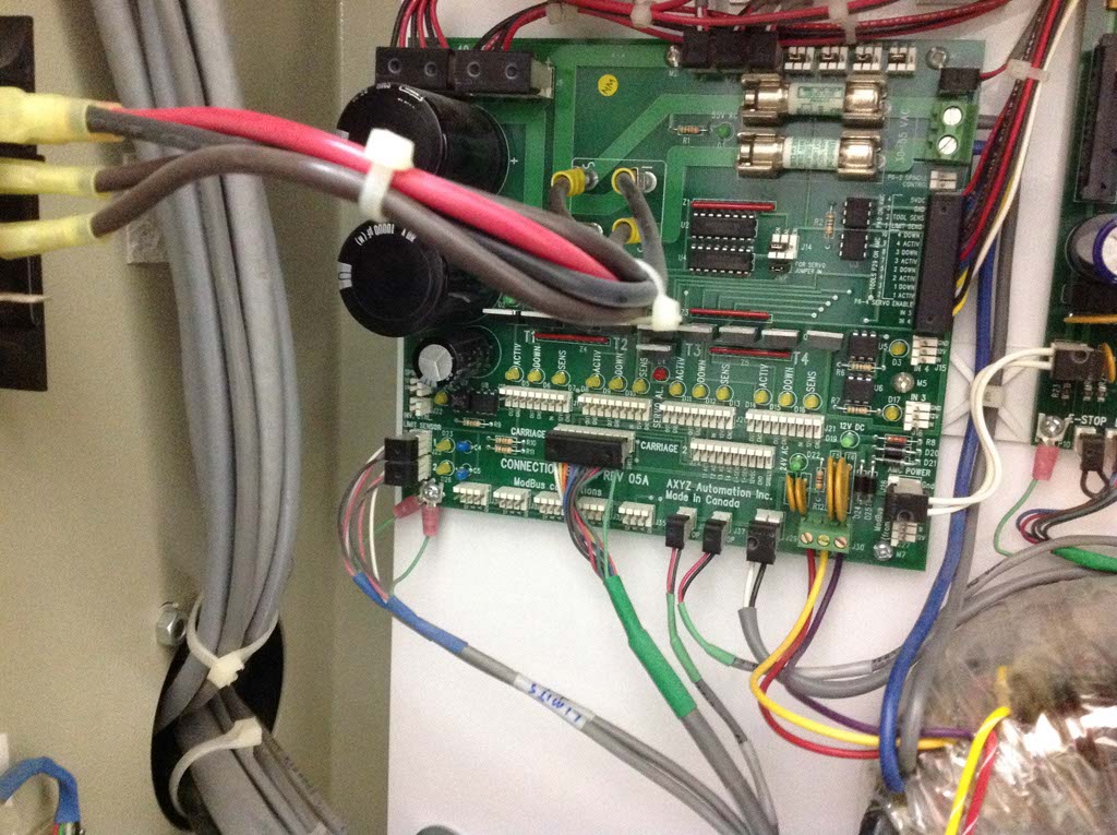

I’ve begun the process of retrofitting my router to Linuxcnc.

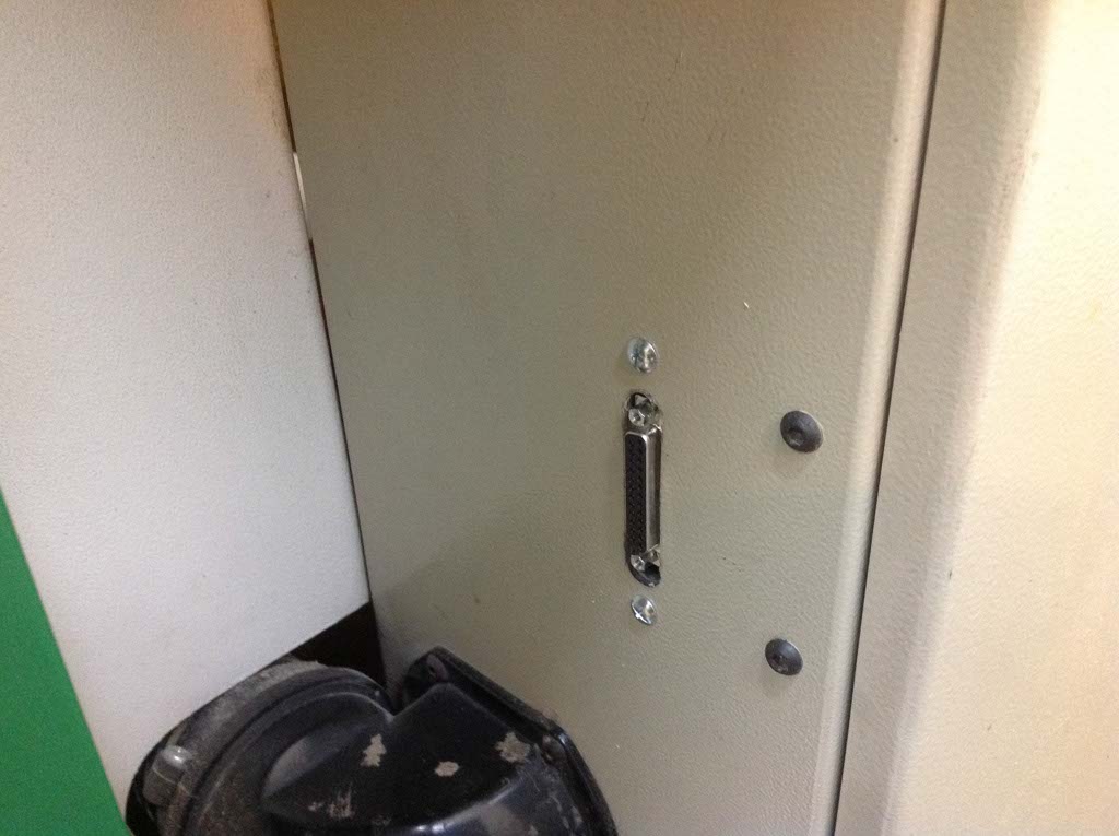

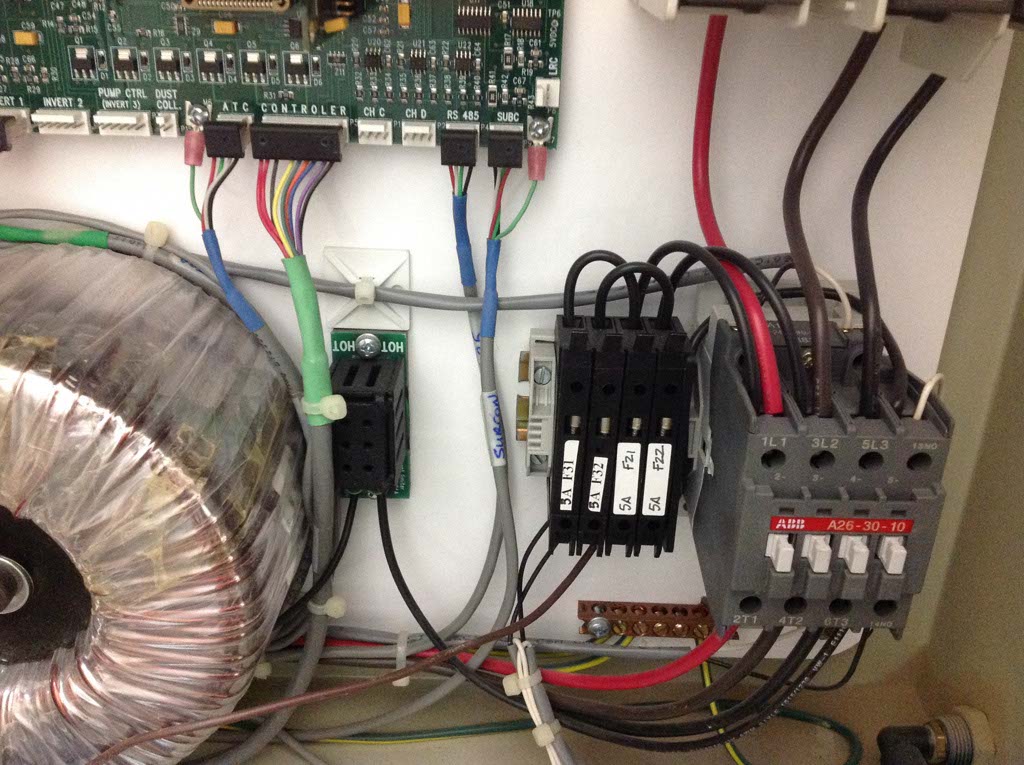

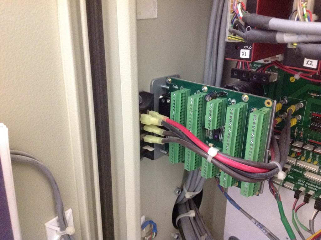

The way I’m doing the wiring is to patch into the OEM connectors so I can leave the existing control in place and functional until the Linuxcnc system is functional. Minimum downtime is essential as I use this machine for my business.
The OEM control system works ok but is definitely the limiting factor as the hardware is quite good.
The OEM control work flow goes like this, DXF- proprietary software “Toolpath”- file transfer to machine RAM. The downside of this is the Toolpath software is awful, very time consuming and basic machining strategies.
The other option is to use the no longer supported AXYZ DNC program and drip-feed the machine.
This works well as I can use g-code from CAM and the workflow is quick, the downside is curves and 3d work exceeds the look ahead of the DNC and causes stuttering and decreased cut quality.
Years ago I used Mach 3 on a small mill and was never happy with the stability of that system (a couple of random runaways can really sour your opinion of a motion control system).
I’m looking forward to learning Linuxcnc as I plan on using it for more applications in my business.
Hardware:
• HSD ES919A 10HP spindle
• Control Techniques Commander SE vfd (theservicegroup.us/wp-content/uploads/20...r-SE-Users-Guide.pdf)
• Teknic servo motors M-3482-FT-1 on X and Y axis (www.teknic.com/files/downloads/M-3482-FT.pdf)
• Teknic servo drives (step-dir) SST-1500-UCX for X and Y (www.teknic.com/files/downloads/Teknic_SS...em_Manual_Rev3.8.pdf)
• Pacific Scientific 6410 Stepper Drives on Z and ATC carousel (www.ahs-antriebstechnik.de/pdf-dateien-e...%20Drives/ma6410.pdf)
• Stepper motors on Z and ATC carousel
• Proximity sensors shared for home/limits (5 total)
• Pneumatic actuated drawbar on spindle
• Pneumatic actuated ATC door and dust shoe sharing the same pneumatic circuit
• Pneumatic actuated drill
• Low air pressure sensor
• Fixed tool touch off plate next to ATC for recording tool length offsets
• Moveable tool touch off plate for setting spoil board top surface
• HP dc7600 PC
• MESA 5i25-7i76
Here come loads of questions about how to get this thing running :)

I’ve made some progress on the retrofit.

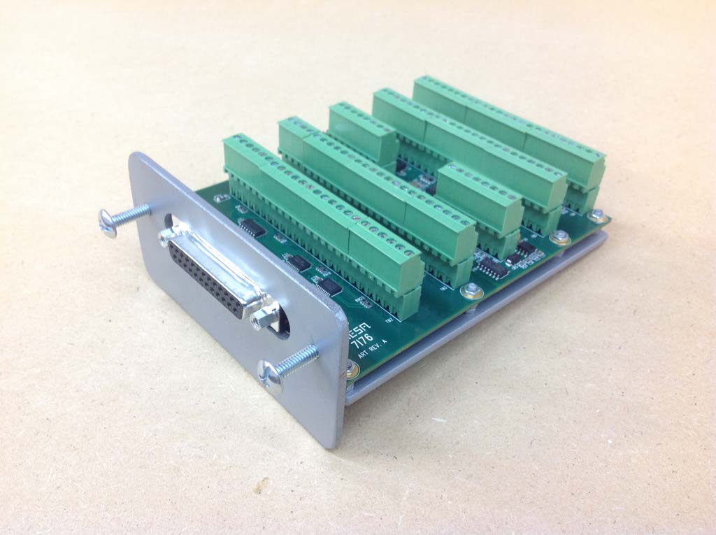

• 5i25 installed and talking to the 7i76.
• 7i76 mounted to control cabinet.

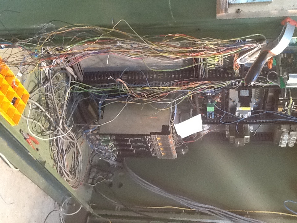

• Ribbon cable running from OEM connectors to 7i76.
• X, X1, Y, Z, A, wired to 7i76.
• Field power to 7i76.

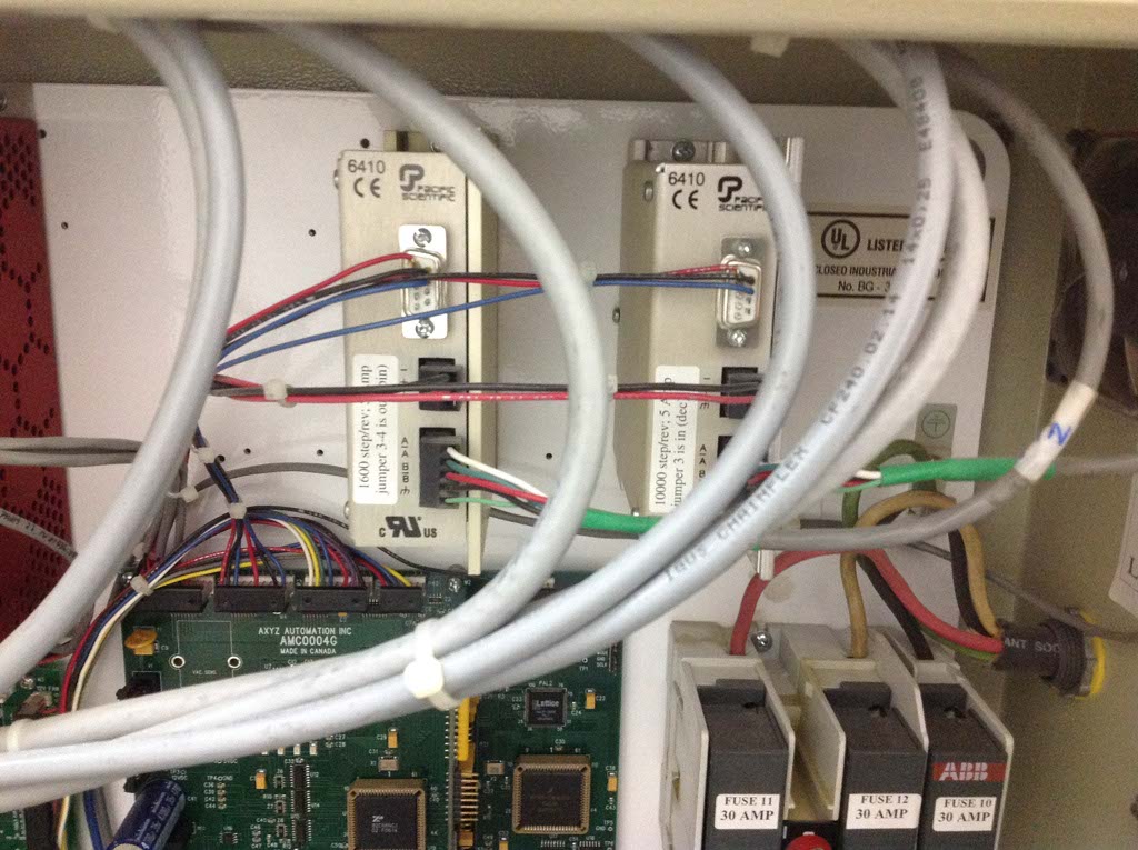

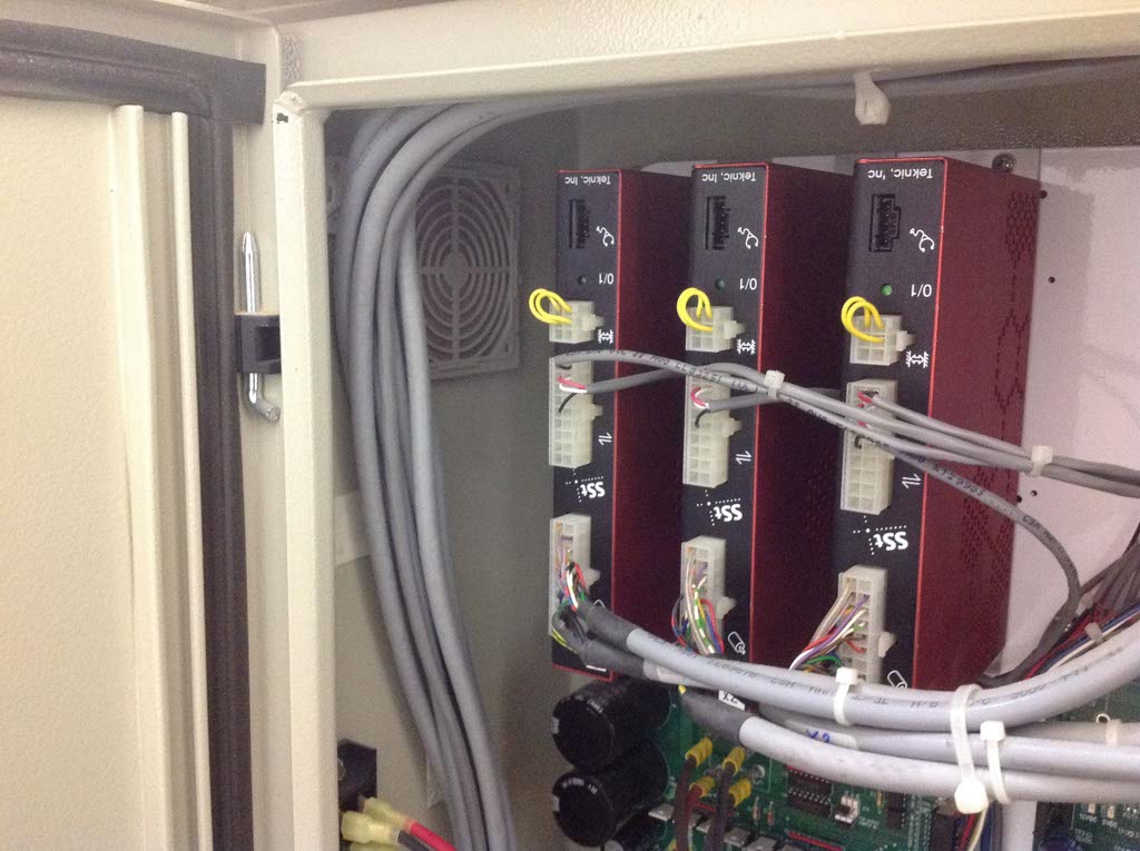

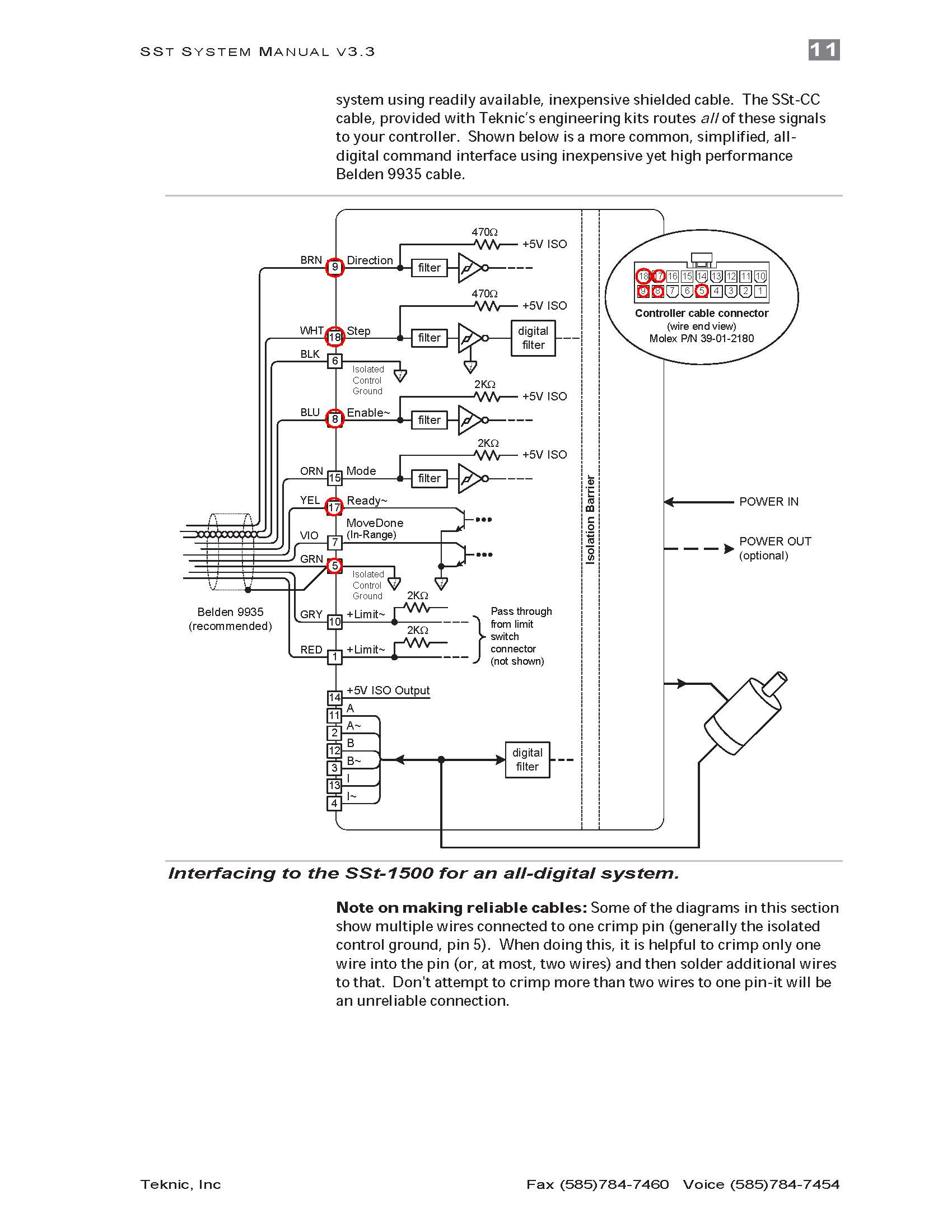

• (update: Fixed, was missing a jumper on stepper driver.) Motion on z axis when testing in PNCCONF but when switching from forward to reverse the axis only goes one way.
• No motion on X, X1, or Y. The OEM control only uses three pins (I think) to control the drives. Pins 18 and 9 go to the control board, pins 8,17,5 go to the power board.
How should this be wired to the 7i76?
This is from the drives manual
“DIRECTION POLARITY WIRING. With a standard motor cable the Direction line will have the following effect: With Direction at a high level, the motor will rotate clockwise (when viewing the shaft while facing the drive end of the motor) for each pulse of the Step line, and the internal position register (which is displayed by SSt-QuickSet's™ Status window) will decrement for each step pulse. When the Direction line is at a low level the motor will rotate counter-clockwise and the SSt servo drive’s internal position register will increment for each pulse of the Step line.”
Thanks for the help.

28 Mar 2014 09:09 #45330 by tsmutz5
Replied by tsmutz5 on topic AXYZ 4008 ATC CNC router control retrofit
Ok here's the update.
X, X1, Y, are moving. Pin 8 needs to be grounded to enable the drive. I metered the drives behavior on OEM control to determine this. Using a clip lead to ground pin 8 on the servo drive I can now jog in PNCCONF.

28 Mar 2014 18:54 #45343 by andypugh
Replied by andypugh on topic AXYZ 4008 ATC CNC router control retrofit
Is pin 8 something that I will connect to a gpio pin later on in HAL as a drive enable function?
Yes. I think that the 5i25/7i76 IO is high-impedence when unpowered so it will work properly (and safely). If the power-off behaviour isn't right then you might need a mechanical relay, crude though that sounds.

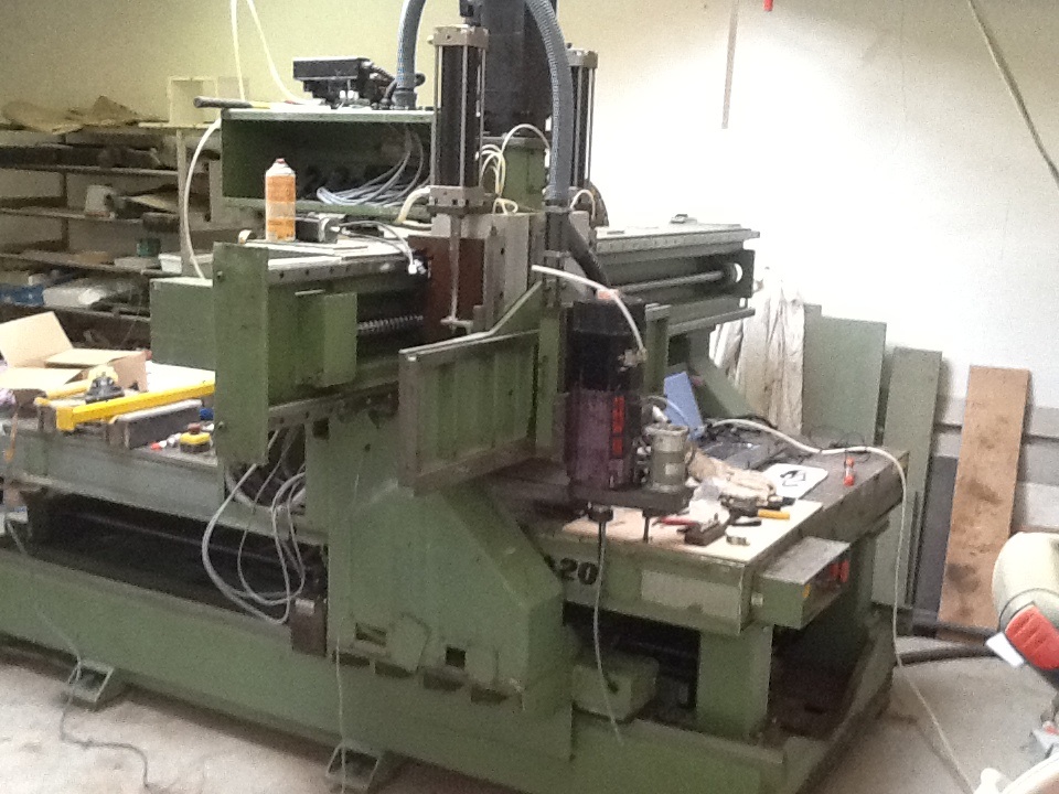

This is a nice machine !
I have done a similar job on an Industiral router same size.

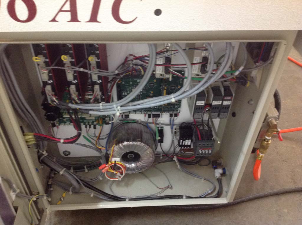

Here are a few pictures of my ATC.
File Attachment:
File Name: ATChomestuds1.pdf
File Size:868 KB
It’s a stepper driven carousel type tool changer that is mounted to the X-axis gantry with a proximity sensor 180 deg from the current tool selected with studs for ATC home and at every tool location. The ATC detects the home stud by the distance from one pulse to the next is closer together than all others (around 1250 steps between tool studs). Once homed the ATC goes to the required number of steps to tool “?” hits the sensor, and then backs off till the sensor goes off then the tool change routine continues.

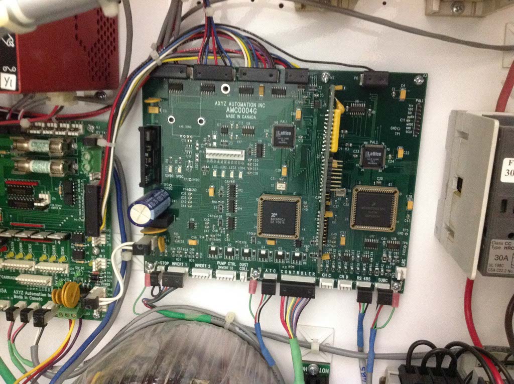

I still have to figure out the spindle control.

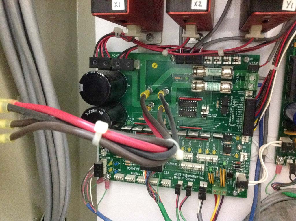

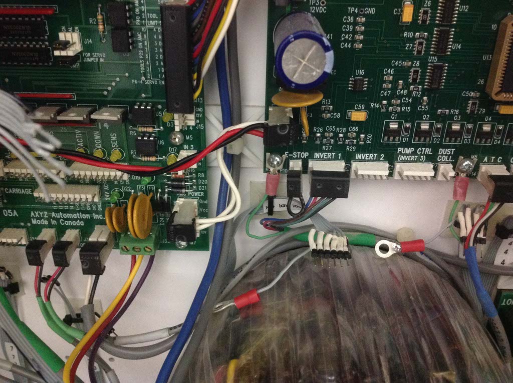

I attached the OEM control board diagram and highlighted the “inverter 1” section.
On OEM control the control mode is referred to as “tach” which has a zero speed indicator coming from the spindle to the inverter so that the tool change doesn’t start with a tool still spinning down.
I’m not sure how to bring this all together on the 7i76 and Linuxcnc.

That’s some heavy looking iron you’ve got there! What kind of machine is it?
