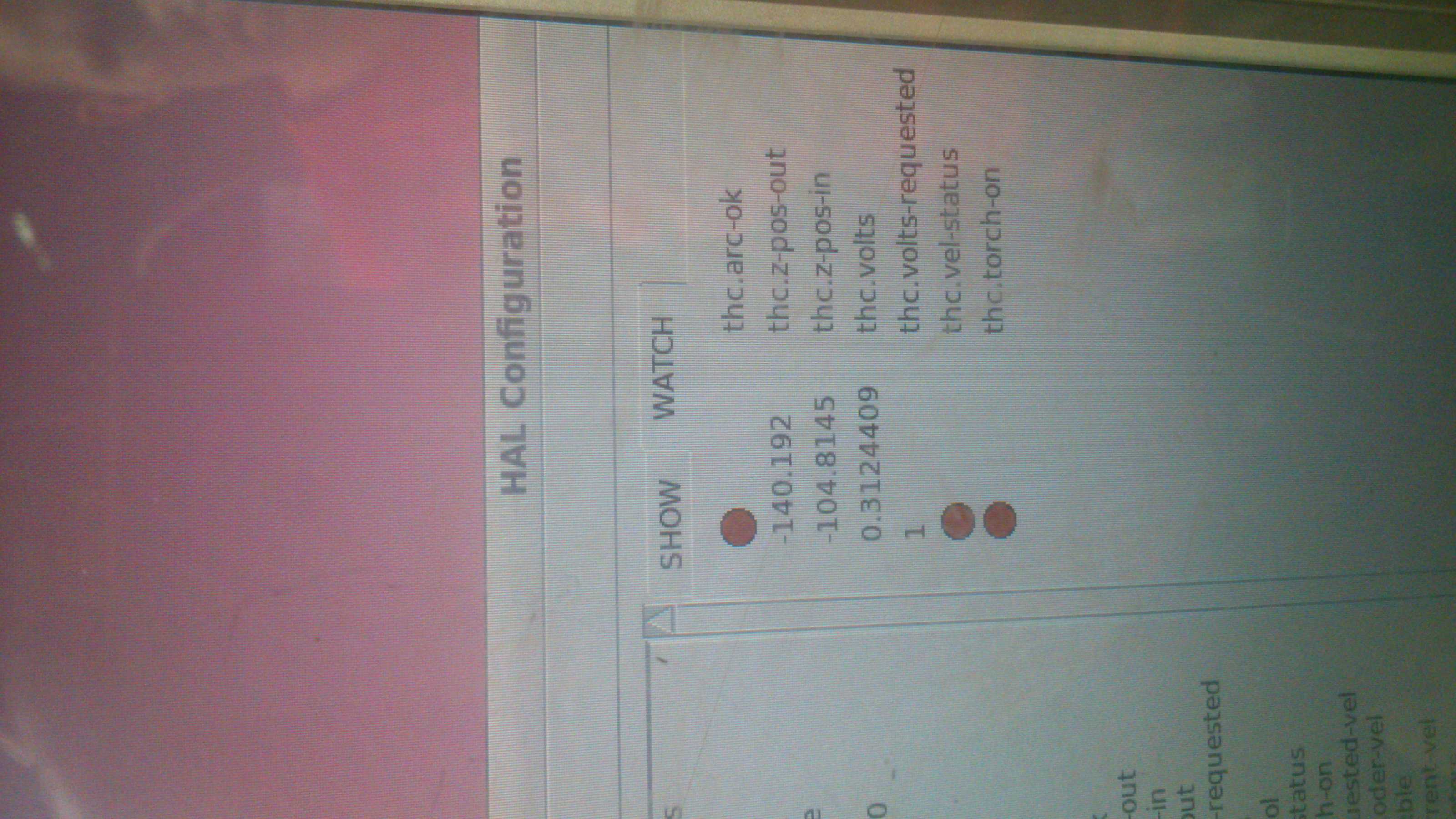

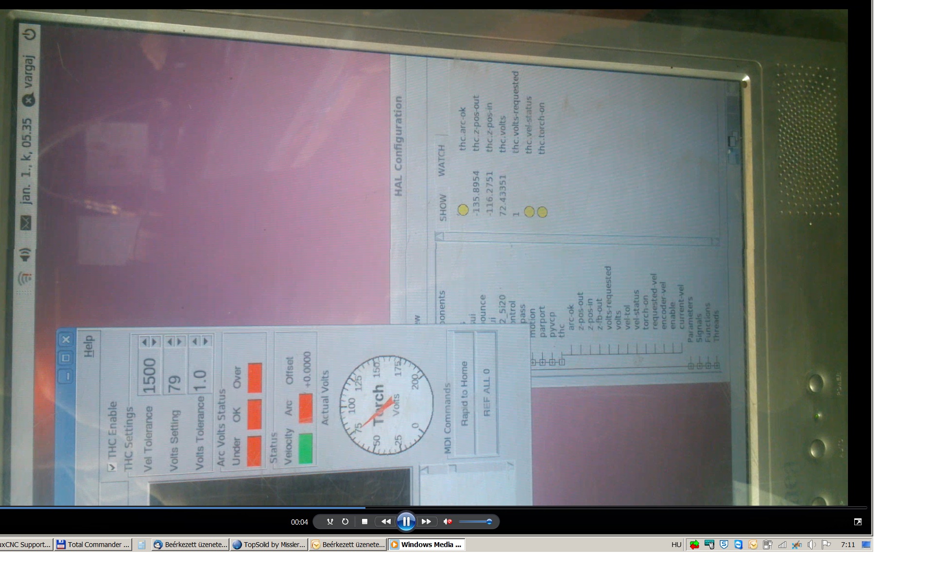

08 Jul 2014 12:18 #48520 by bokorugro_111
Replied by bokorugro_111 on topic THC problem
Hello!
I attached two picture.
Screenshot_1 is made during the cutting.
The other is showed that if I disable THC and enable again the Zpos-in and Zpos-out will be different. Is it correct?
I tried to set the voltage tolerance 50, but the head also go down.
Thanks!
Csaba
08 Jul 2014 17:44 #48526 by Rick G
Replied by Rick G on topic THC problem
Well in screen shot 1 the thc volts requested on the screen shows 1 volt.
Rick G

08 Jul 2014 17:55 - 08 Jul 2014 18:00 #48528 by bokorugro_111
First I had made a screenshot from a trial cutting (with 1V voltage tolerance) as PCW ask.
Than I made another test with 50 voltage tolerance.
Sorry for my inaccuracy!
Last edit: 08 Jul 2014 18:00 by bokorugro_111.
08 Jul 2014 18:14 #48532 by BigJohnT
Replied by BigJohnT on topic THC problem
Looking at your screen shots you have volts tolerance connected to volts requested in your HAL file and that is not correct.
JT
