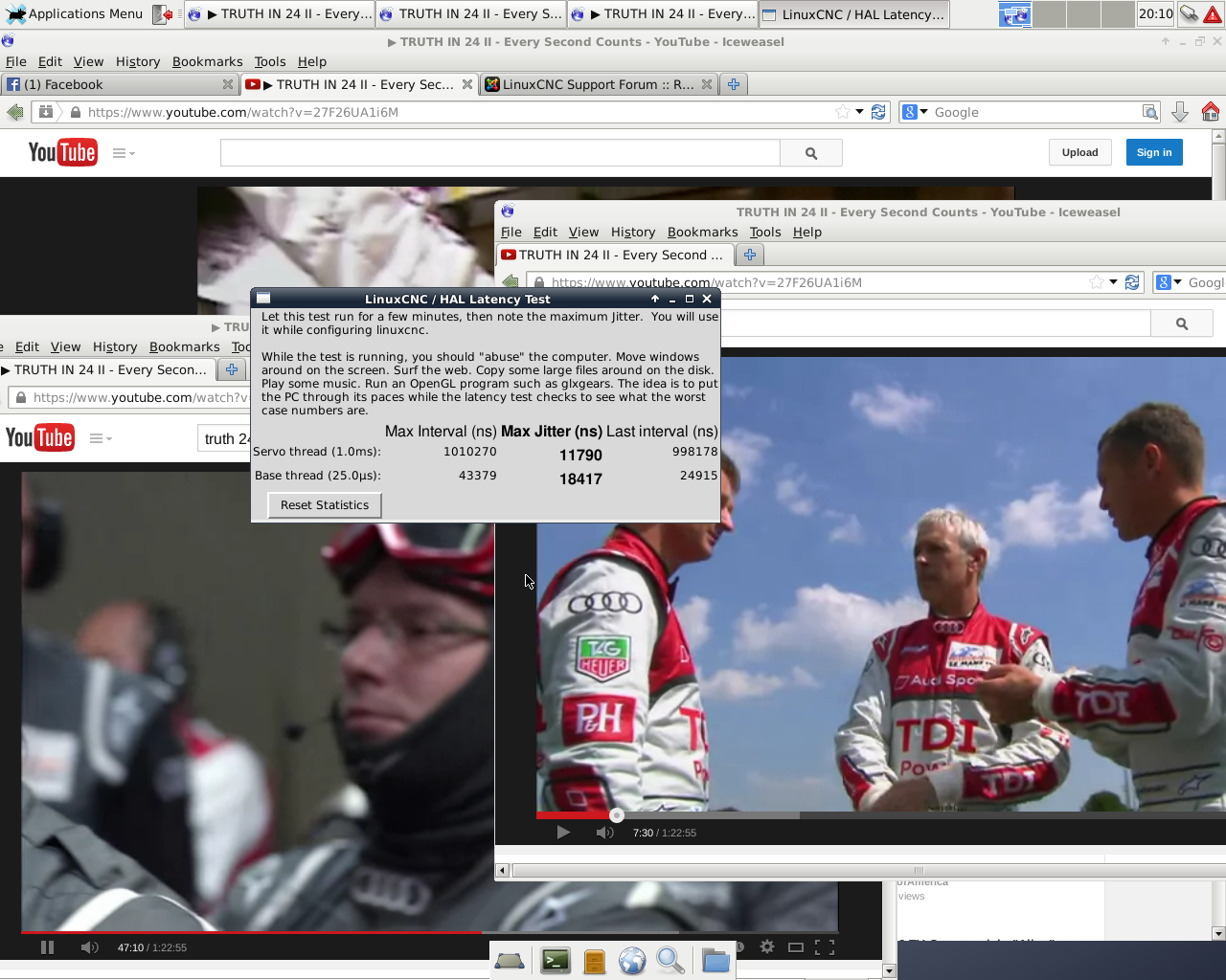

I have installed the latest 2.6 from the latest ISO on wheezy..
So far works great , hope to have my Mesa hardware sometime this week.
One thing i noticed my latency test is half of what it was .
