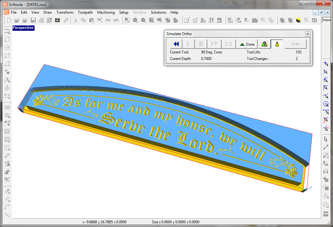

This is one of the things I do at work.
We use mostly 90 degree V-grooving bits for most of our carving. But For smaller fine detail work like what would probably be on a coaster, a 60 degree bit might be a better choice.
The best off the shelf bits I have found so far for v-groove carving are carbide insert bits made for doing miter fold box joints. We use mostly tooling by Vortex, but other companies have similar products.
Before we found the insert tooling we had been using other carbide tipped v-groove bits. None of which were ever good enough off the shelf when new, and would require regrinding and hand sharpening to make them good enough. (I used to have to spend an hour or two hand sharpening tools every day or two) Did I mention we do a lot of this type of wood carving.
The biggest secret to carving this stuff though is getting a good cam software that can do the 2.5-D V-groove and or prismatic tool pathing. They are kind of opposite in appearance but the tool paths are very different.
