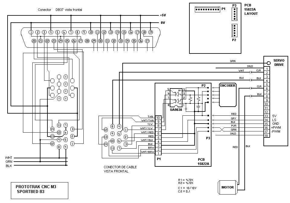

28 Sep 2016 14:54 #81040
by vsidon
Hi andypugh.
It's just like PCW says previously "differential PWM in locked antiphase mode" .
According with the schematics by jardomi :
and I can see in the servo driver, it have 2 input signals -pwm and +pwm running at 15Khz (No 15 Mhz sorry for that).And it have 3 more input pins and they're marked like LS (Limit Switch I guess), 5v (circuit power supply) and the inputs for the motor.
So, I suppose that techrat or jrjone have that kind of configuration. I guess that I need some files to "upload" to the MESA 5i25.
Thank you for you quickly response.
Replied by vsidon on topic Proto Trak MX3 Retrofit - Which Boards Mesa?
Its probably differential PWM in locked antiphase mode (50% = 0 drive),
and I think these drives are disabled by shutting off the PWM
Probably drivable with a 5I25 and a 7I85S with maybe a 7I84 added for GPIO
Hi andypugh.

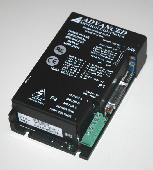

09 Jan 2017 20:38 #85546
by vsidon
Hi everyone.
Recently, I've working again with this project. I talked with Jeff about his configuration files, setups and other stuff, but he say me that he still working on the documentation, So I have to wait .
At this moment I have the computer running LinuxCNC with 5i25 and 7i85s (not connected yet) . But I was thinking that my servo amps (original prototrak) maybe work or maybe not.
So, this is the question.
What is the best option (performance/price) for new servo drives?
Is the Gecko 320x an option?
Is the Advanced Motion Controls servo drive an option?
If I buy one of those drivers, they will work with my current combination 5i25 +7i85s?

17 Jan 2017 13:33 #85917
Replied by andypugh on topic Proto Trak MX3 Retrofit - Which Boards Mesa?
The G320X is for brushed servo motors, and takes step-dir inputs. If the motors are brushless it won't work.
The AMC drive is for three-phase brushless, and could work, but you would need to commutate in software and provide the 2 PWM phases (just like the existing drives).
There are alternative drives from AMC that take different command types, some of which commutate in the drive, relying on Hall sensors in the motor.
Do you know what outputs your motors have?

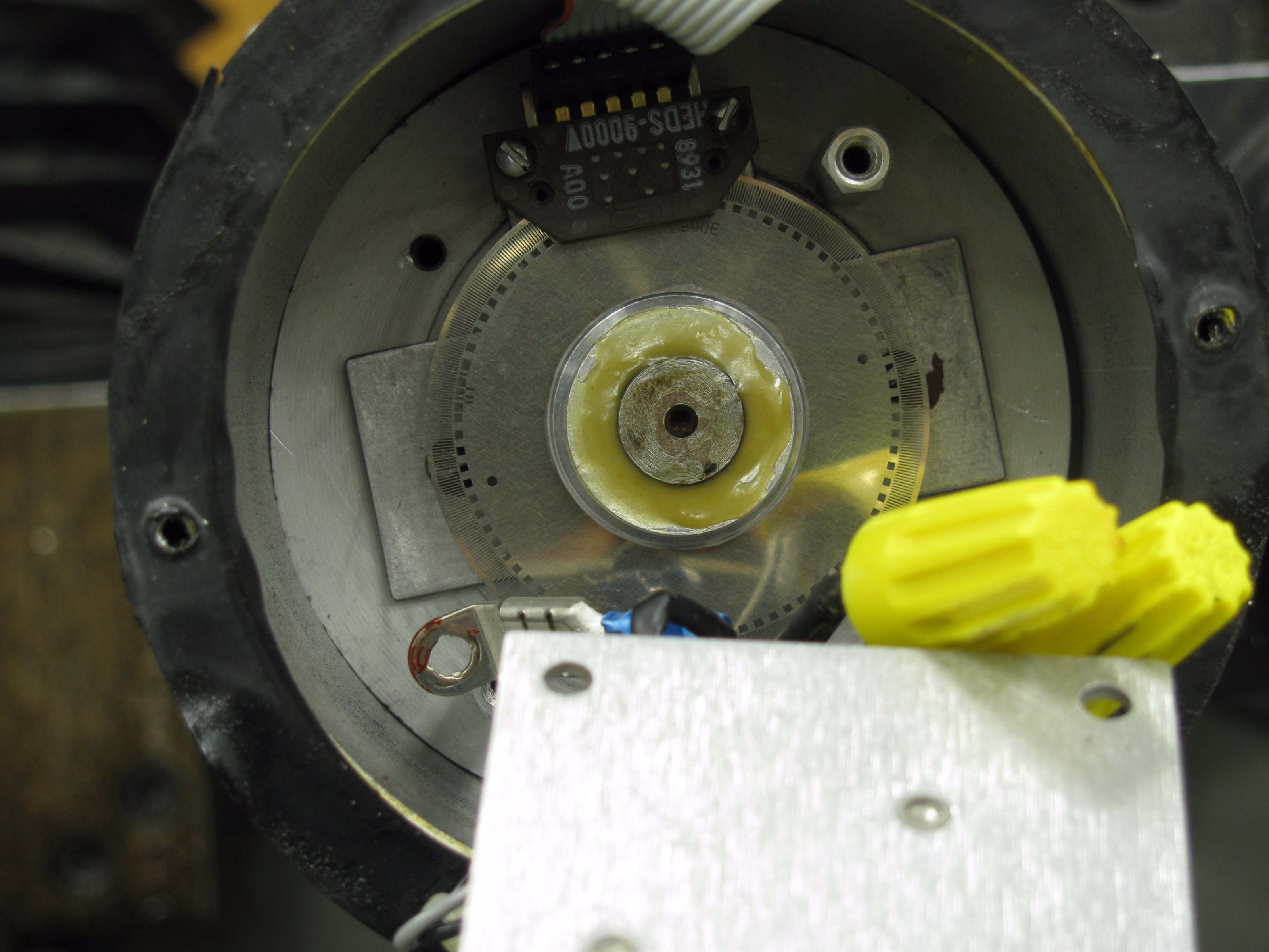

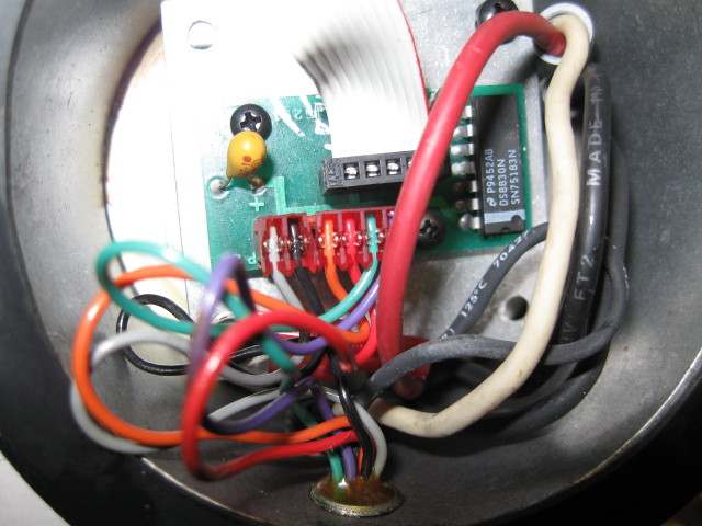

20 Jan 2017 18:11 #86267
Whats the black wire? I see red, white and black?
The encoder seems to be one of these: uk.farnell.com/broadcom-limited/heds-900...00ppr-2ch/dp/1654866 or very similar.
If it really is 2-channel without an index then I think that the motor _must_ be DC.
