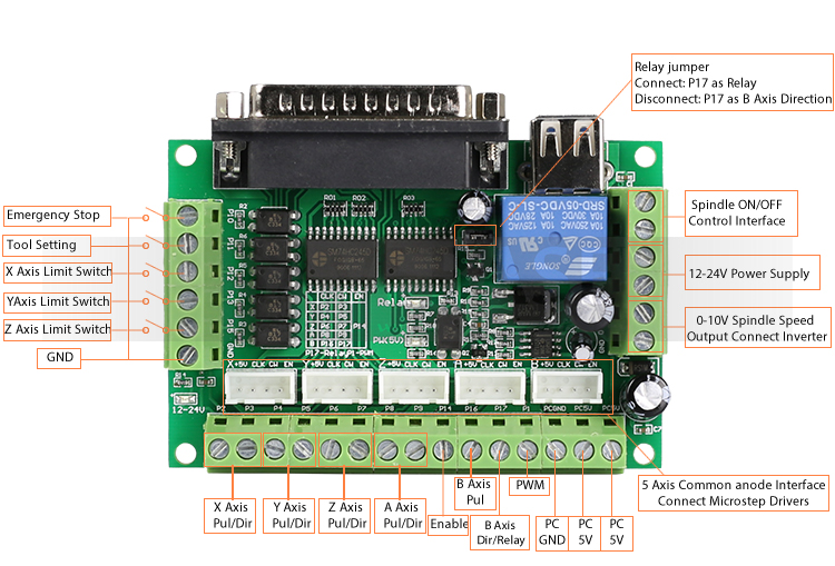

I'm retrofitting my cnc with a Mach3 break out board and I need a little help since Ive never done anything like this before.
This is the breakout board I'm using: www.gbeshop.com/InfoBase/SAVEBASE/PKG/00...erfaces_fw_r2_c1.jpg
www.gbeshop.com/InfoBase/SAVEBASE/PKG/00...diagram_fw_r2_c1.jpg
1: The proximity switches on my machine are these: www.ia.omron.com/product/item/tlq_2001e/ The blue and brown wires are connected in parallel along all the sensors so I assume that one of them is common. The black runs back to the board for each one so have connected them to the X/Y/Z Axis Limit Switch spots on the left of the board respectively. I assume that one of the others (blue I think) would be ground. The brown would be voltage input? I have connected it directly to 5v. Does this sound correct?

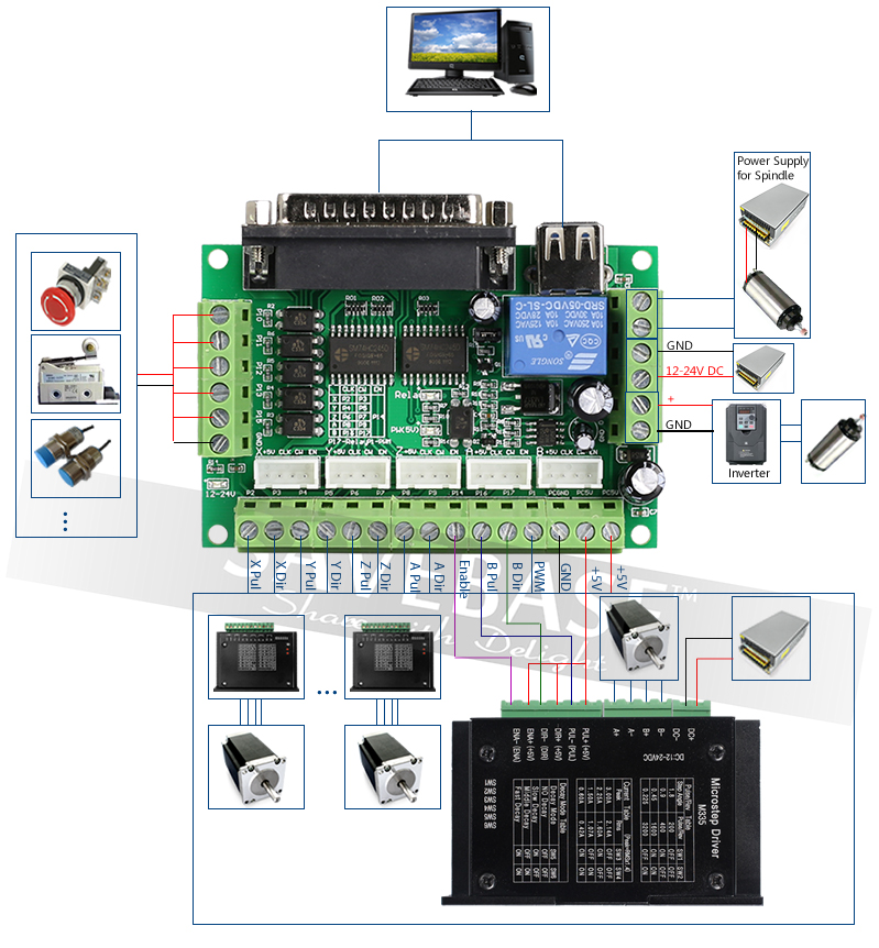

Do I still need to wire something into the 0-10Vspindle speed Output Connect? There where only two wires running into the inverter, one into pin 7 - FWD and one into COM. I have just wired those two into the Spindle ON/OFF Control interface at the top right of the break out board. Is this correct?

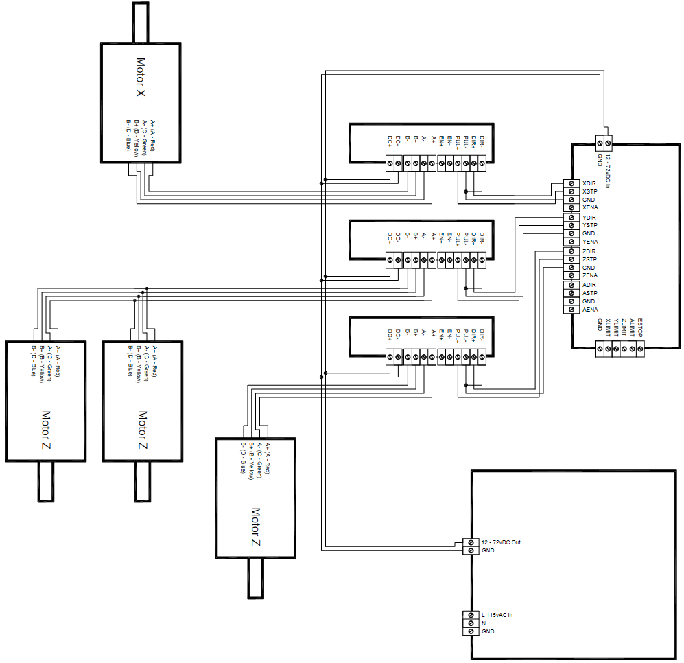

4: The stepper controllers had the white plugs on them so I have just plugged them into the "5 Axis Common Anode Interface ...." slots above the bottom row of pins, do I need to run any additional wiring to the controllers?

help.
Your omoron proximity switches connect between +5V and your breakout board input.
some proximity sensors are 2 wire and some are 3 , if they are marked + & - then they go to the 5v and gnd and the third wire is the switched input to the breakout board
Brown = +5v
Blue = 0v
Black = input to bob

yes you can ,
attached is a schematic of how you should have the steppers wired
