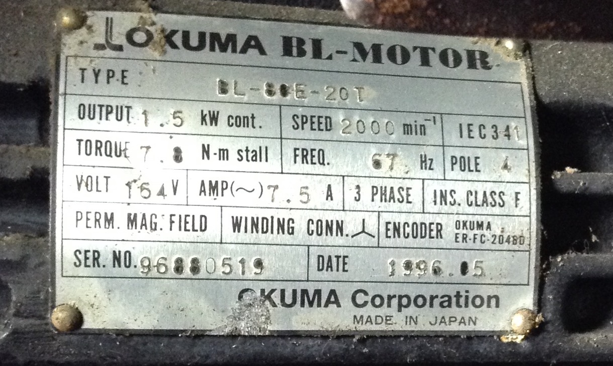

If I could figure out how to reuse the servos, either with the drives or with different drives that would my first choice. Is replacing the encoders an option?
2nd choice would be selling the drives and motors and finding suitable replacement servos that are easier to drive.

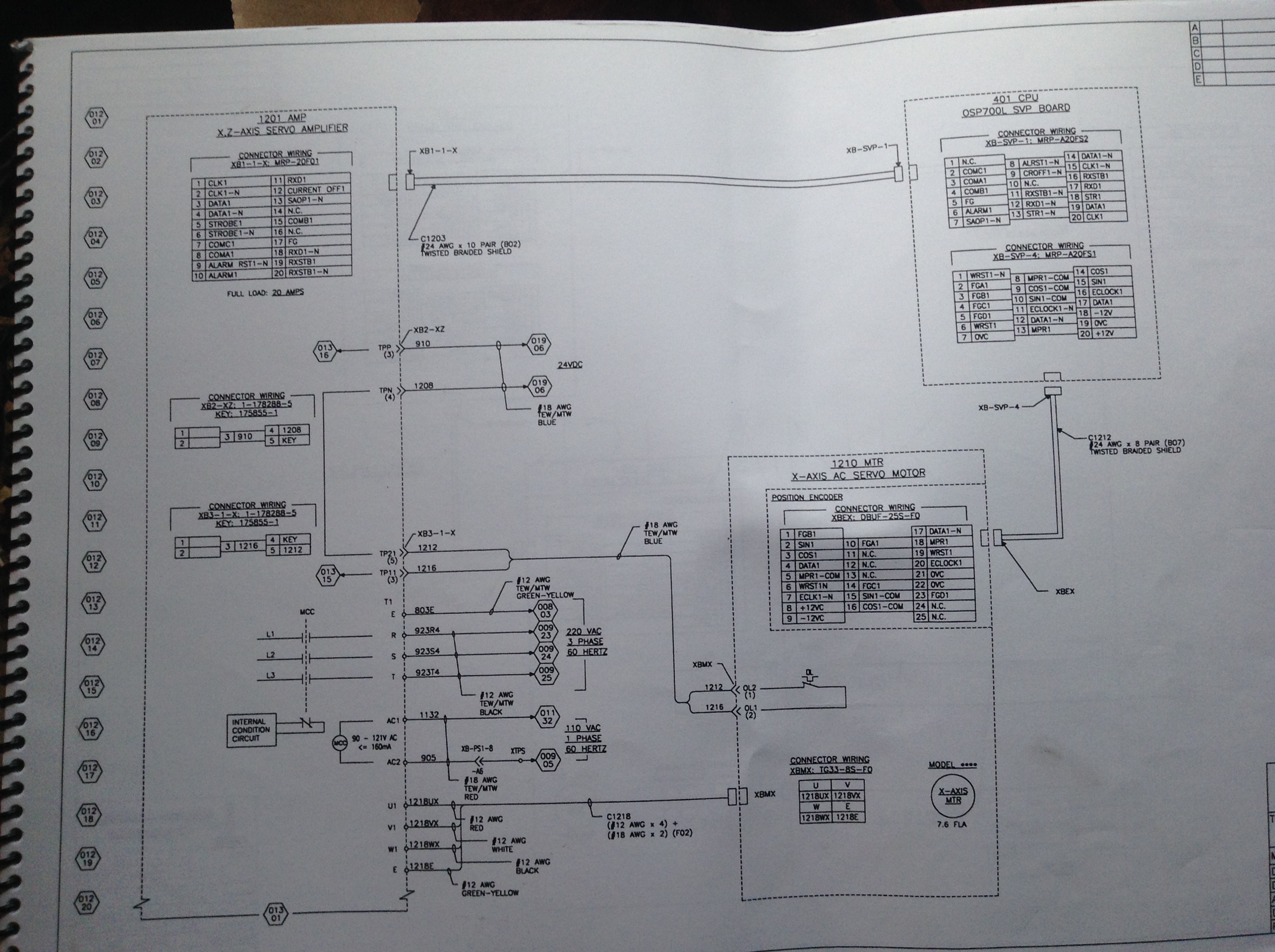

- Posts: 19899
07 Oct 2015 17:11 #63533
Replied by andypugh on topic Okuma lathe conversion.
It is starting to look not 100% trivial...
It looks like sin/cos encoders converted to a serial data format by the OSP700L board. That also seems to create 3 commutation signals (COMA1, COMB1, COMC1)
That diagram doesn't seem to show where the motion controller connects to the servo amplifier?

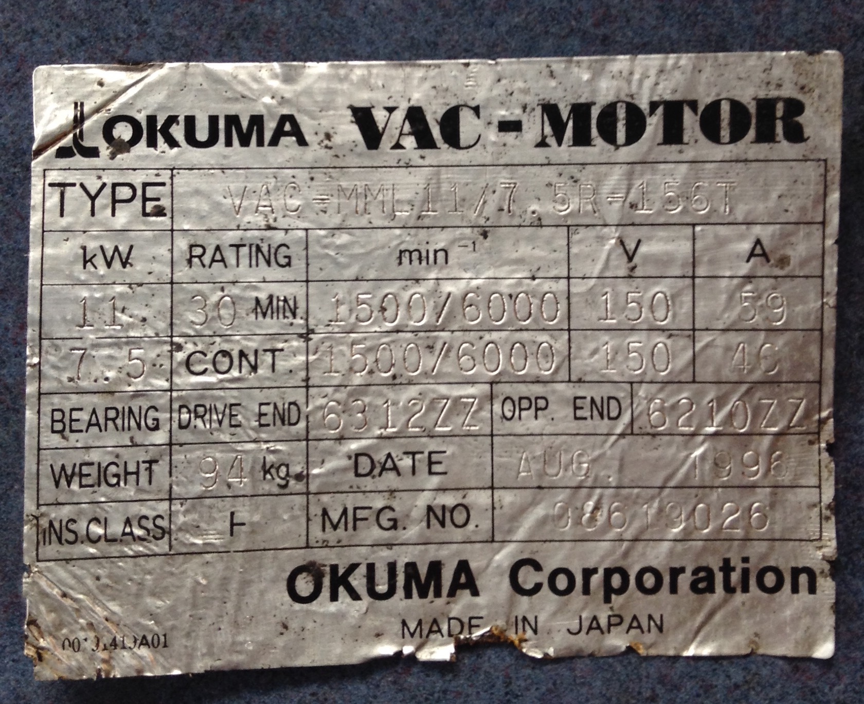

I think I am going to look for new servos with usable encoders as the motors and drives probably have some value.
Is there a standard for servo motor mounts (Nema?) Bolt pattern looks to be about 150mm.
Are all Fanuc Red cap motors usable with the pico adapter?
Here is the Servo I have.
When looking for a new servo What is the most important to look for? Output,torque,rpm?
Just ordered some mesa cards - 5i25, 7i77, 7i69
