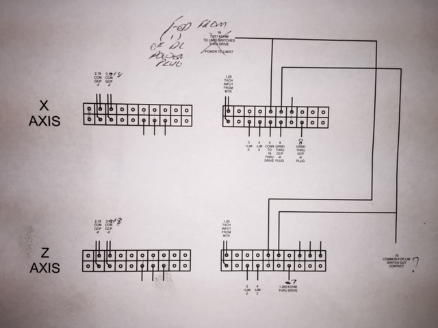

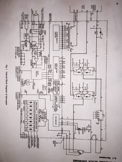

27 Dec 2015 00:07 #67355
by djs14
Ok that was a good thought but still doesn't seem to make any sense. I've attached a few pics. One of them is a cad drawing I made of the plugs to try and make sense of multi-meter readings to various schematics. I actually have a machine schematic also which I will post to see if there's something in there that makes sense of all this. Unfortunately the manual with this machine schematic is for a yasnac 2000b control but it has a different CPU than my machine, so a lot of the wiring schematics are useless. I was hoping the drives would make sense but they're not... same problem as other gent that posted with 2 x 20 pin input plugs.
Thanks for any help or suggestions!
Replied by djs14 on topic Input Wiring Yaskawa Servopack for Miyano lathe
]7 wires in one plug, 10 wires in the other, and they are 20 pin plugs.
But is there any overlap in populated pins between the plugs?
ie, is it possible that each pin has the function allocated to that position in the single 20 pin plug?

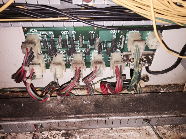

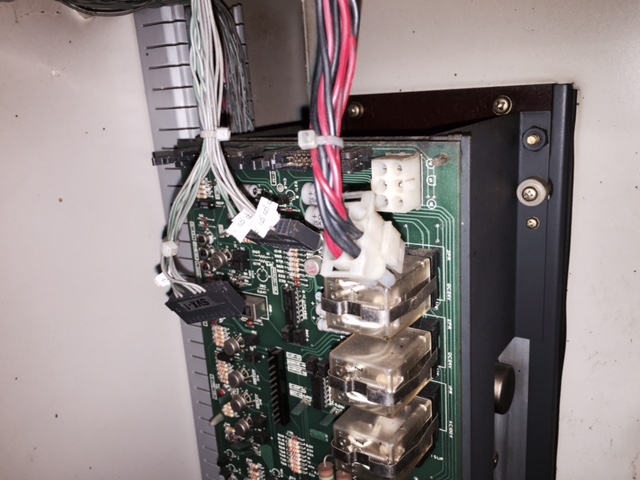

27 Dec 2015 00:18 #67356
by djs14
I did not see the power plug pictured above on any of the schematics. I was expecting it to trace to the main power supply but I think it goes to this power supply in pic. I have seen no documentation for this one, and it's not obvious where the power goes in. The large gauge wires that are visible are all ground wires. As I mentioned in first post I wanted to power up the drives. I was hoping I could just use a stand alone power supply for any DC voltage the drive needed. It's a bummer my machine schematics aren't better, but they did show the limit switches wired into the drive that no other diagrams were showing. I will take a pic and post that.
Oh and I also noticed the input plugs were not identical in wiring for X and Z drives. This can be seen on the plug schematic I posted on previous post. Sorry my post is rambling ... just trying to get some thoughts clarified to figure out what to do next.
