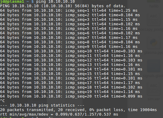

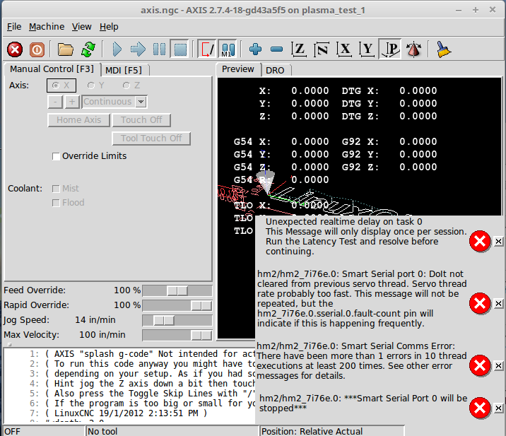

Well I have made some progress here. I have no apparent problems communicating to the 7I76E board now. I have managed to use Pncconf to get working .ini and .hal files that use the gantry component and appear to work. Axis will start with some errors, see attached screen shot.
I am not sure about the serial port error as don't recall configuring one, should I just comment out all references to serial ports in the hal file?
The servo timing error is a bigger concern. I tried to look at a few things but couldn't find anything obvious. Here is what I looked at.

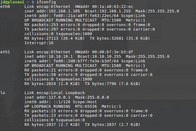

The 7I77E is on eth1. Eth0 is connected to network.
I find the delay about every other ping troubling but don't know what, why or how to fix.
I think this is the last little bit that is needed to understand what is going on.
John

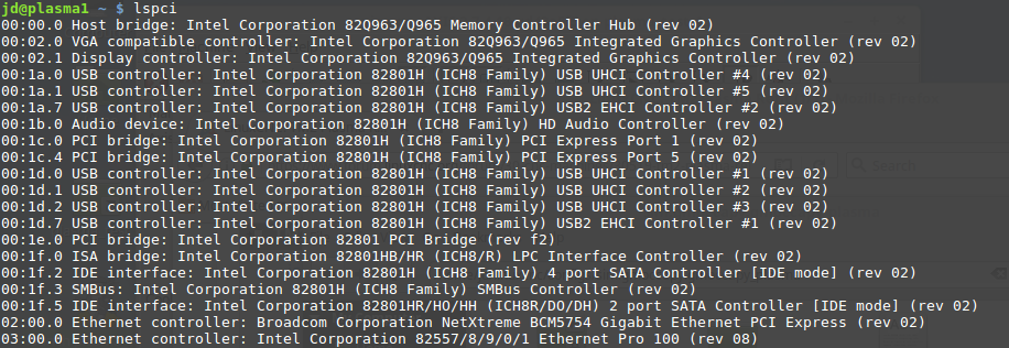

It looks like you have BroadCOM and a Intel MAC in the system
Which MAC is connected to the 7I76E?
I don't recommend using the Broadcom MAC for real time
The Intel MAC should work, but for best performance you will have to turn off IRQ coalescing:
sudo ethtool -C eth1 rx-usecs 0
( BTW, the sserial error is a side effect of broken servo thread timing )
