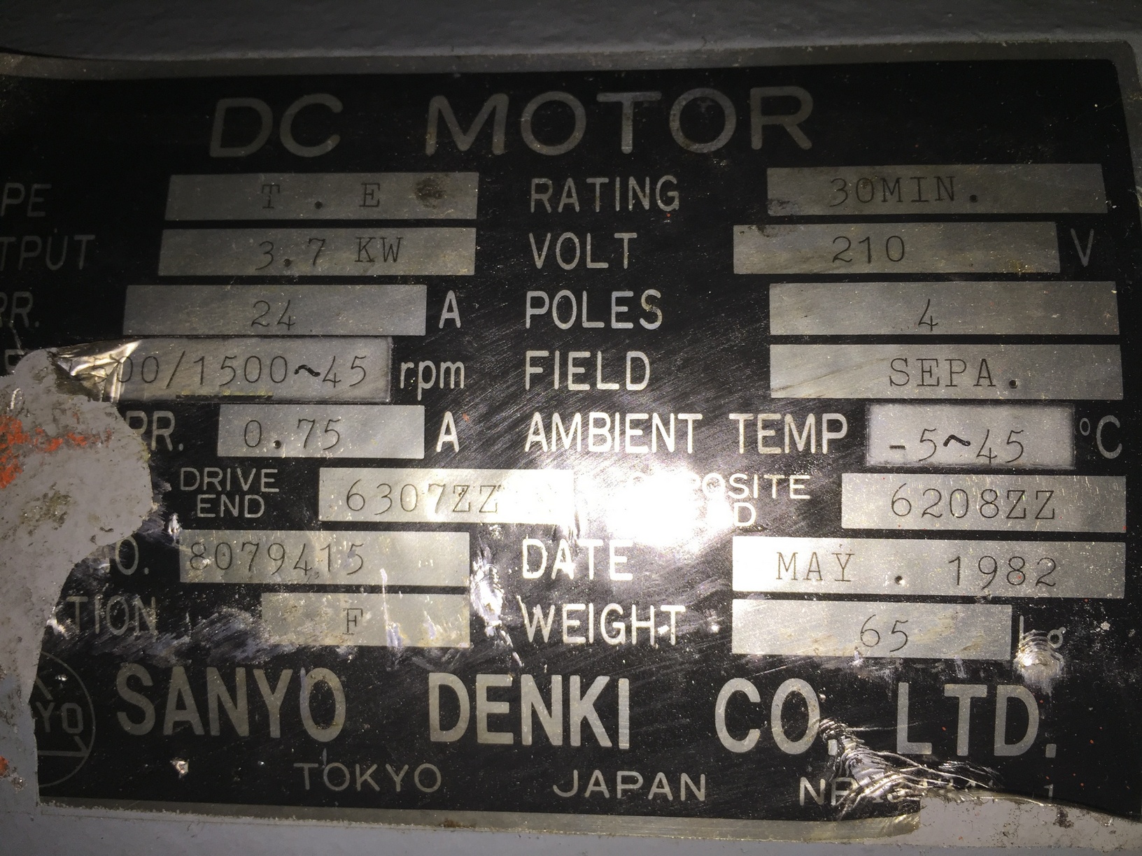

I've been a lurker for a while now, and I just purchased a Shizuoka Millmaster B3-V from the early 80s. I'm replacing the control electronics (Fanuc 6M) with Mesa hardware and LinuxCNC. I think I have a pretty good handle on everything except for the spindle drive. The motor (pics attached) is a Sanyo-Denki DC motor rated at 3.7KW 210VDC. I'm not sure if it's shunt wound or not, nor do I know how to test for it.
I didn't know it was a DC motor before getting the head apart, and the original plan was to use a VFD with what I thought was an AC motor. The mill will be running off single phase 240, and I've been looking around but I have not found much information in the way of DC motors and drives. I know there are SCR/thyristor drives, but I also know that's relatively old technology. Now to my questions. What drive should I use? I know I will want a 4Q drive and from my research I learned that at 240VAC input some drives (like the Parker drive linked below) only output 180VDC. Should I use a step up transformer before the drive to increase the output voltage? Is this the type of drive I should be seeking?
Thanks in advance for any help you can provide, and if I've left out any pertinent information let me know and I'll add it to the thread.

Have you considered keeping the existing motor drive? If it still works that is likely to be the easiest solution.
(Though if it needs 3-phase that might not work).

Yeah, I have, but it is 3ph. I think I've decided to sell the original motor and drive, and swap to a second hand AC spindle motor and VFD. It's not too much more expensive than finding a decent DC drive, let alone one that will output 210VDC instead of 180VDC.

Also interesting, I had ruled it out because the output current is lower than the motor's rated input current. Also it has a separately excited field, and I know next to nothing about that type of motor. I suppose I could look into that as well.
