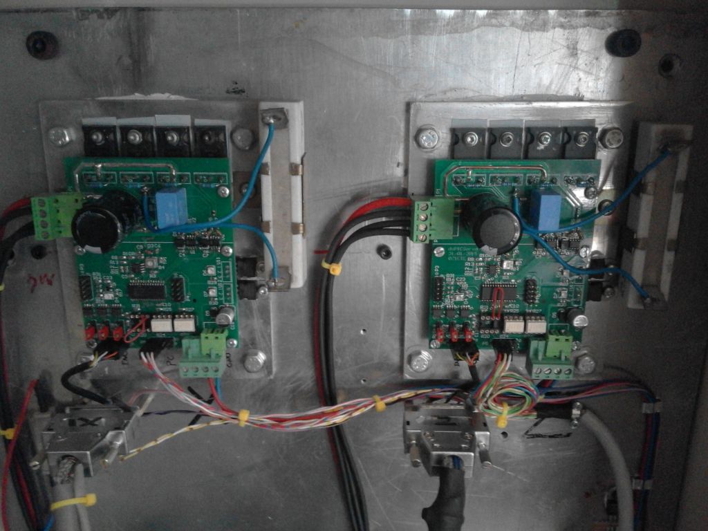

The interface to the original Fanuc drivers was 0-10V and the encoders were connected to the Fanuc controller. After spending a long time to repair the drivers and debugging the Fanuc/Mazak interface logic it tuned out that the controller also was defect. I then decided to replace everything and started with the servo drivers. The drivers are now based on the YAPSC project having STEP/DIR interface, and seems to work ok.
Rather than struggle with limited parallel port IO (and 5V signal levels) you might want to look at something like a Mesa 5i25 / 7i76 combo to add fast step generators and a lot more IO. It will make things easier. Or carry on using the parallel port and connect a Pico USC to the parallel port to achieve the same thing. (16 digital inputs and 8 SSR outputs)
