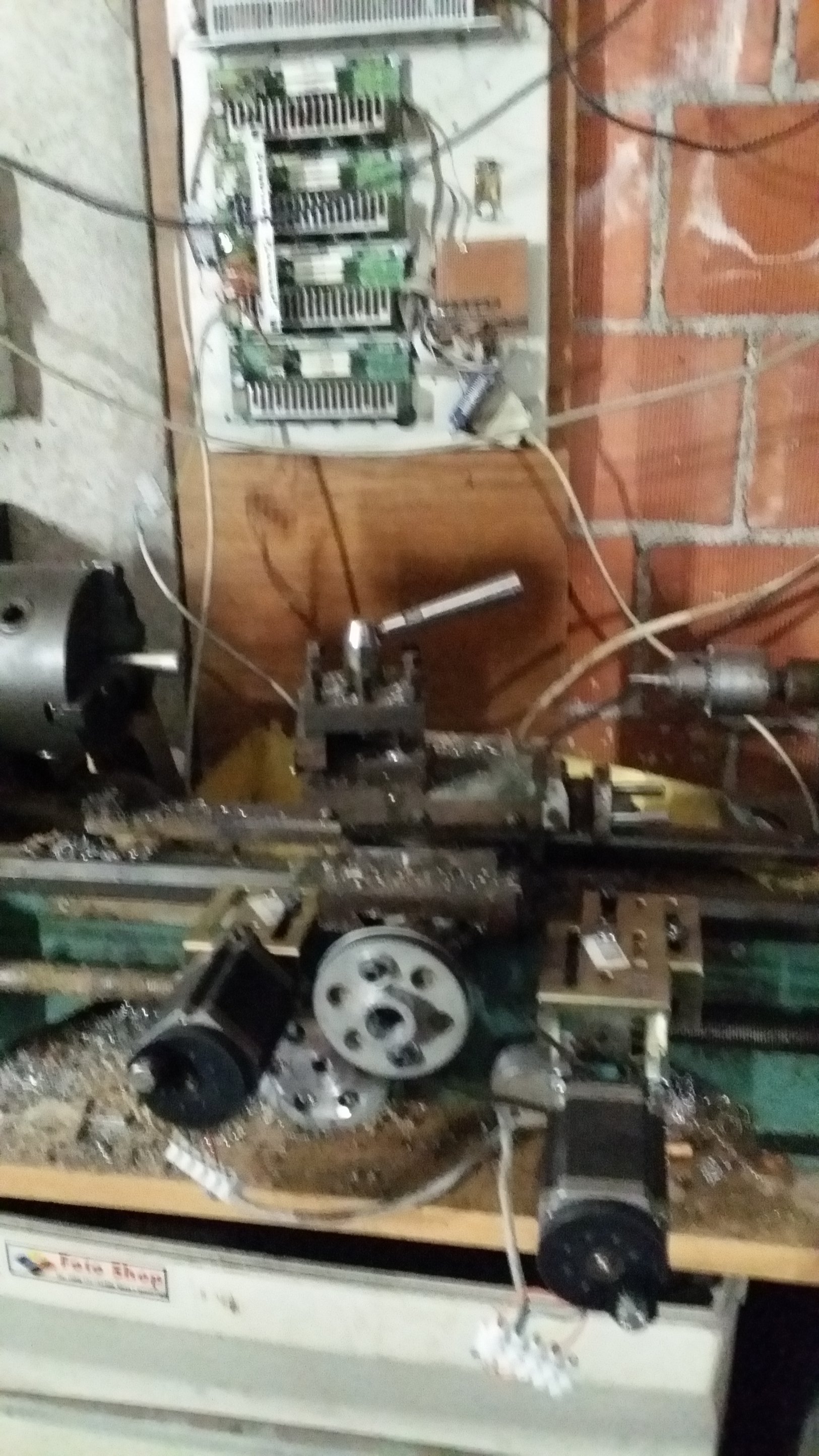

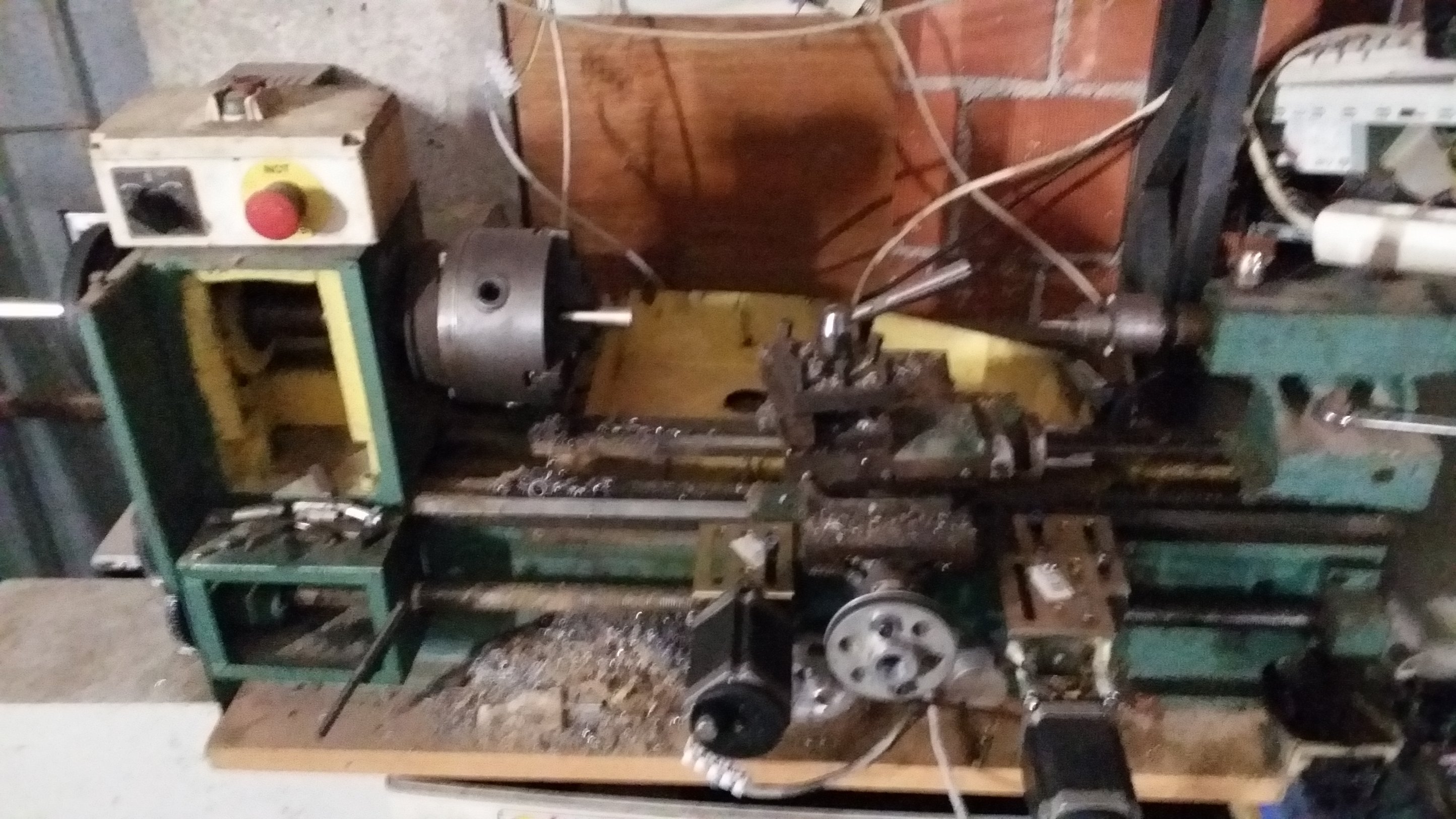

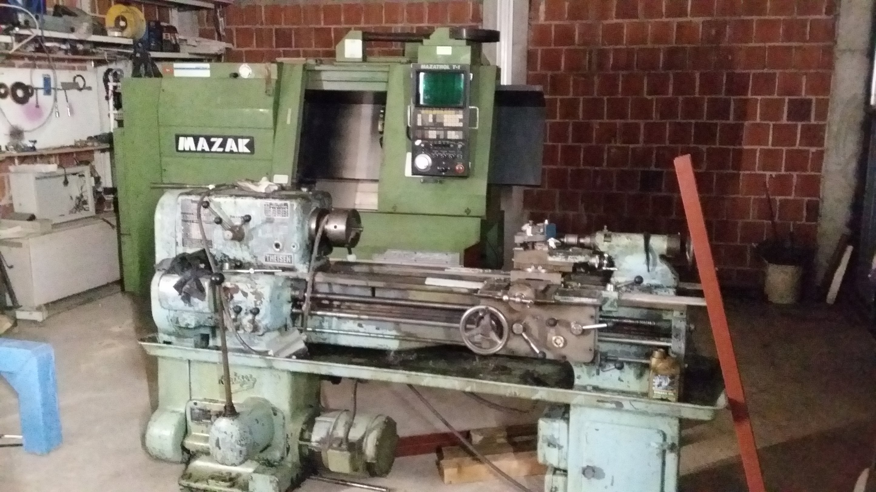

18 May 2017 23:06 - 18 May 2017 23:08 #93372
Replied by tommylight on topic Yaskawa Servopacks any good?
How much is that in US$?
On the manual it say "position or velocity control signal", nice.
That is one nice user manual, tons of info.
Lathe? What, where, how, why, when????? I have 3 already crammed into my shop, leme get some pictures...
Small one already cnc-ed, big one came with cnc, middle one will have to go out !
Damn those are some c@#$ pictures, battery is low so it will not turn on the flash. Sorry for that.

- Posts: 21995
- Thank you received: 7488
19 May 2017 01:00 #93374
I would skip it and do the big one, but you might need to do parts for it on the big one, sooooo........never mind.
The one you have looks nice and is about what i need normally.
So to recap, buy small one, cnc small one, make parts for big one, sell small one, cnc big one, make chips and watch grinning like a kid!
