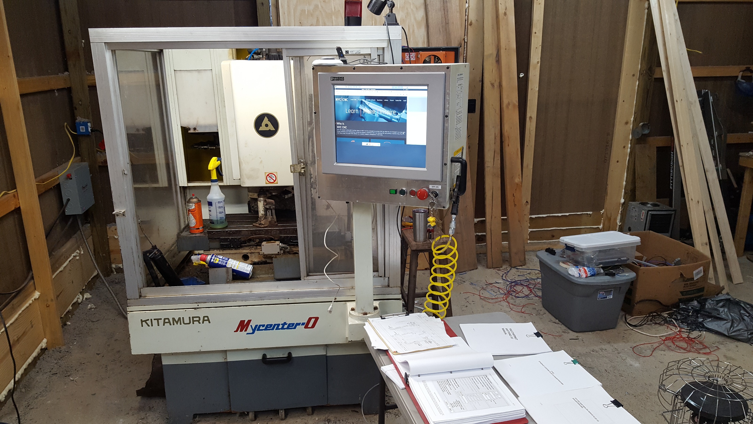

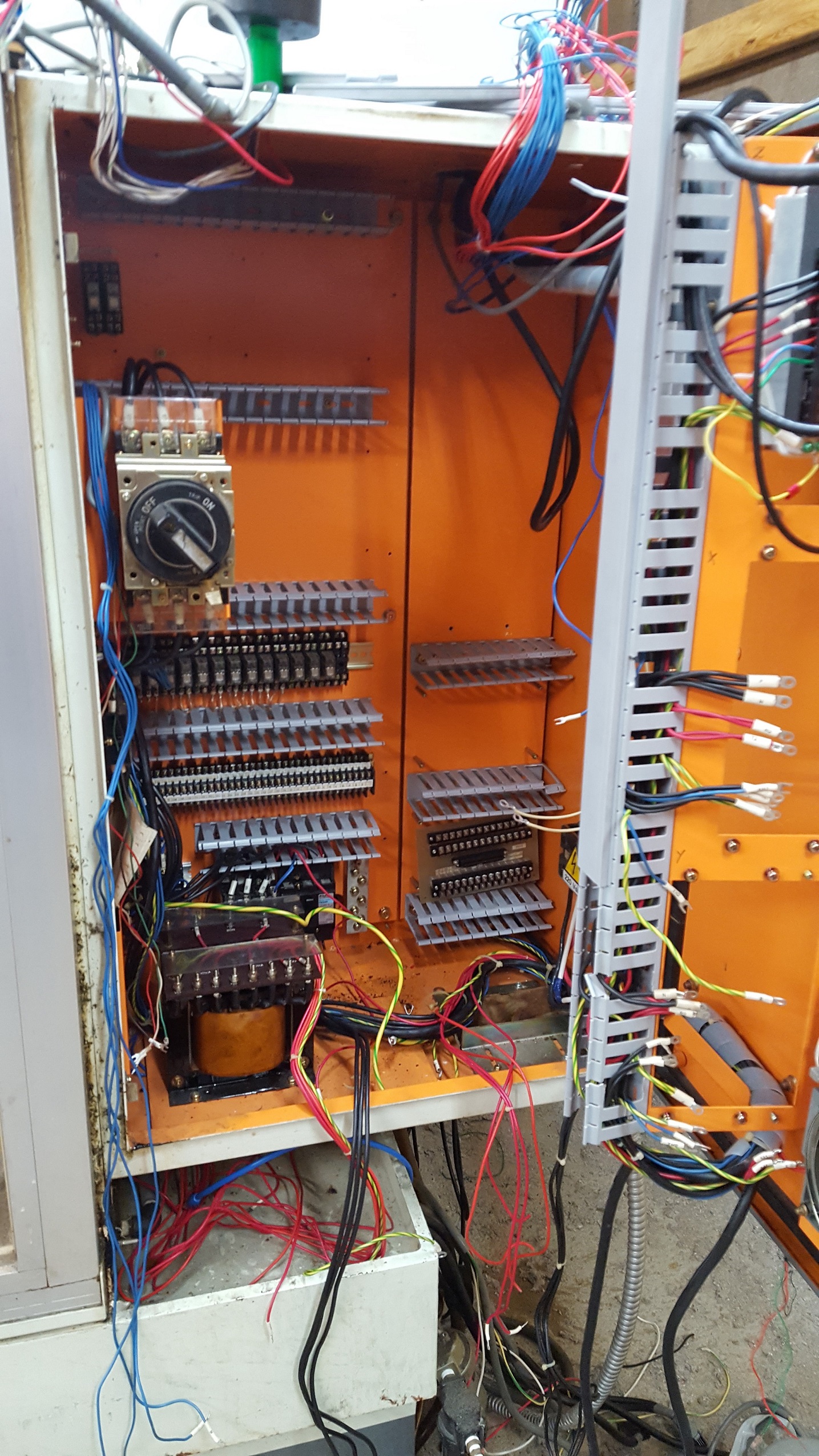

It is so nice starting from scratch and being able to bring the entire machine up to date.
Last edit: 25 Aug 2017 12:34 by Rescue35. Reason: Fix the picture showing the Electronics Cabinet empty

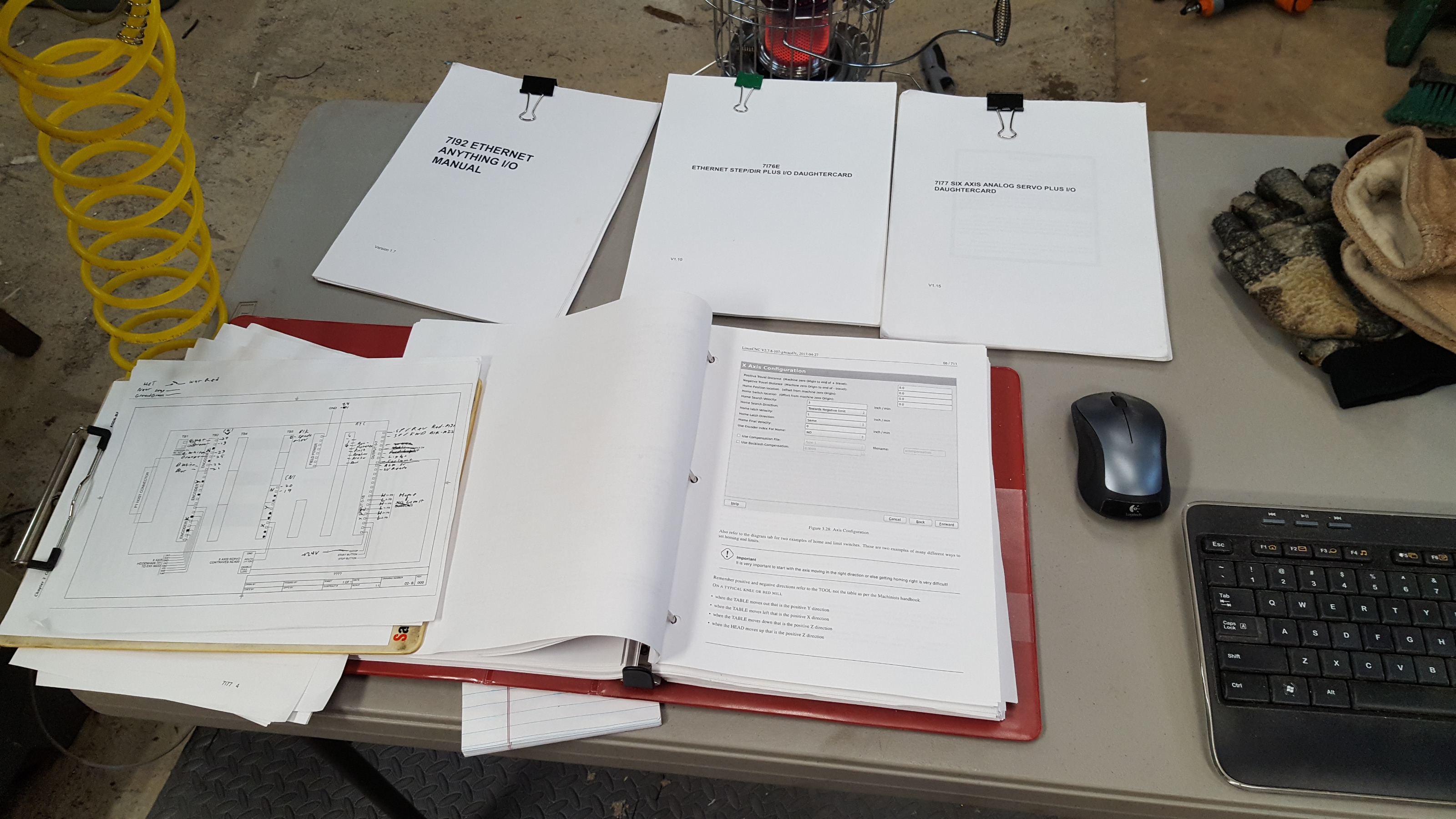

Its been a while so here is an update:
I have Installed everything need to operate a 3 axis mill. I have some parameters to adjust on the servo drives and I hope to test run them this weekend. I still have a lot of little things like connecting the contactor for the coolant pump and some general tidying up. Once it is running I will work on getting the tool changer sorted out. On the 1st I generated config files using PNCconf. I am taking a break from hand editing them to work with the 7I92 to post this update. Happy new year everyone. I've been posting some general updates on my site. olivent.org I have the original manual for the Kitamura posted in PDF format. I'll also post my configuration files there once completed.
I just got done adding the config files to google drive for access while Im on the road working.
Some of the paperwork necessary on my temporary workbench.
