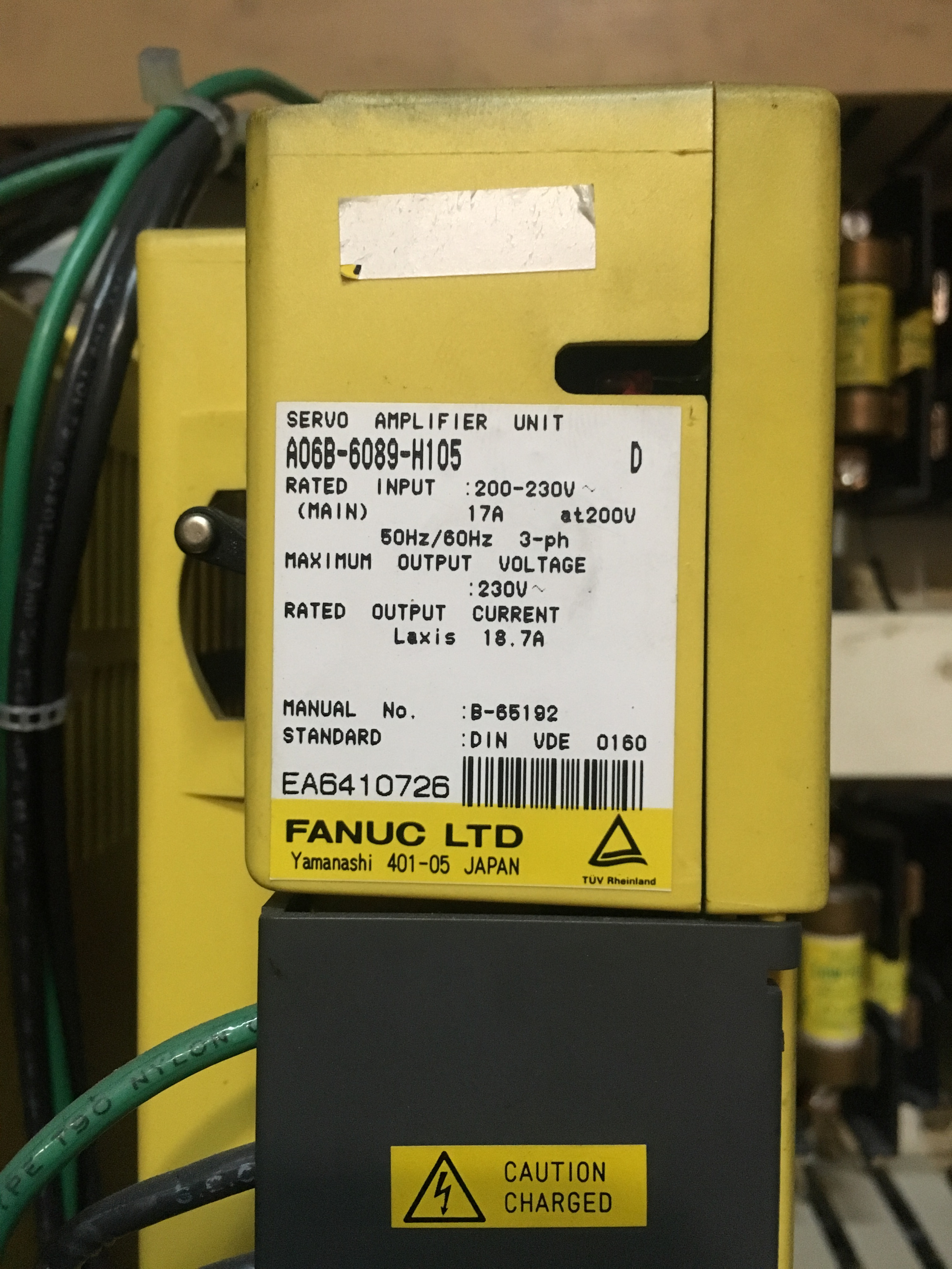

I gather from reading the manual for the servo amp that the control provides PWM outputs to the amp for all 3 phases.So this seems sort of like the control for a BLDC, but not.
SO...
If this is correct, I suppose the challange would be to create or buy *better option) some sort of card to convert analog to the 3 phase PWM and also read the encoders.
Maybe Jon has a card for the encoder reading over at PICO?
attached is the servo amp name plate
SO...

Replied by andypugh on topic Retrofit a Fanuc 15 controlled machine
The Mesa cards have a module that outputs 3-phase PWM. See 3ppwmgen:
linuxcnc.org/docs/2.7/html/man/man9/hostmot2.9.html#pwmgen

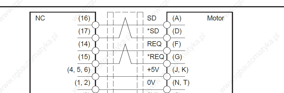

01 Aug 2017 15:22 #96841
by btvpimill
Replied by btvpimill on topic Retrofit a Fanuc 15 controlled machine
01 Aug 2017 17:01 #96845
Looks likeBipolar Request and Data, so a serial encoder matching the Hostmot2 function "fabs" (Fanuc Absolute)
github.com/LinuxCNC/linuxcnc/blob/master...hostmot2/pins.c#L273
