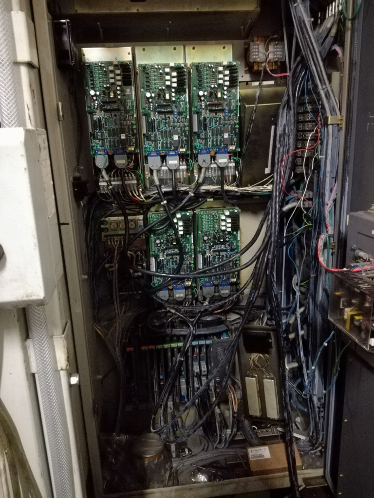

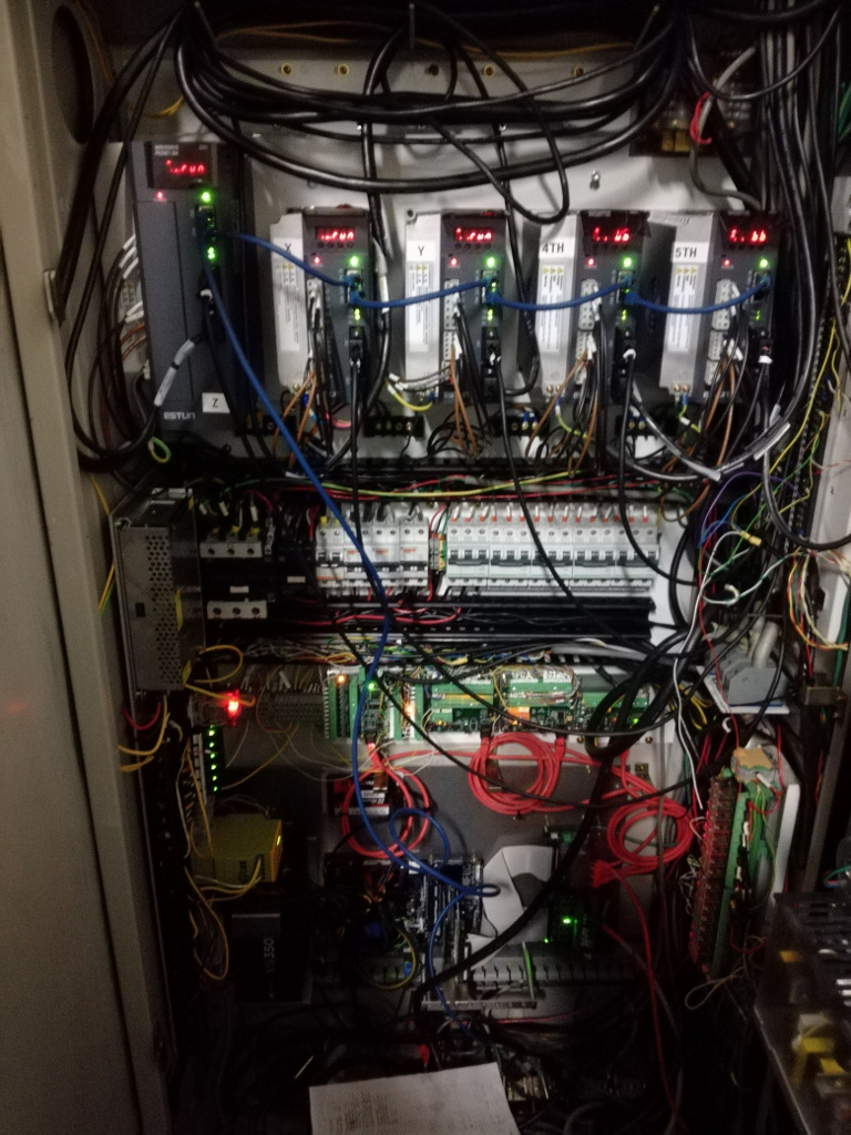

Started this a while back but never had the time to post it up here. so ill add some photos and info here, hopefully some intrest to someone
this is my 6th machine now retrofitted off big iron
the old Yaskawa I80 control decided to give up and not boot any more so i had to undergo a upgrade on this machine, as being a matsuura the machine its self is still in very grate condition on slides, and other areas too.
this machine already had a full 5axis ready rotary table with brakes on both rotary axis.
the B axis is +/-110deg while C is full rotation.
used a mesa 5i24 card with SSerial cards = 7I71,7i72,7I87,7I84
i changed the servos drive to new AC servos on all 5 axis

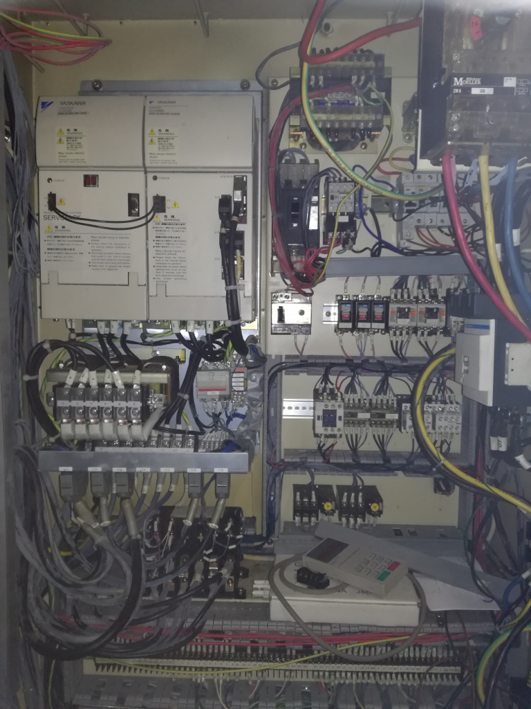

intergrated into the relay/IO wiring from the old hardware for interfacing, as did not see the need to rewire all the mass of IOs and wiring sheets had all the info needed to wire in.
Travel is
600mm in X
350mm in Y (limited by indexer on table due to Z colum)
550mm in the Z
rapids are 15m/min in XYZ

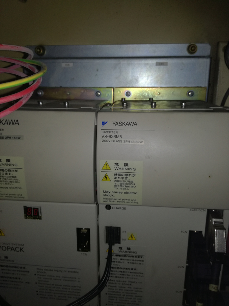

machine has a Yaskawa M5 18kw spindle drive with full regen unit spindle motor is double wind type of 7.5kw 8000rpm,
144Nm in low torque range, 44Nm in high speed
spindle cartridge & spindle motor is cooled by a oil chiller on the back of the machine.
tool chagner is random arm type, with 20 tool mag (21 if you count spindle as pocket)
50Bar coolant pump, with through spindle coolant fitted

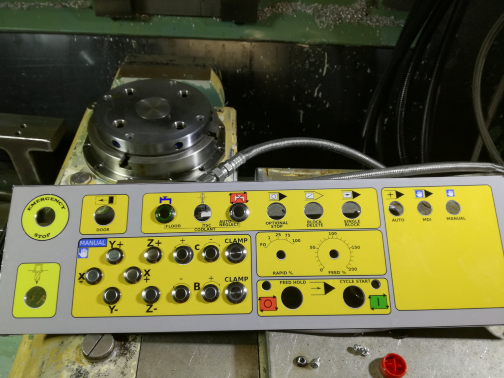

still have a few things to finish off like the interface pannel, finishing hooking up afew I/Os , add the renishaw tool setter & probe
the old Axis drives, these had a odd comm line and worked in toque mode so it was alot easyer to change them to newer drives & motors
quick vidio of the changer working
quick video i did off some quick test parts to check function and prove machine on.

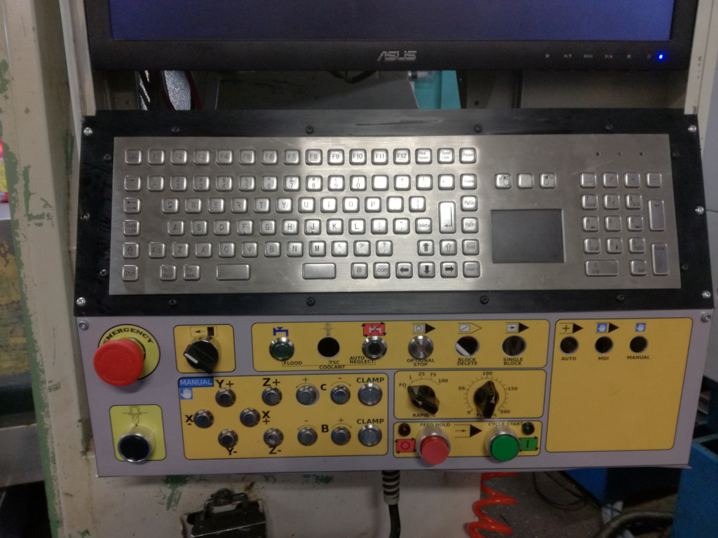

By the way, that keyboard looks great, can you tell us where to get one?
26 Nov 2018 13:12 #121363
Try searching eBay for "Kiosk Keyboard". Here is an example www.ebay.co.uk/itm/123484451458
Replied by andypugh on topic Matsuura 600vf retrofit

hi
got them from a company in china , i got the full length you see there, and also a half size one with no pad in it, with a seperate pad i used on some other machines.
not had any issues with them my self qulaity wise grate.. you can find them on ebay they are not cheap though keep that in mind..
Replied by robh on topic Matsuura 600vf retrofit
hi
