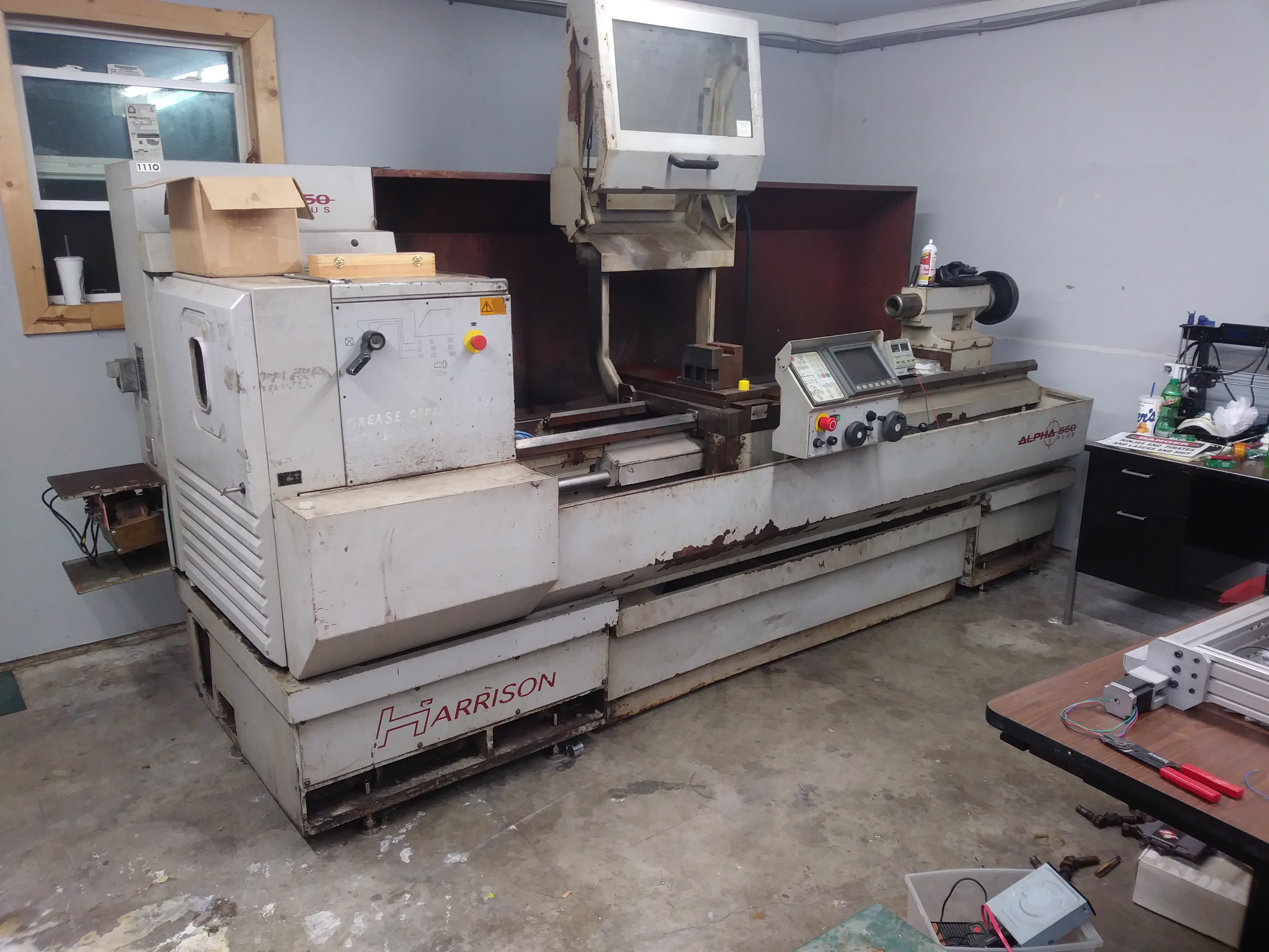

Well after I finished up my MC-500v2 retrofit I decided I needed another project
I have been searching for a lathe for about a year and just happen to come across this one at a very good price. Everything works on it, besides the controller has an issue. This means I must remove all bad control boards and put a Mesa LCNC setup in it. I will not be getting to this one for a couple months yet, but wanted to get the thread started.

Replied by andypugh on topic Harrison Alpha 550 Plus Retro
I like those, quite an imaginative design, and part of the inspiration for me putting a pair of MPGs on my own saddle.

Replied by chopper79 on topic Harrison Alpha 550 Plus Retro
I agree.... I have always liked the idea of a manual/cnc hybrid machine. I seen your machine a few months back when you posted a link. I have to say that is what really sold me on the idea of finding a lathe that was similar in setup.

Replied by RotarySMP on topic Harrison Alpha 550 Plus Retro
Nice score. If that is original paint, it looks like it hasn't worked very hard. How worn is the bed?
It is original paint. The ways are in good shape besides a couple small dings up by the chuck area. Nothing that will harm the functionality of the machine though. I see those couple small dings as oil catchers.
The machine needs a good clean down for sure, but all in all I agree it is a nice score for $800.00

For $800 that is not really a nice score, it is more of a "you suck"
<jealousy> Now we get to the bit where you mention that the seller called you up a week later to say he found the box with the 18 new multifix holders and the unused Röhm four jaw chuck, and you should pick them up </jealousy>
I wish he called and said that he found those. The chuck, holders, and rests will cost as much as I paid for the whole lathe. Either way I still came out on top I do believe. We will see when I get into ripping it apart, worst case is I make my money back on parting the lathe out.

For Multifix clones, take a look at Create Tool.
www.createtool.com/list.asp?cid=33
I found them easy to deal with (swift email responses from "Nina") and the quality is fine. Not _quite_ as good as the Swiss, but then significantly much cheaperer too.
They don't list them on the web page, but they can also supply blank holders (splines only, and with height adjuster and clamp screws)
