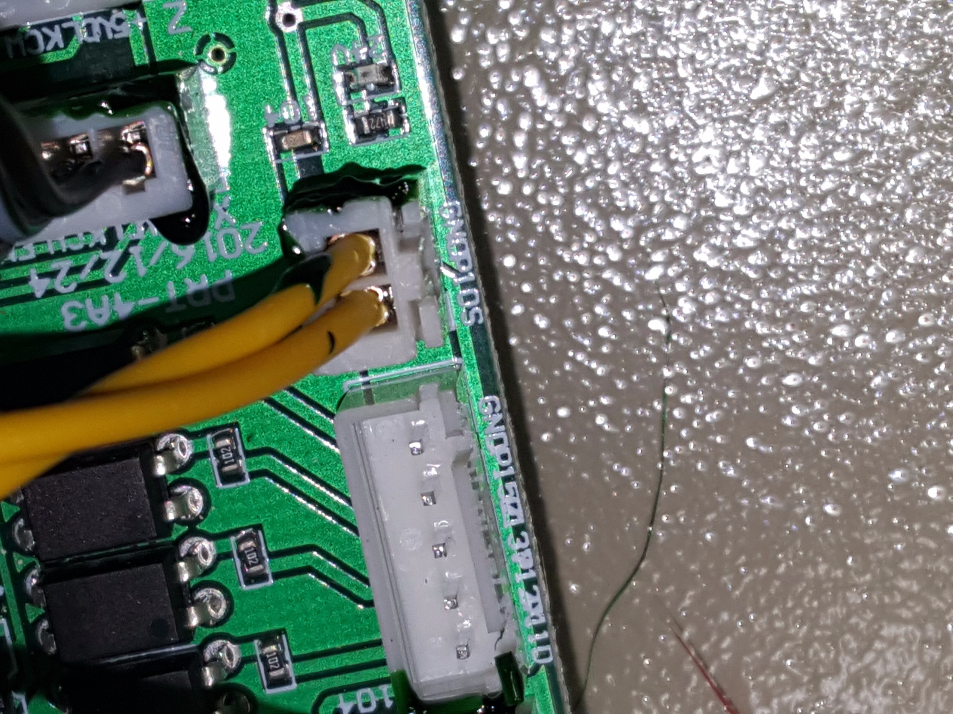

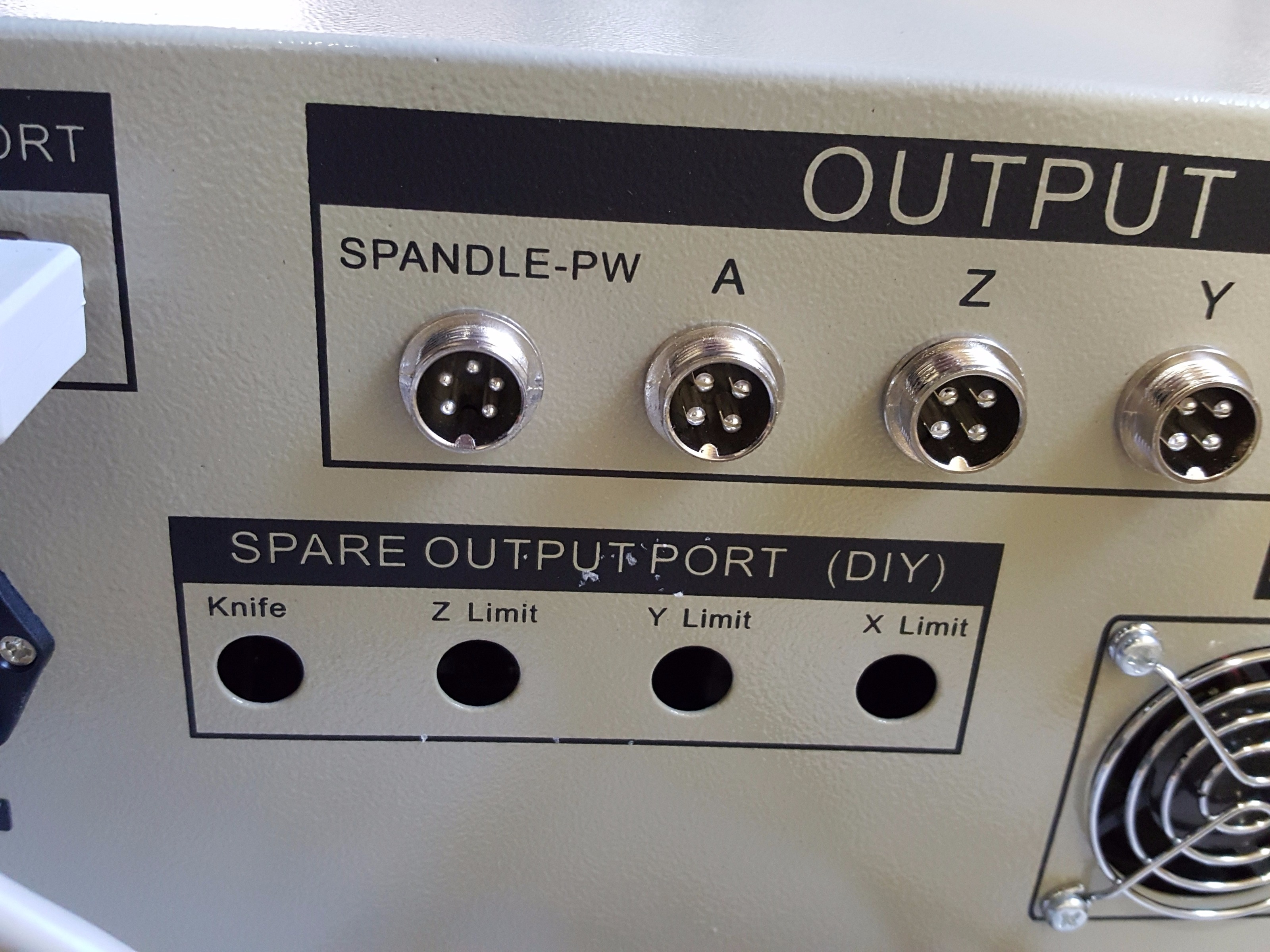

I've built a number of machines and decided the cheapest way to get all the parts (my time is not free) for a dedicated engraving platform was to buy a Chinese 6040 4 axis system. It works well and I have it all working with LinuxCNC. My only issue is that I didn't get the one with the limit switches and now I kinda regret that. But I should be able to add them easy enough.
The breakout board has a header for them and the back on the control box has the cutouts. I have no idea what type of connector it uses though, any idea?

Looks like Molex KK on the board, and "CB radio" connectors on the front.
www.ebay.co.uk/itm/2-12-Pin-2-54mm-KF251...JZl7LHKaX6Zc397JKksg
Contacts are separate. And you need a special crimping tool, so:
www.ebay.co.uk/itm/20cm-KF2510-Pre-Crimp...g-QCNr3a6jO-zS_ein6w
Is probably part of the answer.
