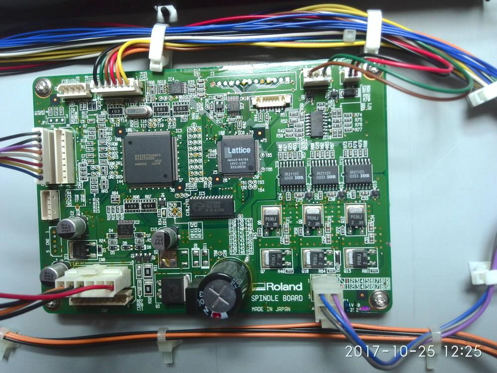

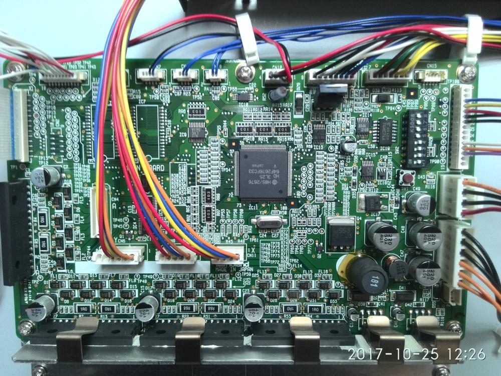

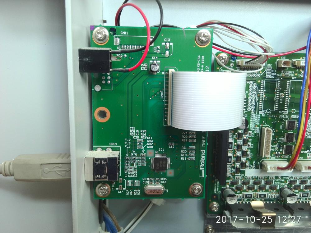

I had also made the following photos of the main board for the 3 axix steppers and the spindle.
I'm guessing that the USB might be just a USB to parallel port adapter, connected by the white flat cable.
If this is true we could make the configuration much easier.

It looks like it might be USB-to-parallel but if it is I doubt that the data format is simple step/dir pulses.
I rather imagine that it is sending data (like the Pico and Mesa EPP cards do)
Do you have access to an oscilloscope or logic analyser to test this?
I suspect that it will be easier to swap the Roland driver board for one of the cheap 3-axis driver boards from eBay or similar.

Hola Andy!
Thanks for your fast answer.
I have with me a 4ch Rigol DS1074 100mhz scope and i could get also a 10ch. logic analyser.
I have also consider the idea of use some cheap 3axis boards + Baglebone-pru, but i thought could be also a good possibility to use the system its already there and maybe just produce in the lab the USB interface, luckilly I´m not in a hurry for this and I could document the process so other could benefit from this (?)
So any ideas are very wellcome!
