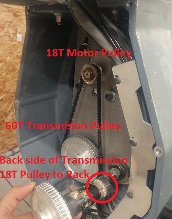

Now my x y and z motor have movement (well they bind) but there is connection so now I'm struggling on tuning in the right specs..
my motors have a 18tooth pulley which drives the transmission/Barrel with a 60t pulley and on the opposite end there is a 24t gear that goes the the rack (I think its 7tpi but I am struggling figuring out how to precisely measure this)
So would these settings be correct under Step Motor Scale?
Pulley Teeth 18:60

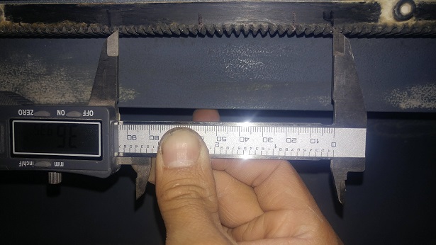

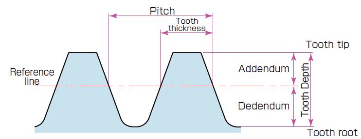

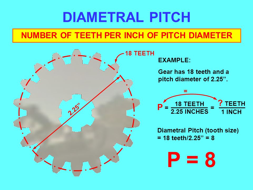

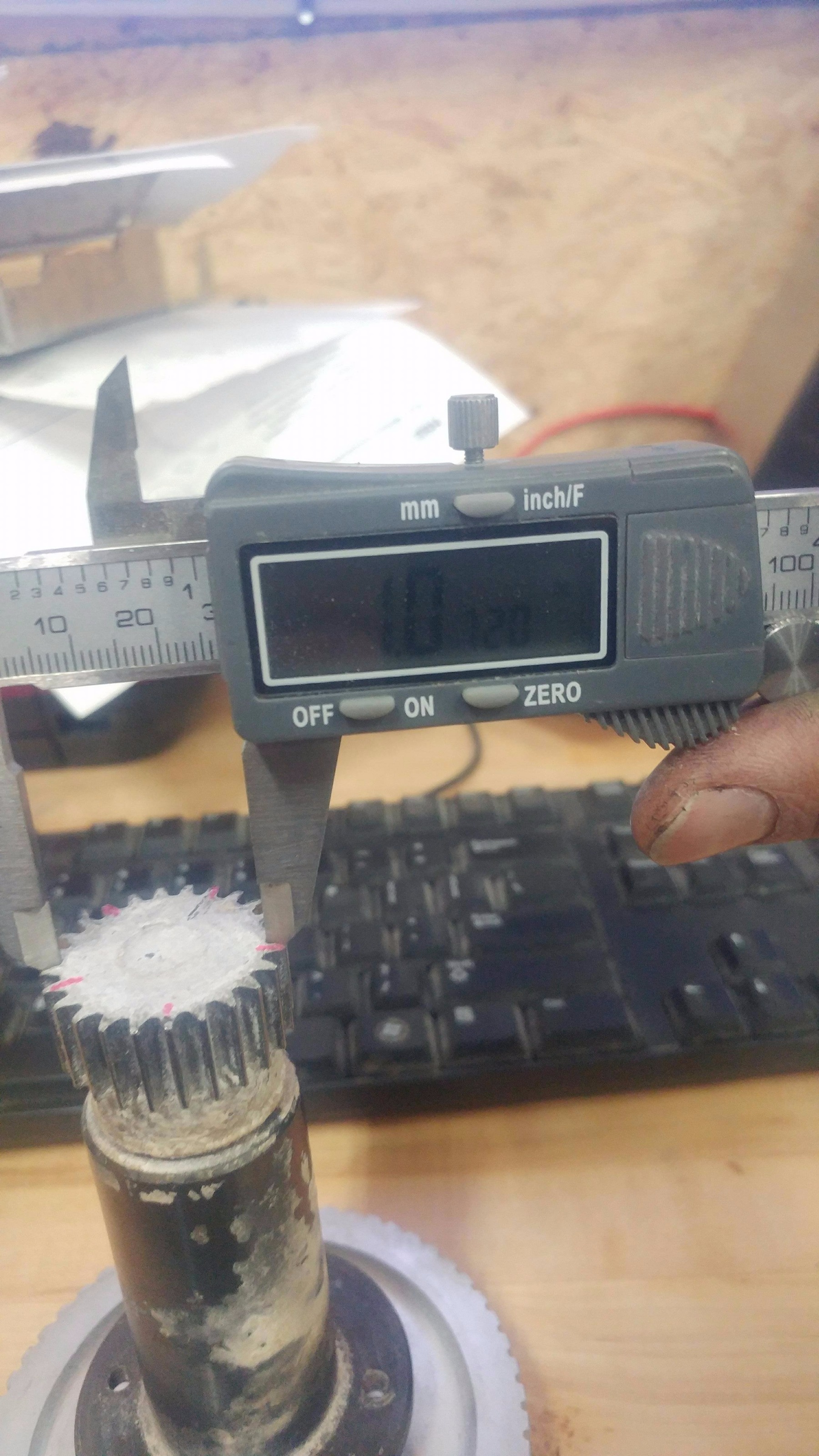

To measure the diametrical pitch I found this image:
Now to find the true diametrical pitch I would have to measure at the angle of the tooth (which I cannot see) So what would be my allowed tolerance?

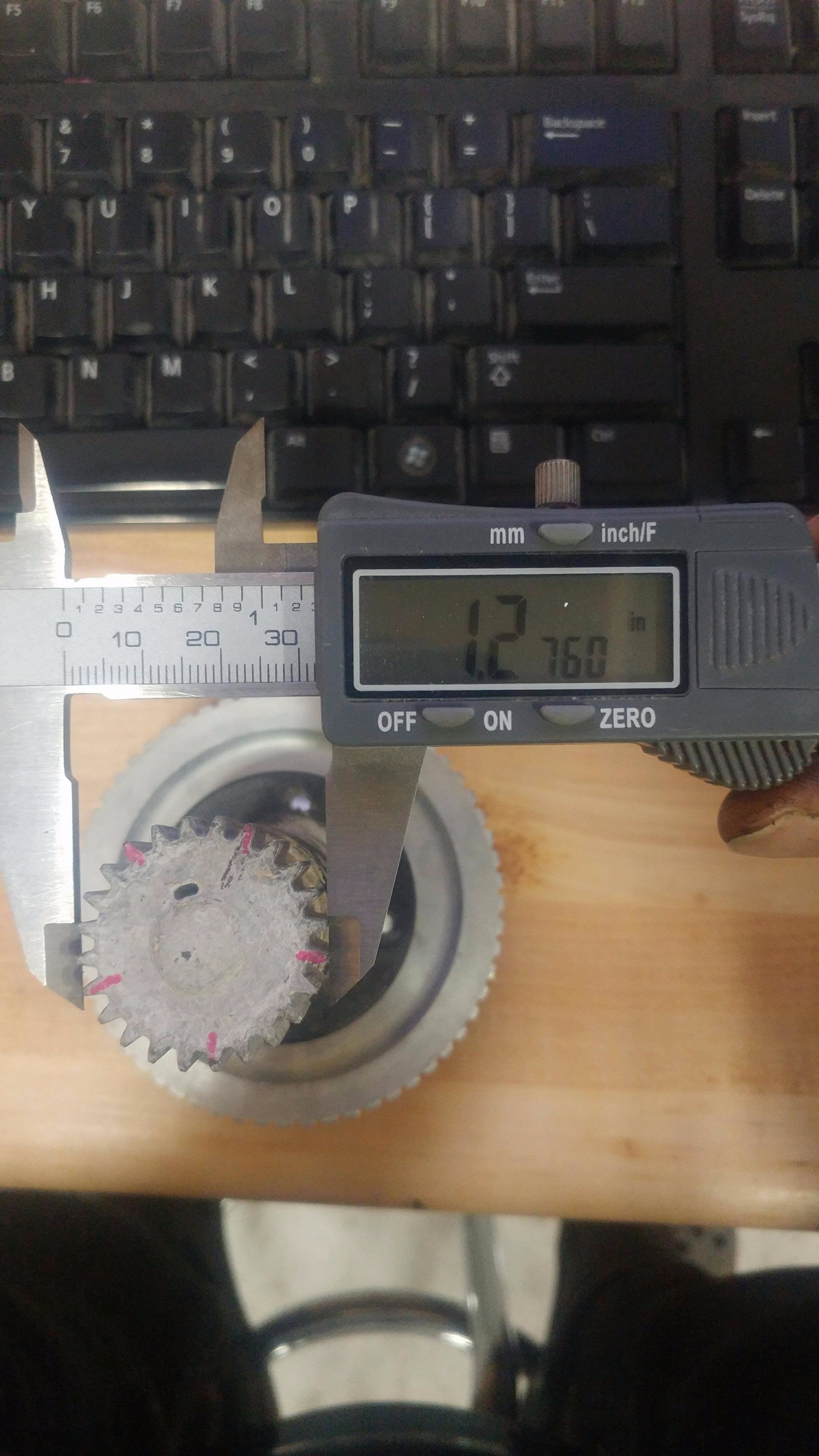

I measured the diameter (outside of the teeth) and got 1.2760"
Then I measured the diameter of the base circle? and got 1.0120"
Could this be assumed the diametrical pitch is 1.2 as you suggested? Again, what would the tolerance be for this? Is 1.2 enough or should it be as accurate as 1.2x/1.2xx?
"Assuming your 24t pinion gear is a 20dp (and this might be a big assumption), it would have a 1.2" pitch diameter"
What does "20dp" refer to in this statement?

It seems kind of close. Looking up the specs for 20dp 24tooth gear shows an outside diameter of 1.3". If you turned the pinion so the caliper measured from tooth to tooth instead of bridging between two pairs of teeth, it may be very close to that.
Another test would be to measure the length of 24 teeth on your rack, then divide that number by pi and see how close that comes to 1.2.

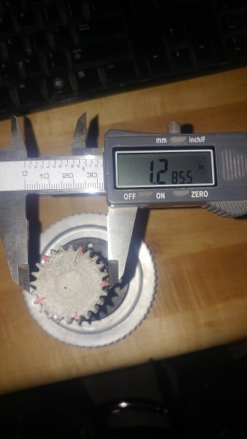

So if I measured correctly, (which is quiet difficult to guess where the exact reference line is) I yield 3.6935/pi =1.1756
I re-measured the pinion making sure it was from the tip of the tooth-to-tooth. I'm reading 1.2855, is it safe to say I can round this to 1.3?

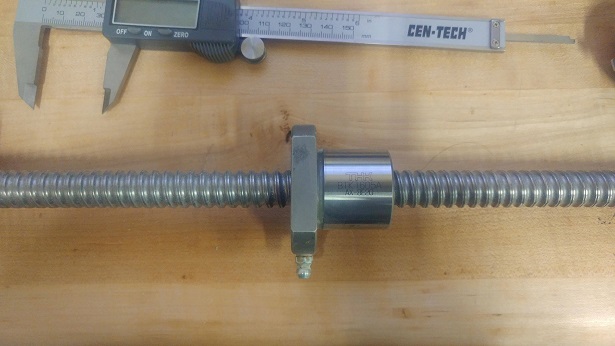

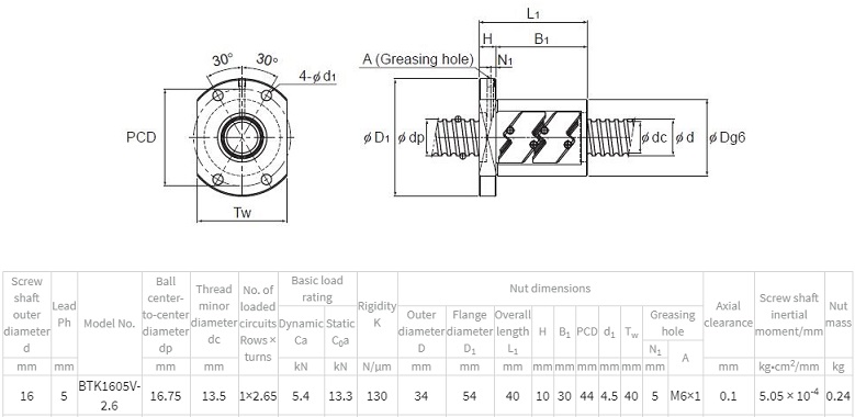

Also how would I figure out the lead screw pitch?
I am using a THK BTK 1605A AX-8E20
Is "Lead ph" Lead pitch? (What does the ph stand for?) If so, it states 5mm so is that 5:1mm?
Thanks again for your help, this is pretty confusing as there are so many abbreviations and terminology that I'm struggling with.

1605 is a common ballscrew size, (16mm screw with a 5mm pitch) The nut will move 5mm with one turn, so if you are setting your machine up in inches you would enter 5.08 revs/inch. (25.4mm/inch / 5mm) If you are setting up the machine in mm then just enter 5. (Stepconfig uses a different calculation for inches and mm, inches uses turns/inch and mm uses mm/turn, just to keep things nice and confusing.)
The measurement of 1.28...inches might be close enough to 1.3 to count especially if the pinion is a bit worn. 20DP seems to be the closest standard gear size for a 24tooth gear with about that OD.

Check your results on the pinion on this calculator.
www.gearconcern.com.au/gear-size-calculator/
EDIT: It looks like your rack and pinion is a metric Module 1.25 gear set from the above. So the circumference is 24 * 1.25mm * pi
= 94.2477796076938 mm
= 3.71054250423991 inches (divide x 25.4)

So following along, at 1100 steps per rev (200 * 5)
and 18:60 reduction drive.(3.333333 : 1) lets see,
To turn the pinion 1 revolution, you need 3333.333333 steps (1000 x 3.33333)
So to determine your steps per inch its
3333.33333 / 3.71054250423991
= 898.341225358
This is the value you need to use for the
SCALE or STEP_SCALE in your ini file (edit same by hand)

module 1.25 is a very common gear size in the metric world (97% of the world's population). 94mm is remarkably familiar to me as I've used a mod 1.25 rack on my machine.
The calculator on my supplier's site is good. I think it gave me module 1.256 and DP of 20.226 so its clearly metric. The pinion looked worn to me. I'd run with mod 1.25 for now. You know its a metric machine by the 1605 ball screw used.
I know I did a fair few tests with a 1.0m steel long ruler fine tuning one axis and the other was spot on perfect. If it was out by 0.1%, I'd change the scale by 0.1%
